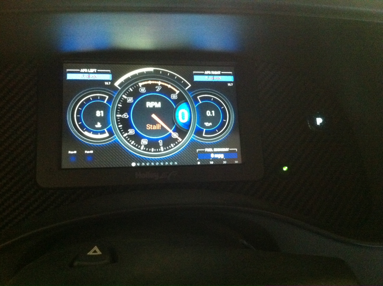

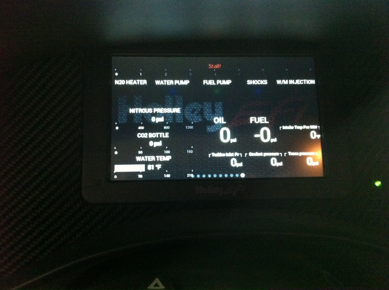

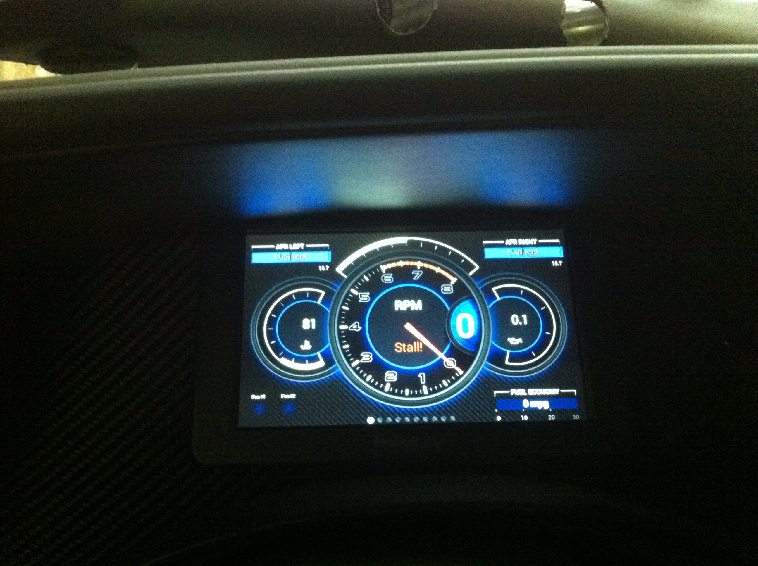

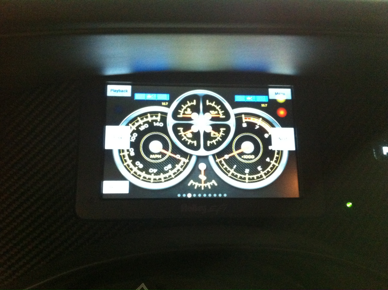

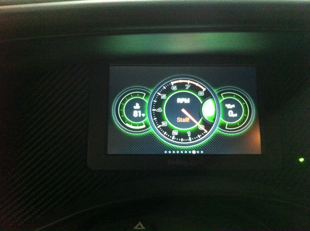

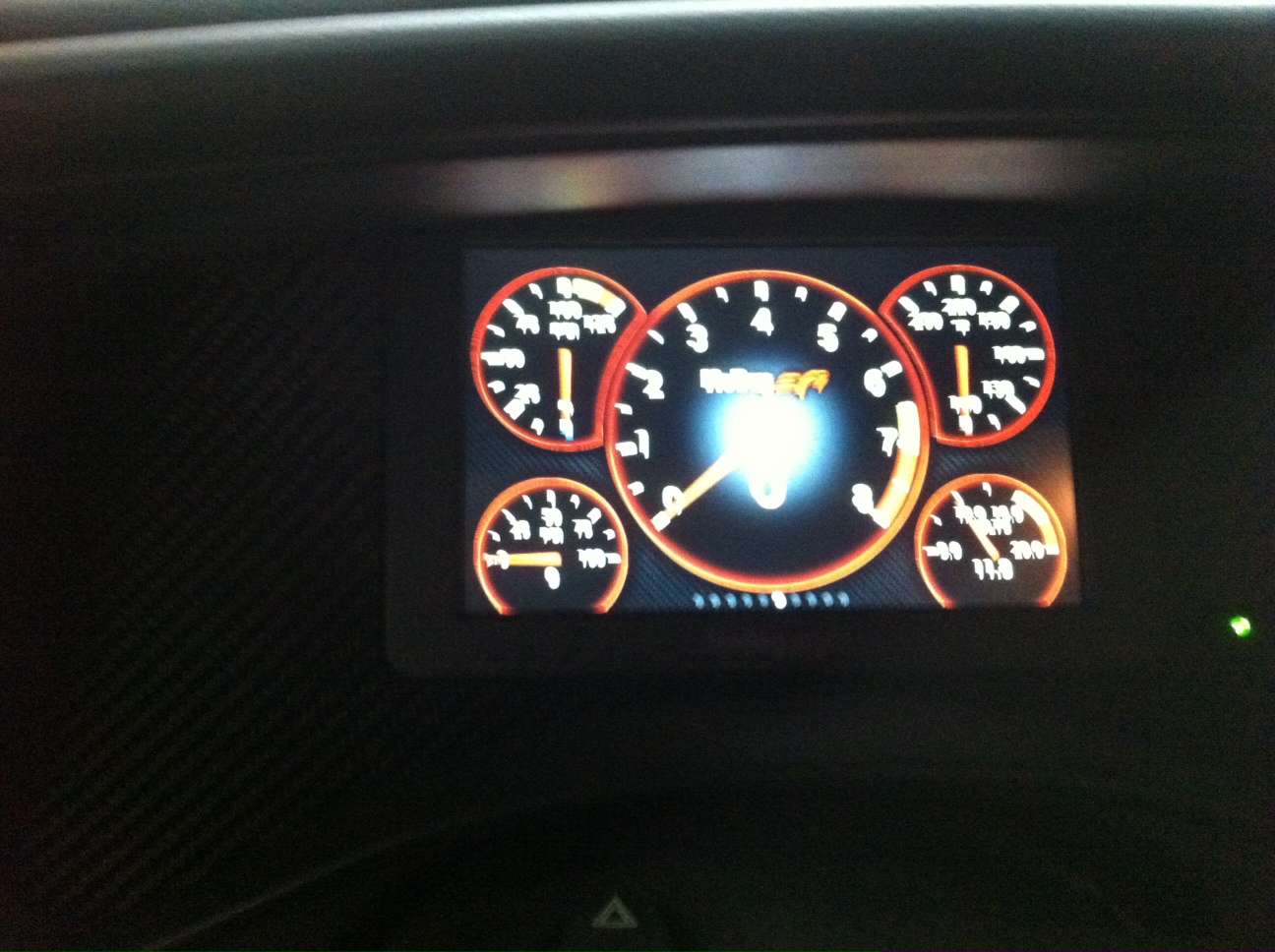

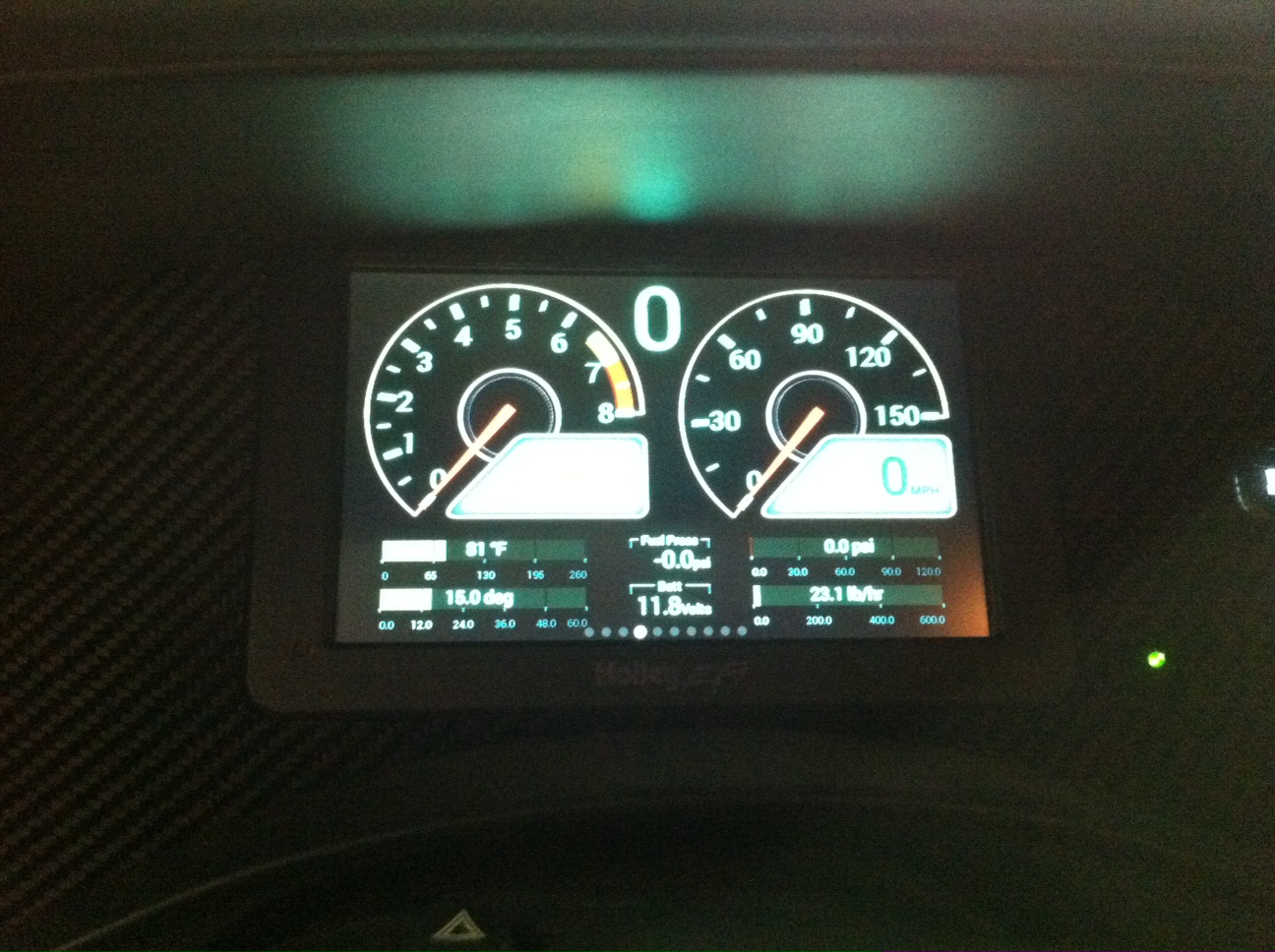

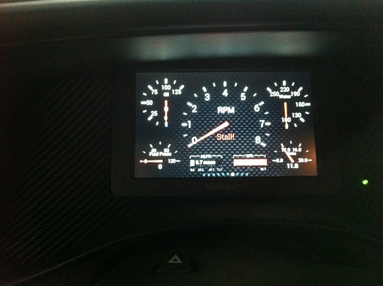

Few shots of the Holley Digital Dash. Haven't set anything up yet.
Attached Thumbnails Holley Dominator Install-dd1.jpg   Holley Dominator Install-dd2.jpg   Holley Dominator Install-dd3.jpg   Holley Dominator Install-dd4.jpg   Holley Dominator Install-dd5.jpg
Holley Dominator Install-dd6.jpg   Holley Dominator Install-dd7.jpg   Holley Dominator Install-dd8.jpg   Holley Dominator Install-dd9.jpg

Wow, that's killer! I like how you can change your gauge setup!

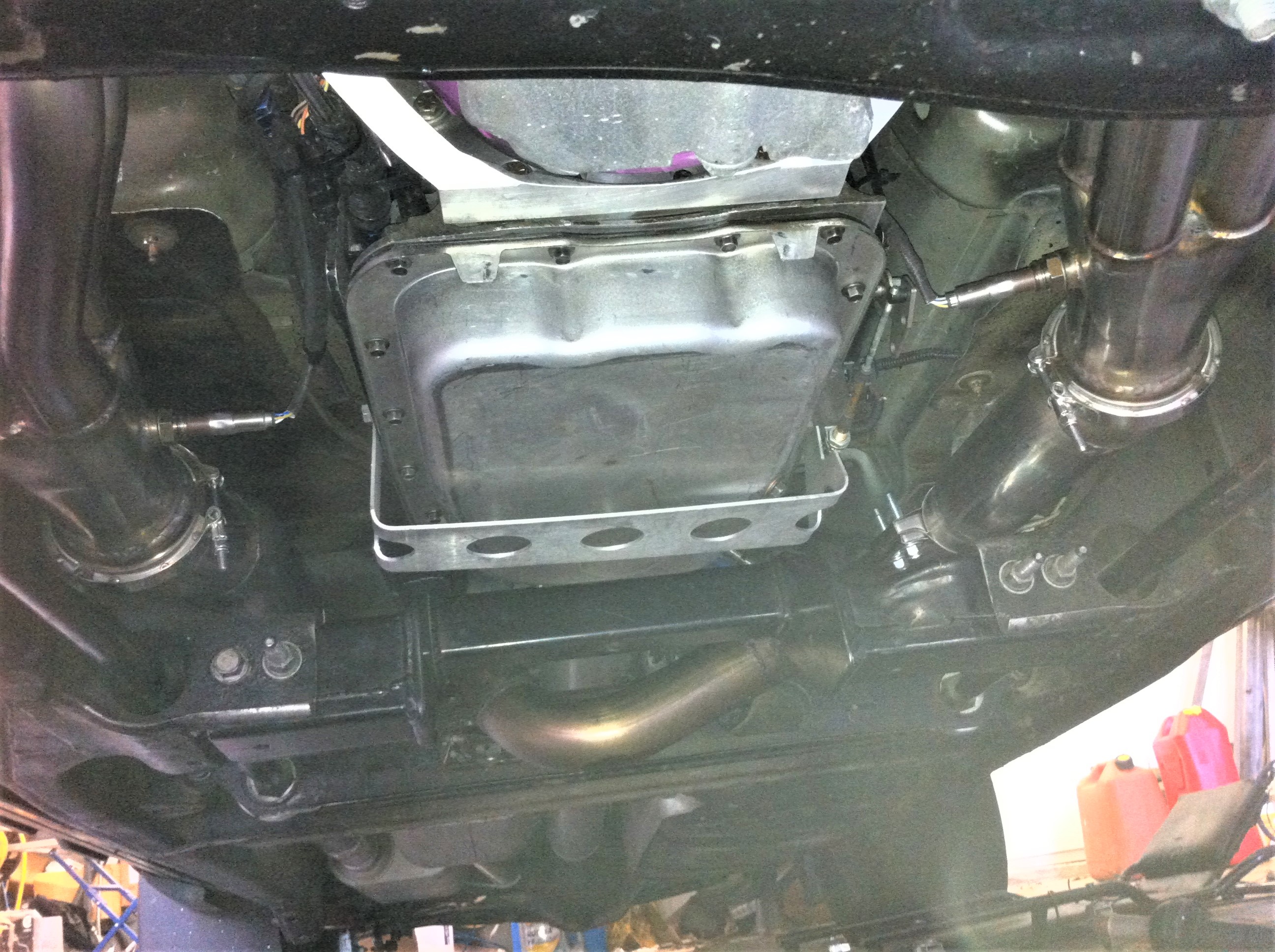

Mated up Texas Speed 2" F-body headers to my dual 3" street exhaust. These headers do not work with a 4X4 frame unless you don't mind cutting a big hole in the passenger side frame rail. Not sure they would clear the diff bracket either if it was still there. Hopefully there is enough clearance between my v-band and the pass side torsion bar.
No issues on the driver's side, but had to unbolt and swing the steering shaft out of the way to get it in there. Good clearance once bolted up though. Not many miles on this intermediate steering shaft, but it doesn't want to slide anymore.... like the plastic internal splines have swelled. Ordered another one.
Needed a couple of slight bends in each mid pipe to straighten things out.
