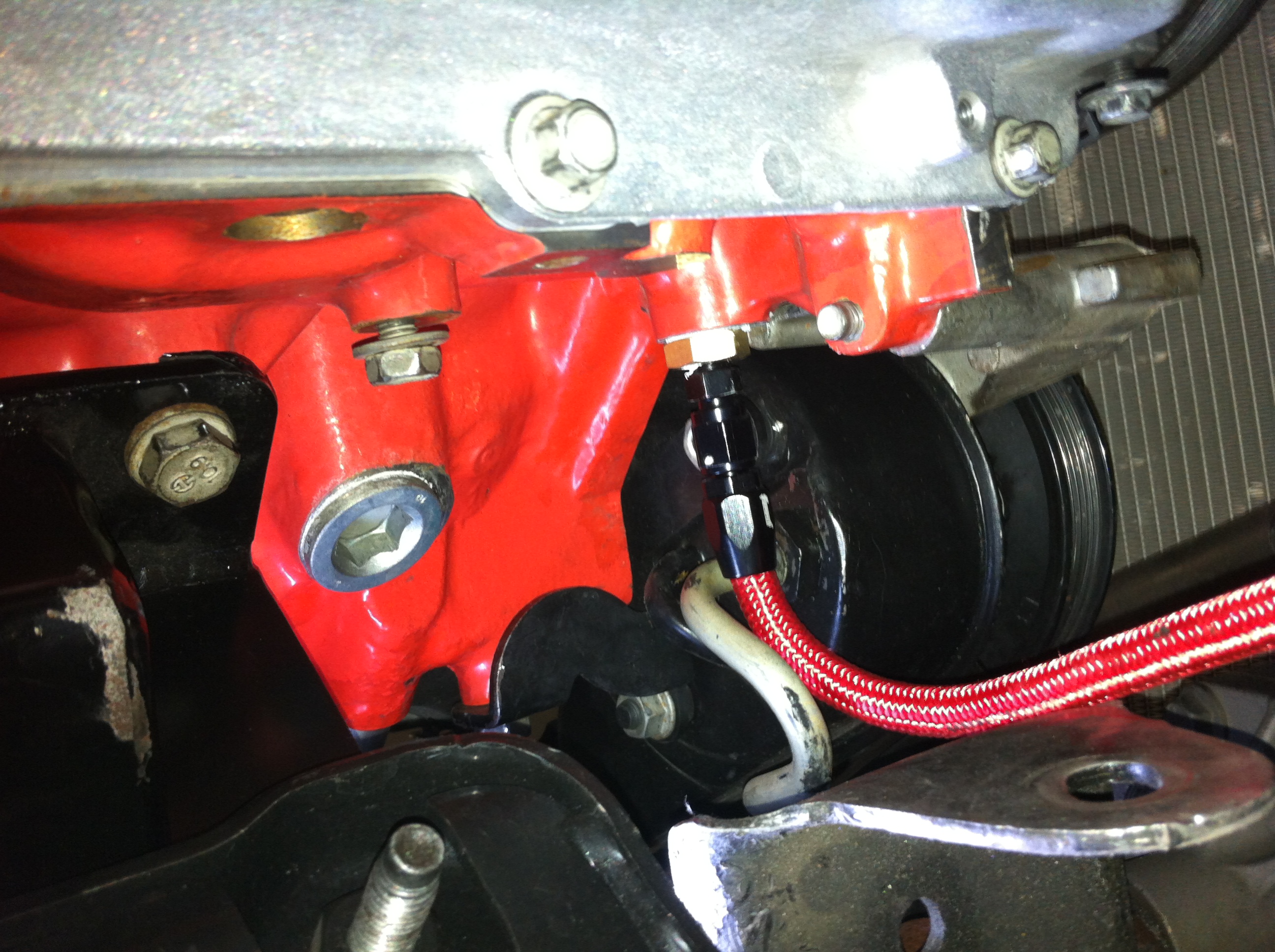

Originally Posted by DrX
Motor bolted in with the solid mounts.
How did the old mounts look like?
Don't see any twisting or rivets pulling out on this set. Thought they looked good until I peeled back the heat shielding...rubber was a little toasted. Maybe 1000 miles on these. These were Genuine GM made in China mounts.

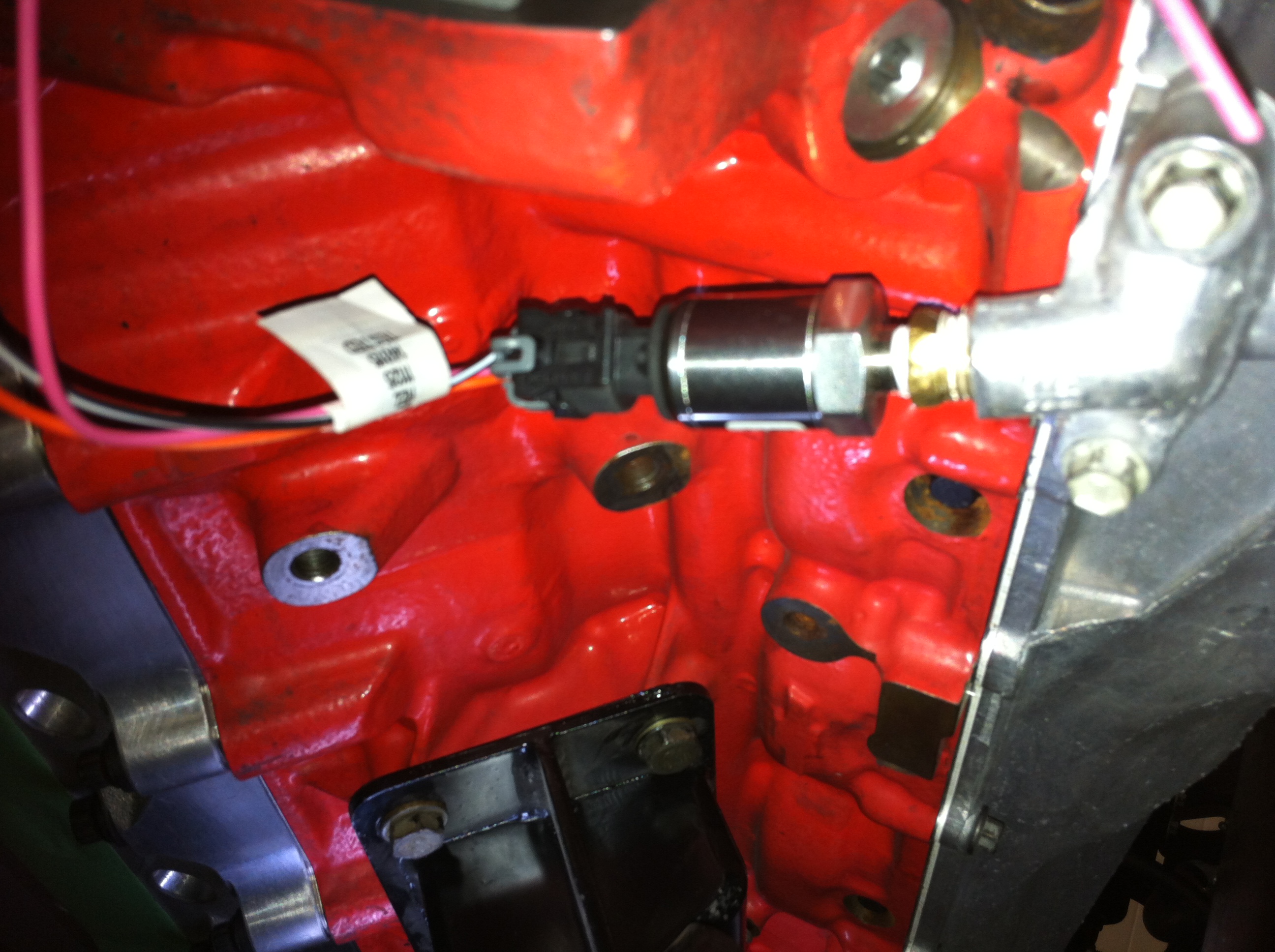

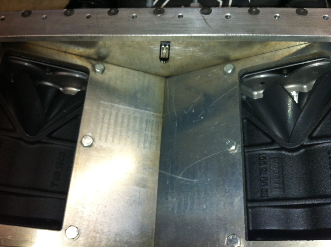

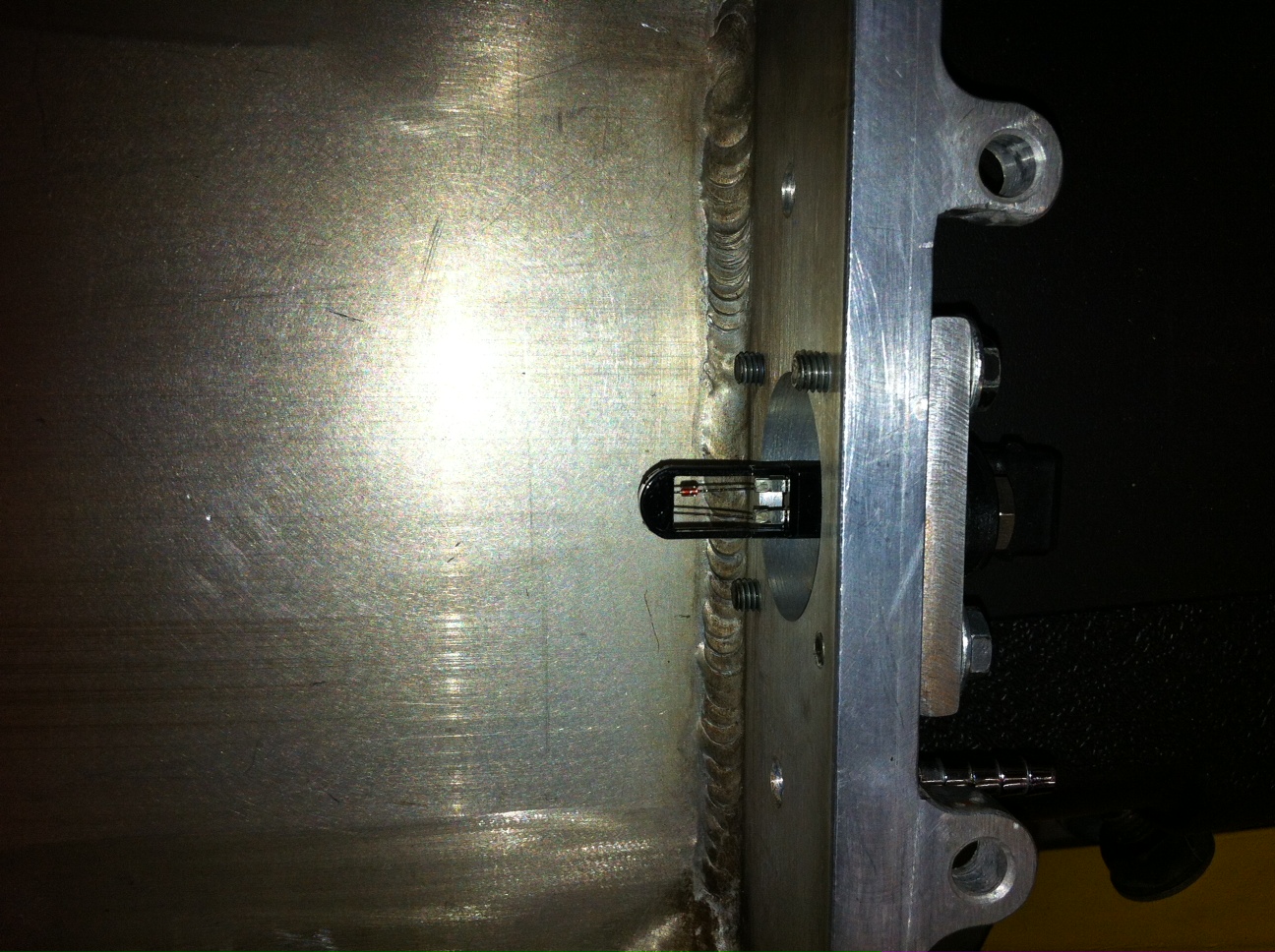

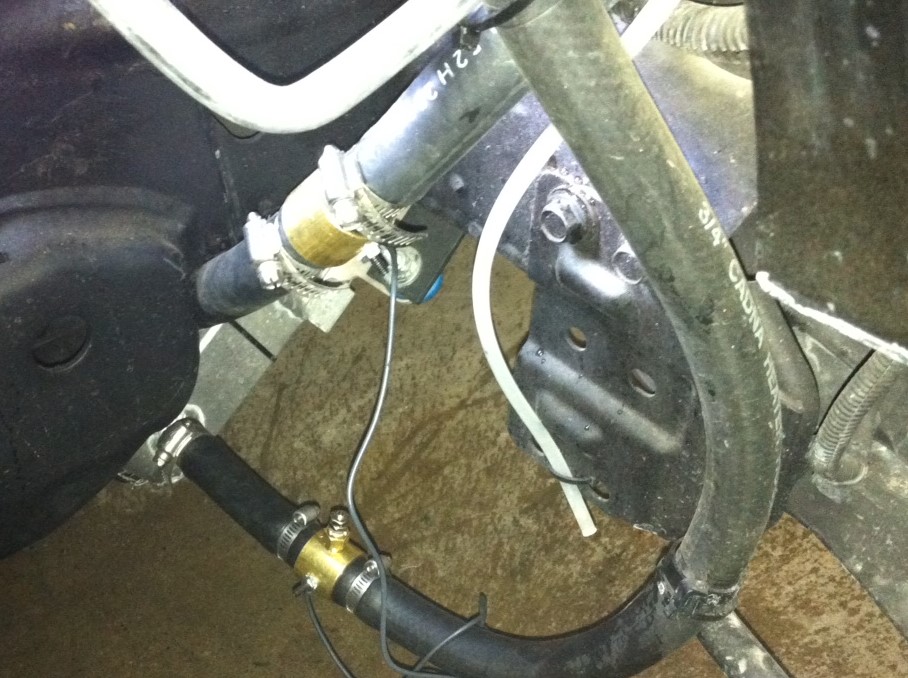

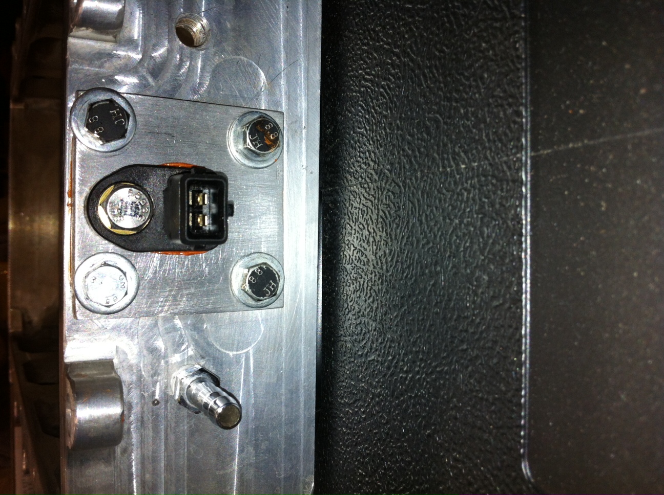

Just worked on some sensors today. Pre and post IC IAT, oil pressure, HX in/out temp.
Thinking about exhaust back pressure and crankcase pressure sensors as well.

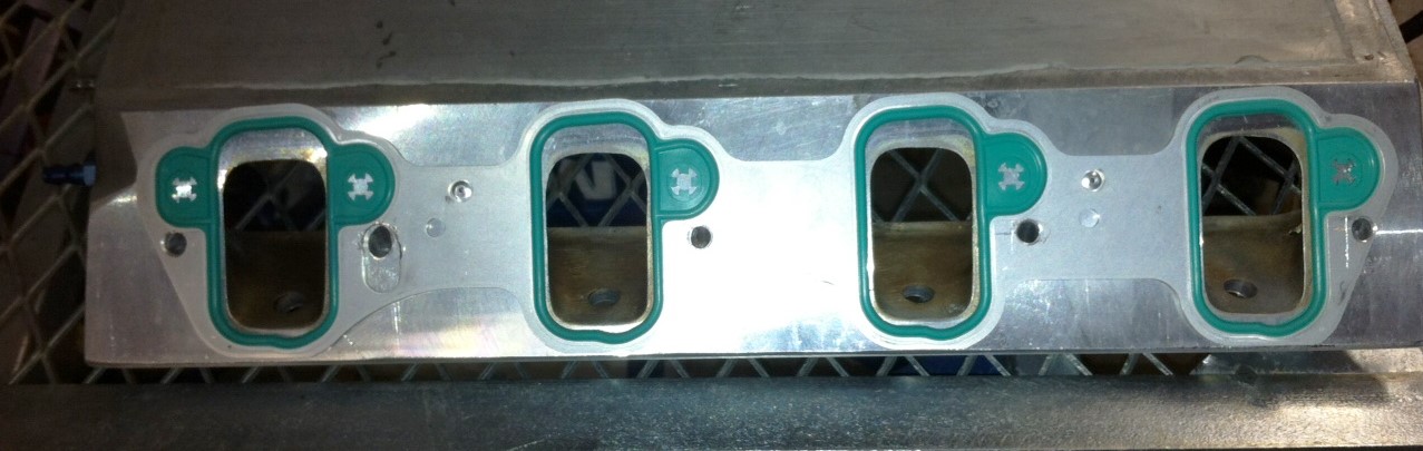

Thinking about trying some re-worked LS9 intake gaskets instead of the paper LS7 Felpros. This is the best fit arrangement.
