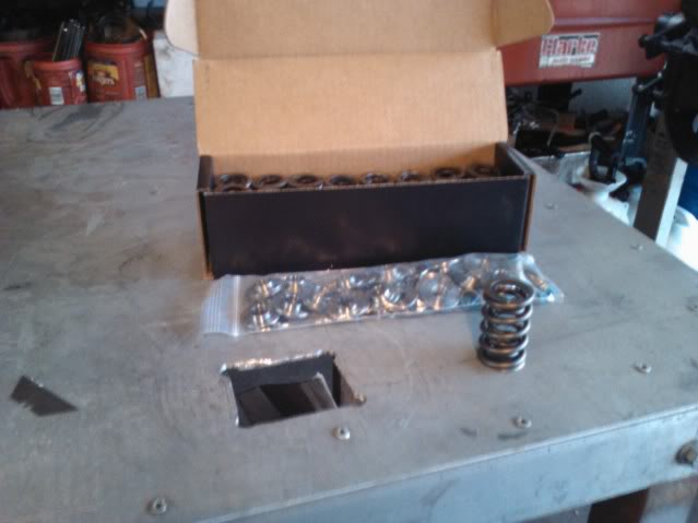

I plan to do the usual that most do 6L and 4l80 swap. I have my LQ9 swapped 95' that was my project truck until I got rear ended 6 weeks ago. I shooting for a DD truck that makes at LEAST 600+rwhp on a safe tune. I don't beat on my vechicles much so I can make one last.
Here's some of the specs on my 05' LQ9. It has around 8k miles on the rebuild.
Stock bottom end with ARP rod bolts
Lightly ported and milled 317's with upgraded valve springs
MS3 camshaft/hardened pushrods
LS2 timing set
Hi volume oil pump
ARP head bolts
Since I have this engine and it's just sitting right now I figured it would be a good one to start with. Is there anything I should change or worry about other than the cam and head gaskets? I want a good cam that will compliment a turbo well but isn't real noticable. Any suggestions??
I plan to run a trick or KBracing kit. I'm new to turbo's always had superchargers. I want something that spools good but has potential to make 800+rwhp IF I wanted.
Here's some pictures of the engine from when it was put together.
