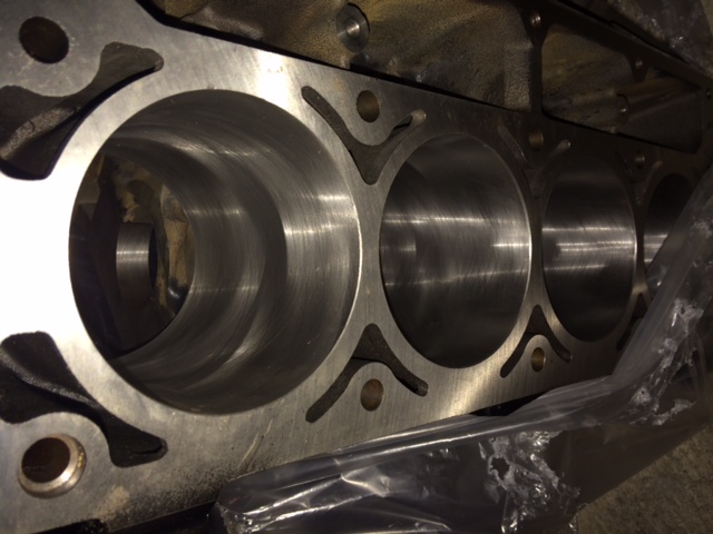

FINALLY GOT THE BLOCK BACK!!! All painted and decked now just waiting on the crank. Then we should start putting the bottom end together!

And now crank may be ****........ The hits, they justa keep on coming.

Is the crank not straight or out-of-round journals?

Little excessive wear on the journals, gonna have to undersize on them. For what i will be spending in new crank bearing undersized and machining, I could just but a new crank and get piece of mind i think.
