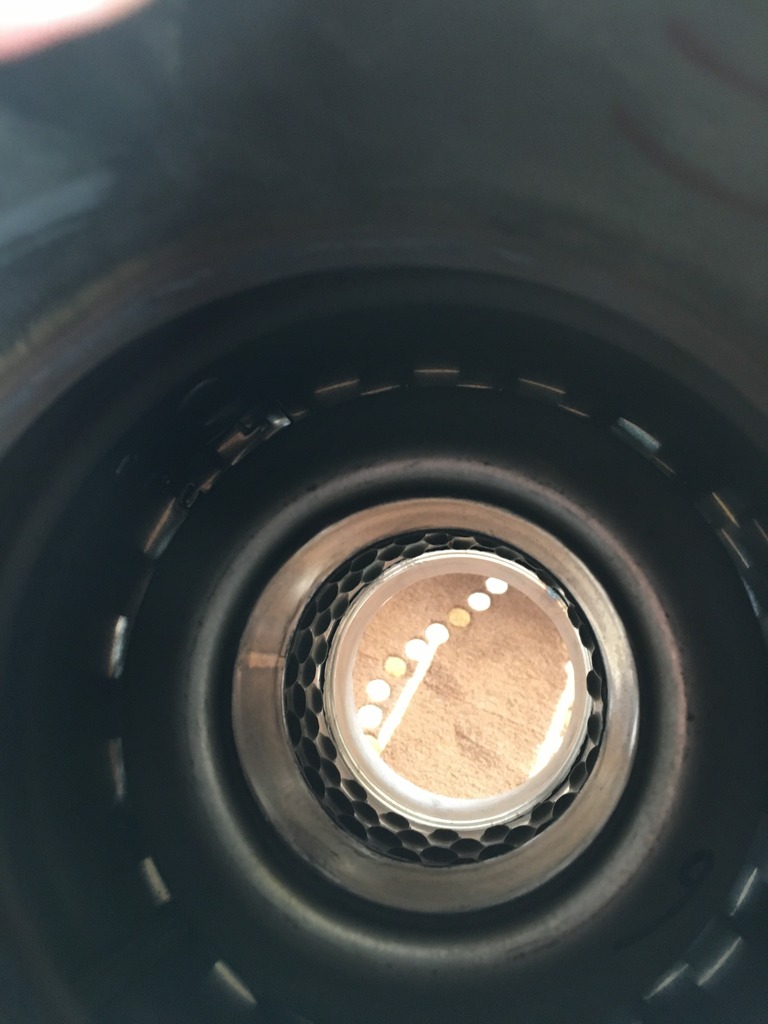

Its an aero turbine at5050. The diesel guys seem to like them. I ordered it online and quickly looked at the dimensions and was like yea yea 5" inlet something like an 8" overall diameter. Its got a weird venturi design inside of it that is supposed to suck the exhaust out theoretically. I just wanted a muffler that did a little something but not a lot. And then i got it and just about pooped myself. Its XL.
this is the view from the inlet.

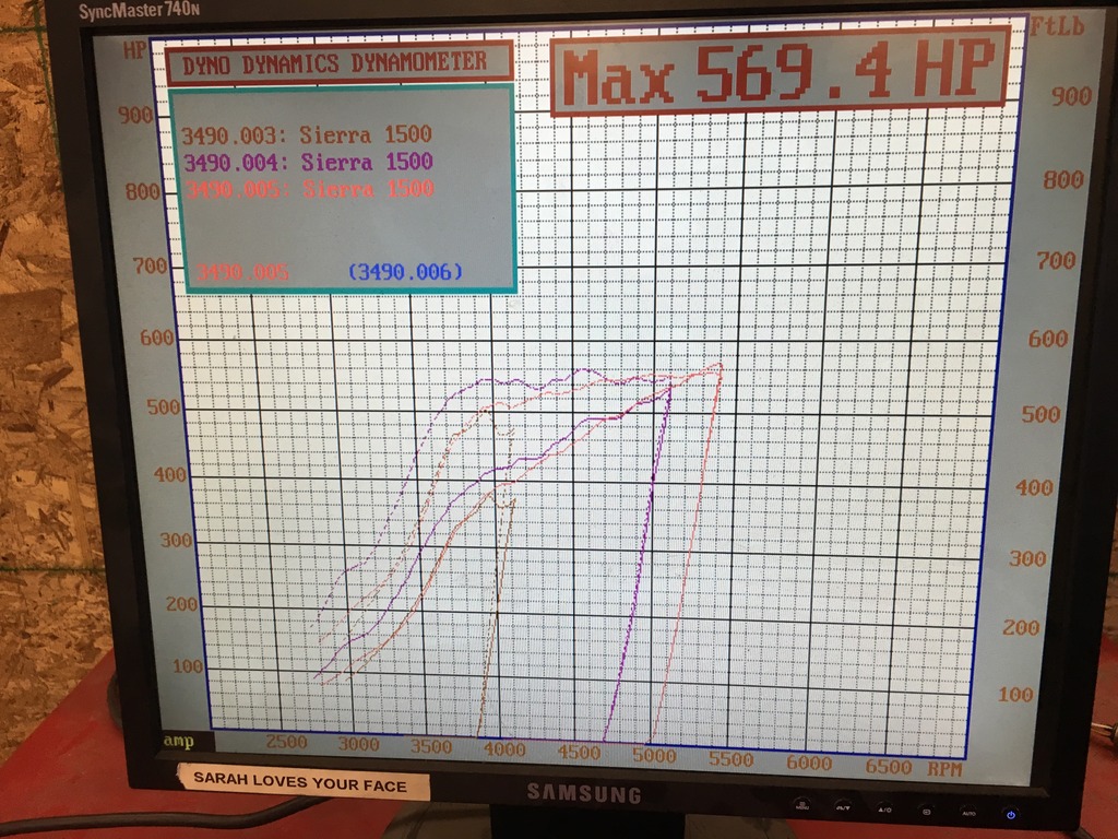

Spent the day at the dyno. Kind of a screw around but whatever. Ended up having to put a cooler plug with a much tighter gap to get it to no miss fire. My plug wires also took a beating (having a little mid range mis fire) so time for some new, longer wires. Also need an intercooler surge tank to make the pump stay happy.
ANYWAYS.
Tuner ended up stoping at 5400RPM because the boost crept to somewhere around 18psi
. At that point the 2bar tune was more than maxed out and a degree or 2 of knock came into the picture so that was it. I was rather impressed with the torque curve. Boost comes on at 2500, and it loves it life at 3500.
Final pull:
5400RPM
16-18psi, should probably pull the log and see.
4th gear
~550 ft-lbs
~570hp
Ended up at 8 degrees of timing

I really wanted to see 600, but it easily has that in it with out the high boost levels.
