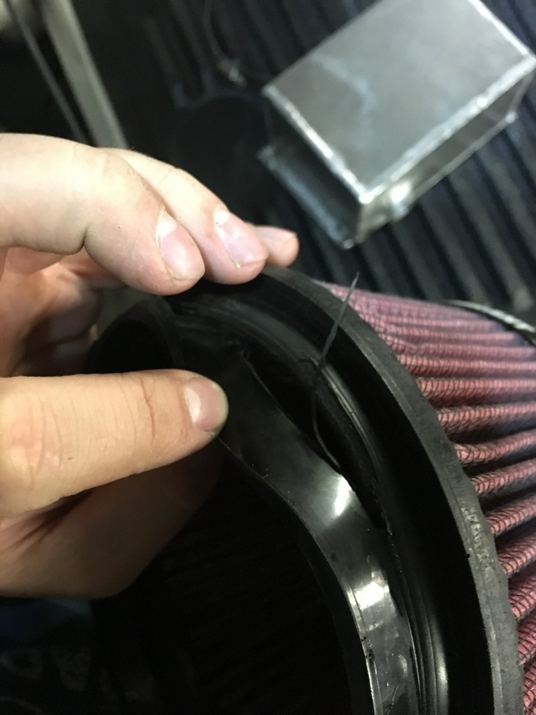

#67
Its like the combo of heat and the clamp pressure made it go blaaahhhhh out the sides everywhere. Its touted as a tight space air filter, so I'm not sure what I did mega wrong for that to happen.

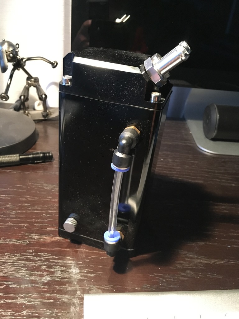

I also decided to get serious about the PCV system.... and delete it.
Another amazon special. $22 I think hahah. It doesn't have a baffle in it but thats ok, I can make something up that'll do the trick. I also saw stories of people buying expensive catch cans and still having to cut them open to make them work. The best thing about this one is that it has a removable top and bottom so you can do with it whatever you like inside. It seems like the case is an extrusion, and the top and bottom are some form of billet. Ill probably feed the 2 ports that are on it from each of the valve covers, and then drill a new vent right out the top of it that will feed back into the turbo. I also need to find out how guys are deleting the actual check valve that is in the drivers side valve cover at the back.

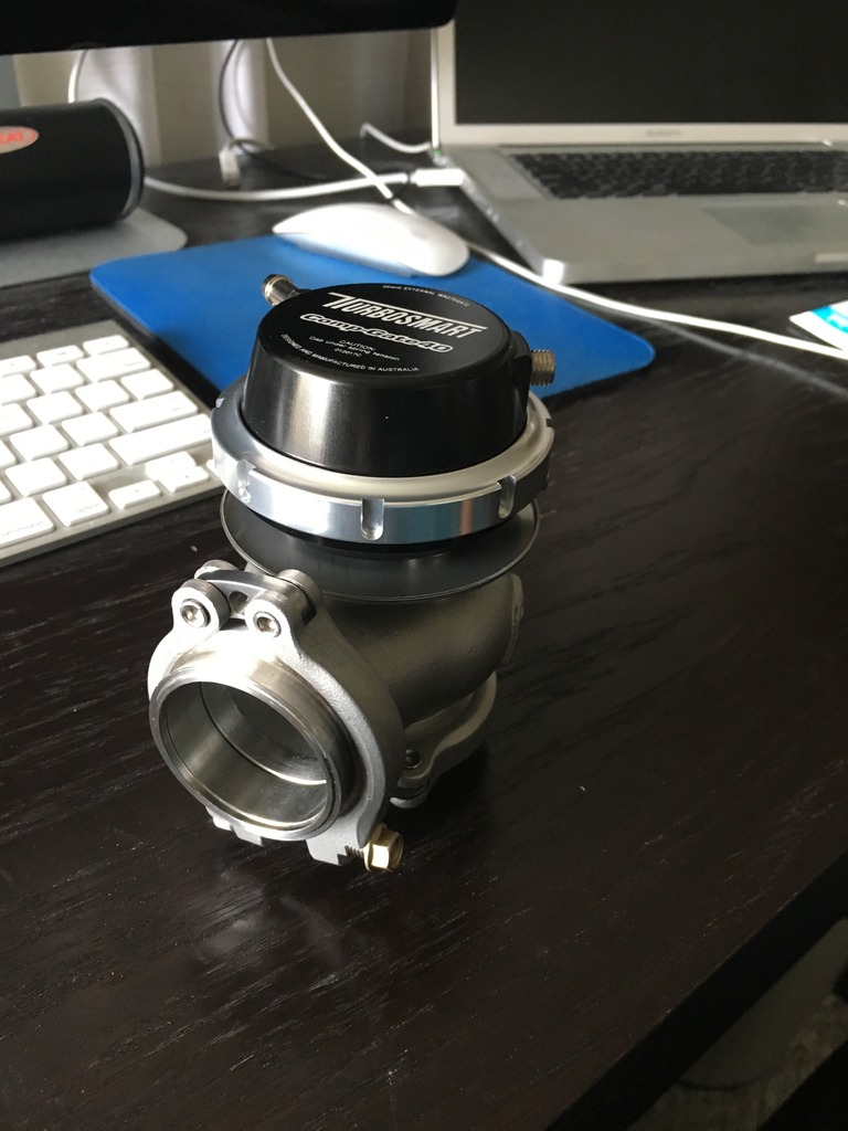

hopefully this keeps the boost inline, its the same as I already have just a multiple. They come with 2 springs in them, supposedly 7psi a piece. If they can do their job properly ill probably end up with the 14psi combo in both of them.
