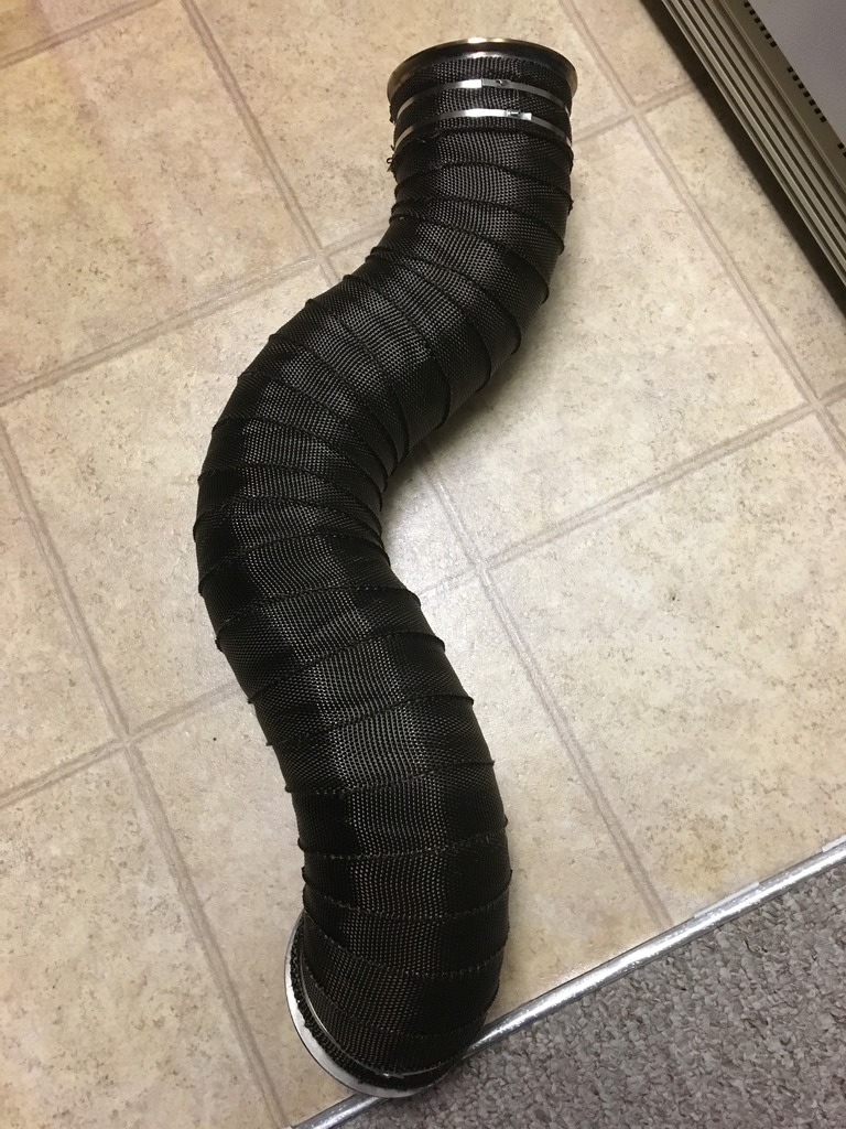

I also found some nice heat wrap on amazon... 2"X50' for $35 CAD. Theres roughly 40' on the down pipe alone.

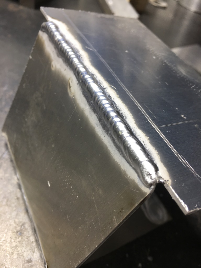

The welding portion of learning.... These were some of my better passes. Other than that I was in gap fill mode which turns into a clown show. I consistently seem to go a little light on the heat, probably due to my fear of having to fill a hole hahah. It didn't help that I sat down and did like 3 test passes and then moved onto important stuff. Anyways, I'm sure lots of you know a lot more about TIG than me so I won't get into that stuff. I seemed to be alright with aluminum on a flat pass, but when I went to tubing it gets 14029 times harder for me due to how fast you have to move around the contour.

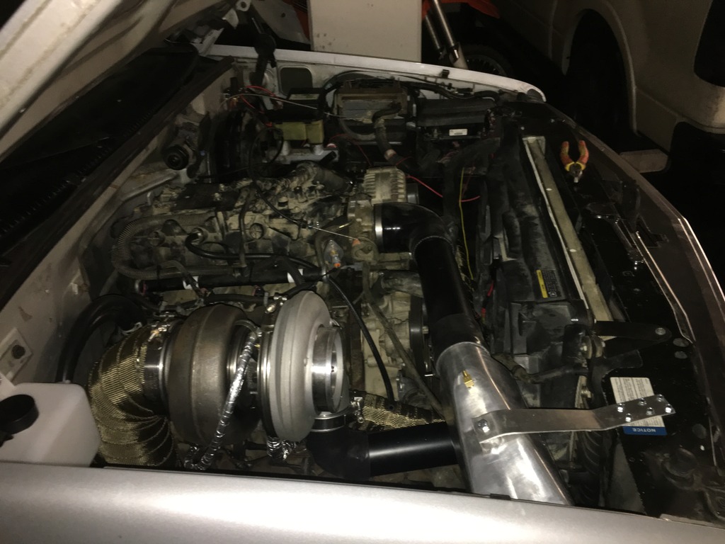

sooooo yea..... Drank some beer and listened to some metal, there just happen to be some truck work get done.
So I ordered the LS9 MAP sensor awhile back as it was 3 bar, you know, all the boost right?. 12592525. I did a basic white gurl search and seemed like everyone and their dog used it... On LS intakes. haha whoops. So I flanged up this little adapter at that sits in the place of the original truck MAP and has 2 1/8" NPT ports in it, one for the remote mounted MAP sensor and one for the boosty gauge. I made it the right size so that the engine cover plastic bolt down thing holds it well in place. I made a simple block to bolt the MAP into. 8" of nylon line and some compression fittings and I was back in business. I bolted the map to the underside of the throttle cable bracket.

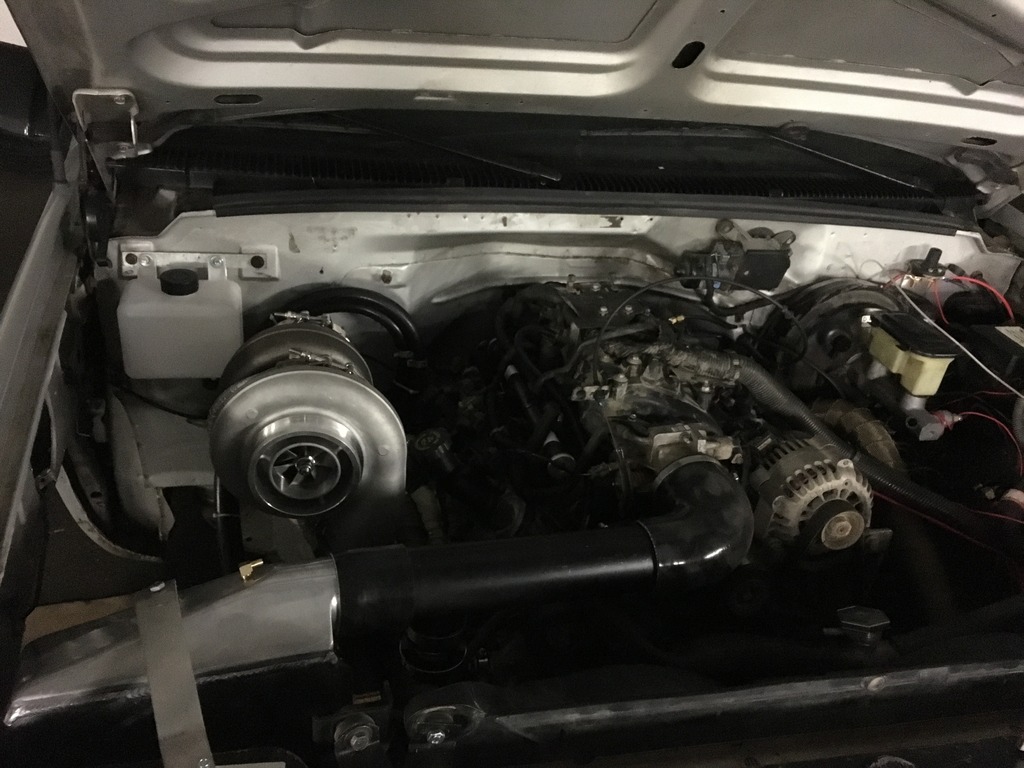

So this is largely how the cool side of the engine bay is going to look like. Missing some air filter that I have yet to buy and some clamps.

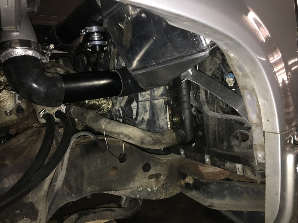

I tried to push the IC as far forward as I could to leave as much room as possible for an air filter. I dislike greatly how the charge tube isn't parallel to the rad support, but whatever. Ill get over it.
I eventually have to do something with the lower coolant line. It just touches the crossover, probably have to find some mouldable hose next time I drain the coolant. I never realize how dirty the truck is until I look at the pictures, its so dark down there I dont even notice it.

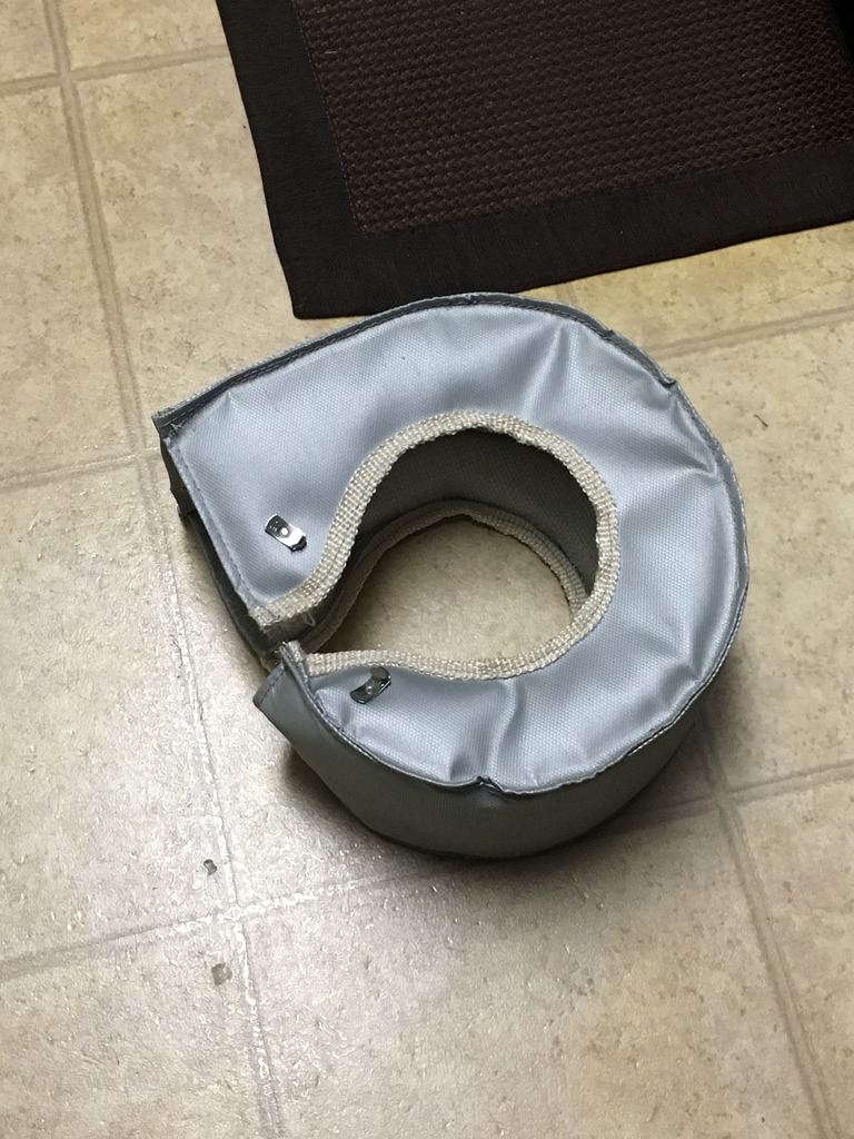

I also splurged on a half decent heat blanket. Thermal Zero, they seemed to have decent things said about them. They aren't $600 which is nice. And they're are made in 'MURICA. I originally thought it was 18 sizes too big, but then I just realized thats the size of a T6 turbo.
