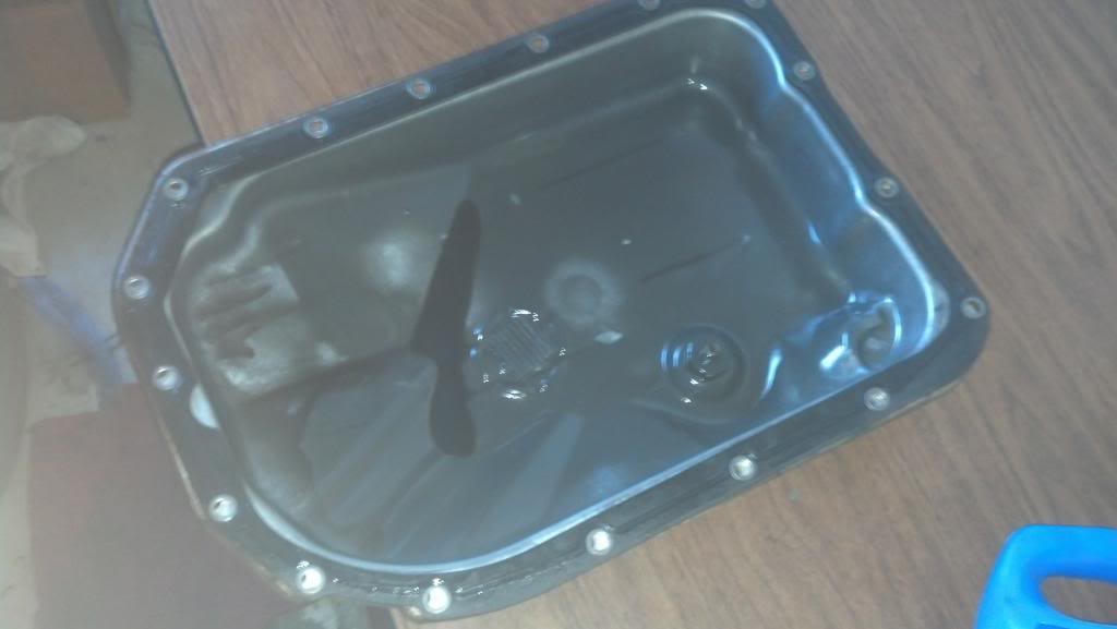

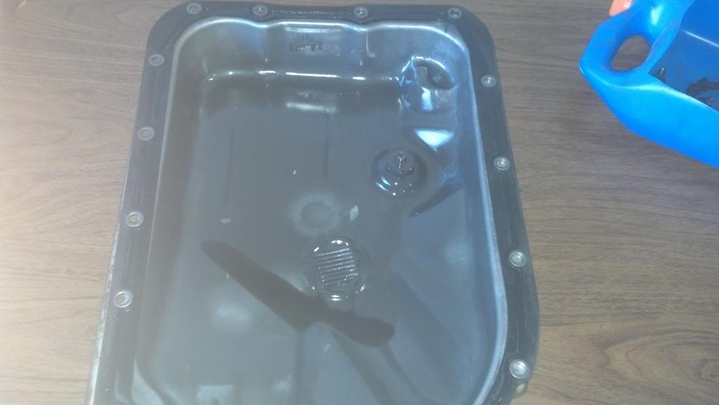

This thing is nasty... Excuse the phone pics, they turned out worse than I expected.

Yikes. Hopefully its still usable. New valve body should be here soon. The transgo shift kit showed up a few days ago along with the transfer case rebuild kit.
