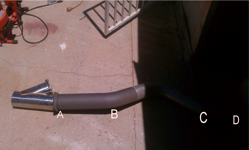

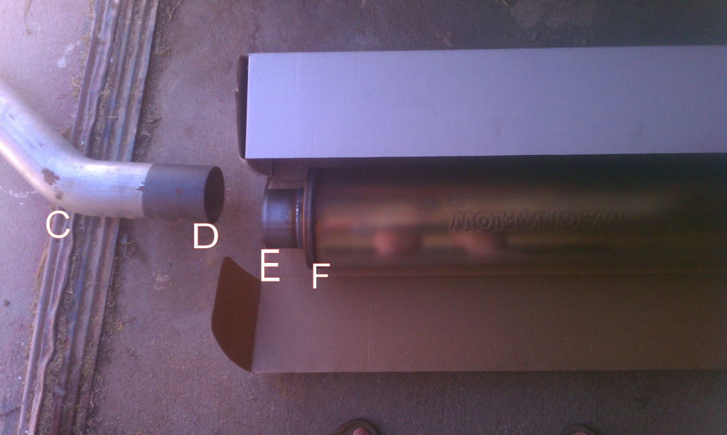

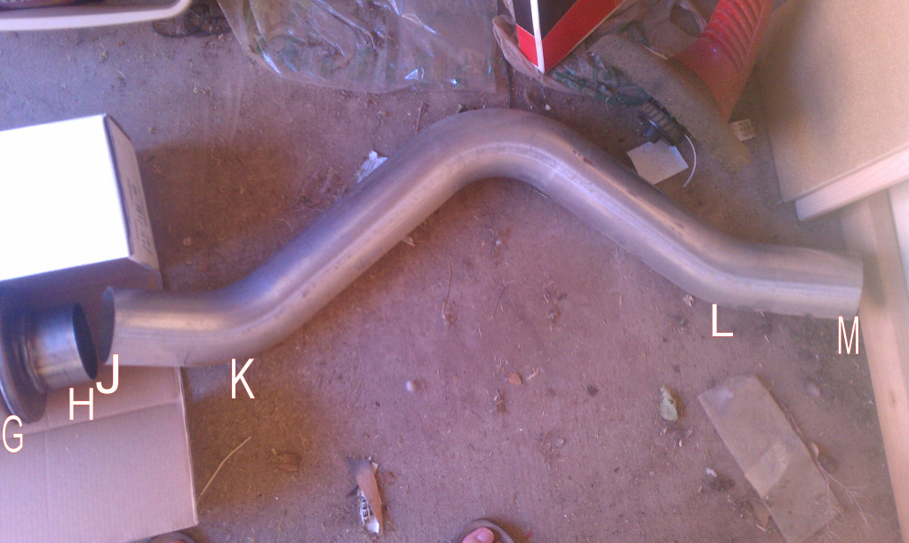

so I got some measurements from my Dmax exhaust. Here is what I have
the measurements:
A-B= 16"
A-C=38"
A-D=49.5"
E-H=36"
F-G=30"
J-K=7"
J-L=32"
J-M=40"
A-M=127ish
The cutout is 10"
the 3-4 merge is 5.5"
I will have to cut about 1" off of A-B because of the flange.
The front pipe goes under the frame cross over. I would like to keep the exhaust as hidden as possible.
I have 4 options:
1: I can install everything like it that and run the 1 muffler.
2: try and fit a 14" body, 8" round, 20" overall magnaflow between the trans and tbar xmembers, there is just enough room, but am unsure if the front pipe will fit. I would have to cut it all the way to B.
3: I could buy about 4' of 4" tubing and run it strait like how smokeshow has it.
4: same thing with the 4" tubing and try and fit the smaller muffler in the same spot as earlier.
Any other options? What would yall do?

Yea, didnt you say it was LOUD lol. Im thinking by adding the 2nd muffler it would help quite it down. I have the cou out for when I want to be loud.
Old Jun 15, 2012 | 07:45 AM
  #327
Spoolin's Avatar
GFYS and STFU
Posts: 13,870
Get a resonator from a Dodge Ram, worked really well for me and didnt effect flow much.
