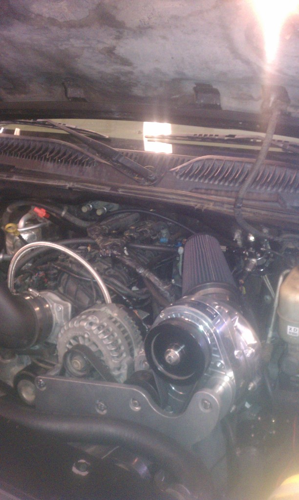

Old Sep 19, 2012 | 08:22 PM

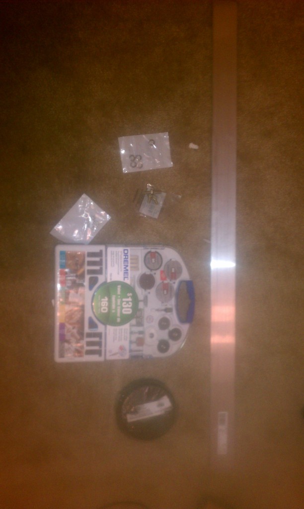

Supplies for the fuel rails. lol
Going back to the shop in the morning and hopefully I can get that squared away. Then the Bosch 044 inline can go on.

Going to cut the aluminum into 2.5-3" strips, drill a 1/4" hole on one side, bend the other side down about 45* and mount it over the fuel rail to hold it down. On the drivers side Im going to make one longer and have it 90* up and mount the fpr to it. And use the wire to help hold it down because I doubt zip ties will last long with the heat.

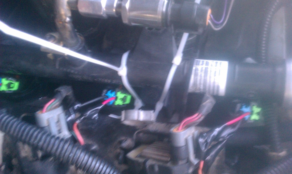

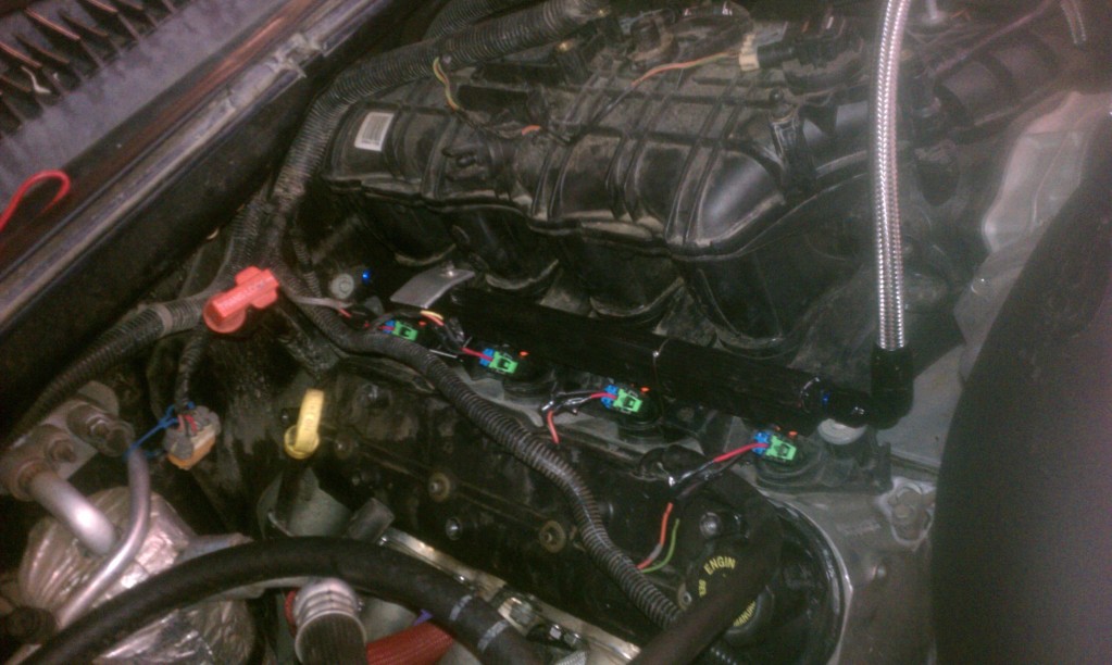

Well it took me long enough. But the fuel rails and FPR are in
Have a slight leak on the #6 injector. the O-ring had a small nick in it. Going to have to get a new one. Fuel pressure is steady 58psi with the vac hose removed and 50 with it attached. Where it was about 44psi before. and its nice to see the fuel pressure go over 60 when boost comes in. Going to try and get the Bosch 044 installed and wired up tomorrow.
