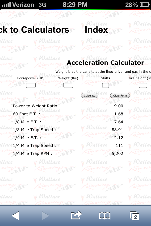

I know this is just a calculation but they seem to be pretty accurate. But this is at 600hp, 5400lbs, 3 shifts, 32.6" tires and 4.56 gears
its right along with all of my times.
that was peaking at 12 psi in Tucson. My one short WOT run that I did here in Minot ended at 6700 rpm and 12.8 psi. still had 200 rpm to go. So Im looking for a 3.5 or a 3.4" pulley. I kinda dont want to get a different crank since this one is already keyed.

I think that calculator is a bit off, eventhough in Tucson I could only trap 96-96 n/a, but the effect shouldn't be as bad on a boosted motor. Looking at some online calculators, I'm coming up with around 515 rwhp. Seems a little low for a 6.0 on 12 psi. Although you are AWD thru an 80e...
