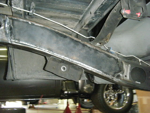

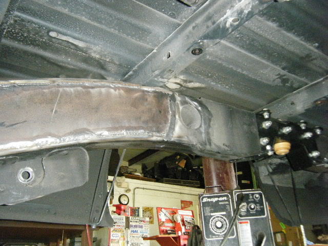

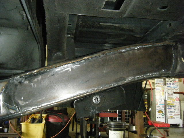

Got a couple more pics from Steve today. Thanks.
Boxed frame rails.

We can cut the old tabs off. You cant back brace a 10-12 bolt or you wouldnt be able to remove the carrier.

Why did you box in the frame?

If we dont box it the 4 link will rip out. Once we get the front brackets in place you will see the reasoning.
