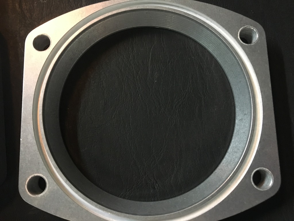

New Flanges
Adapter 90mm to 102mm. Using this just to test the TB

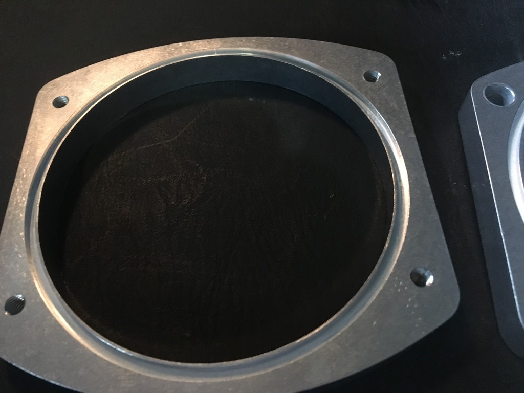

Straight 102mm to use as a quide when i port the snout.

They look great. When will the 102 make it on?
