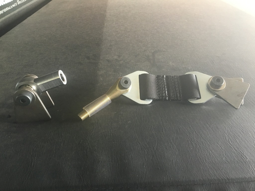

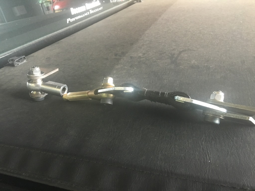

Sooo with the new found traction i am experiencing alot of engine movement. My motor mounts are stock and have 150k on them soooo they are probably shot. The engine moves so much the headers hit the steering shaft. I have a set if solid motor mounts but i want to try something different. I bought a set if acdelco motor and trany mounts. I am gonna install those.
Then i am trying to build a strap to keep the motor from torquing over to much.
I used a 6in suspension limit strap, a clevis and a hiem joint. The adjuster is still waiting to be delivered. I am gonna attach it to the alternator bracket and driver side frame rail.
Here are some pics.
The adjuster. It is actually for ladder bars.

Is there a reason for not going to solid mounts? Although I appreciate your spirit for trying something new. In for results.

Well i started thinking when i removed/installed the tranny you had to tilt the motor down. With solid mounts that goes out the window.
If this does not work then i will swap to the solids.
Main reason is to try something different.

Just tilt the motor back about 3* and run w it.

I got the new motor and transmission mount swapped today. Only took like 3 hours and that included removing the headers. The old ones were wore out i could move them with my hands no telling what they were doing under a load.
The bad. I broke amspark plug wire and one of the spark plug holes was screwed up. I always use antisieze so i dunno what happened. I got a tap and ran it through it several times which helped but it was still kinda tight. I might need to plan on swappping to some different heads eventually if it does it again.
I am gonna swap in a fresh fuel filter and my new ID850s tomorrow and see how it does.
I am still waiting on that damn adjuster to come in to finish the motor strap.
