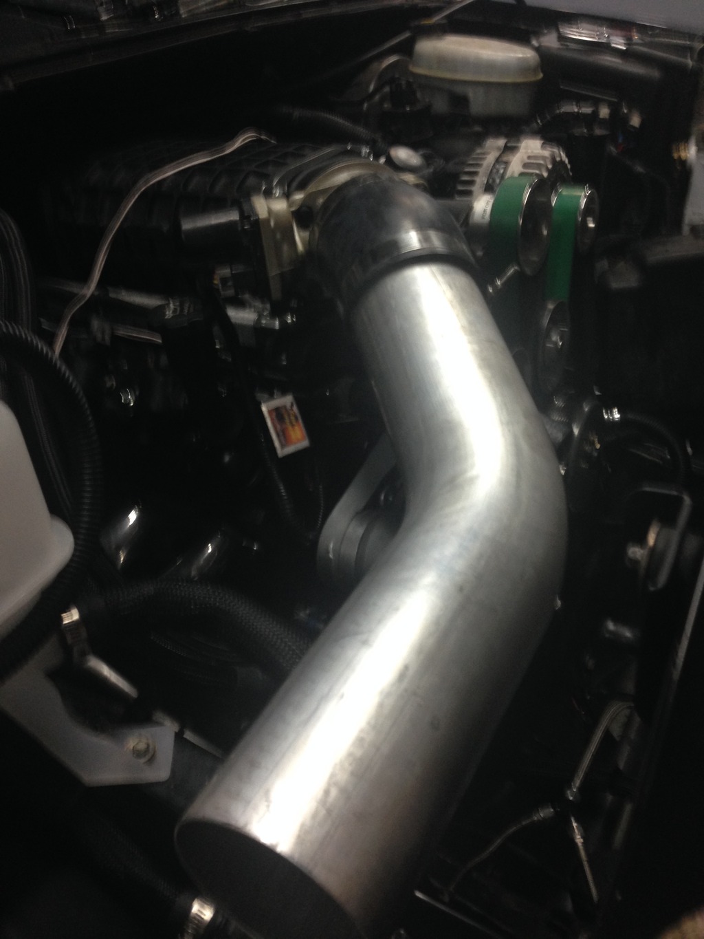

Well the parts i was hoping to come into today, did not... So i did not get much done... I got the right size belt. It should work fine, the tensioner is in the middle of its travel... My rubber 22* coupler and 4in Aluminum pipe came in today for my intake.... Anyways here are the pics...

That blower pulley looks big...

it is a 3.4

Why did you go with the 2300 over the 1900? I would think the 1900 would be better for your setup given DD and low boost
there you go thinking again.... I plan on 14psi just like i had with my turbo...

Ok. 14 psi is low boost and Rob's 1900 is doing serious work on his ride. Thinking ahead in case I want to mild my setup for fulltime DD status. Wanted to get your input.
Robs setup is also maxed out with a 2.7 pulley.... A bigger blower will generate less heat, as you know, heat is bad... Besides it was only a $500 upgrade to get the 2300 vs 1900... Seems like a no brainer to me....
