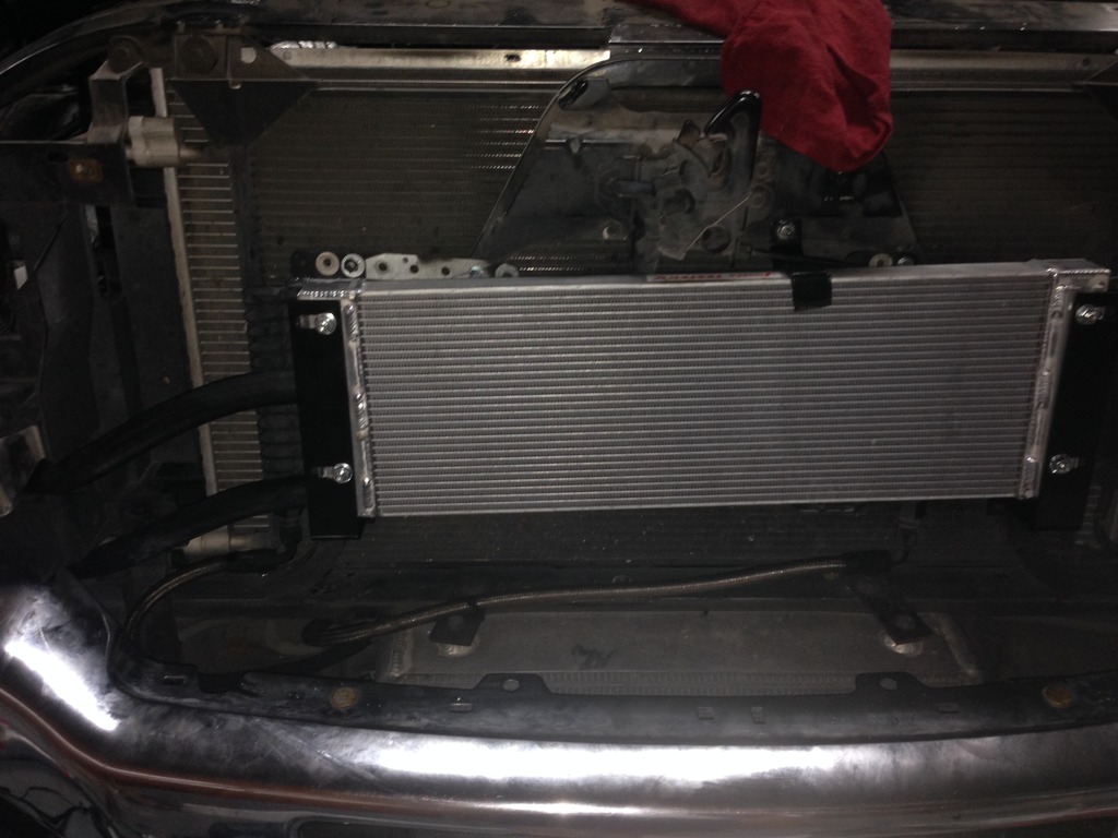

some more progress today. I removed all the wiring for the gauges on the passenger side of the engine bay. Man that took forever.... I got the blower all torqued down. then i decided to work on the Heat Exchanger plumbing...
Hoses all mocked up, i still need to secure them...

Heat exchanger mounted, i had to move the Tru-Cool over a little bit to use the mounting brackets that came with the kit.

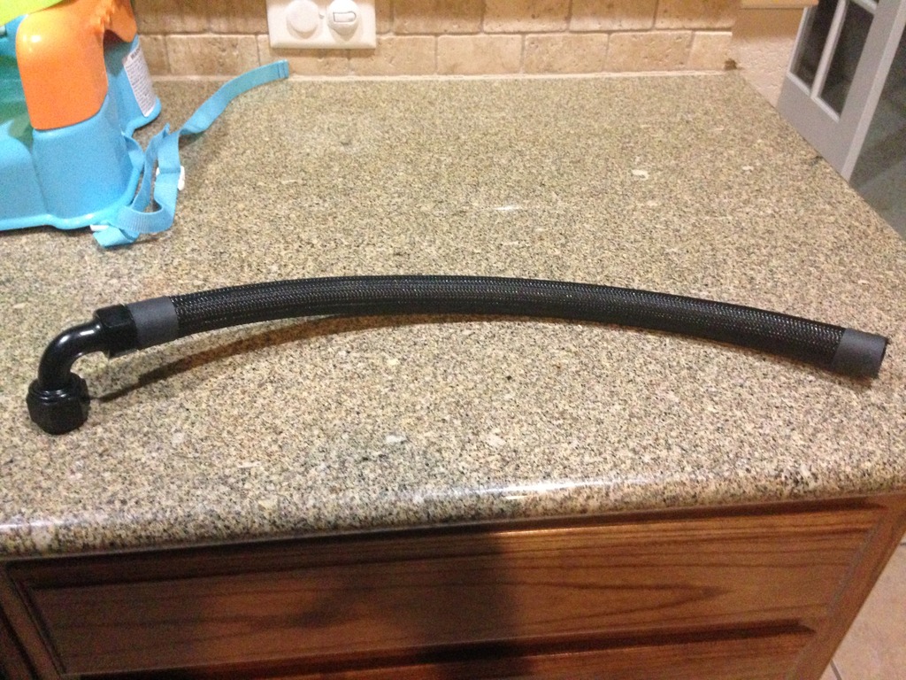

Then i applied the nylon hose cover. I also used heat shrink on the ends. This nylon stuff FRAYS soooo easily. If anyone trys this, make sure your burn the ends before sliding it over the hose. Then after you cut it, burn it again.

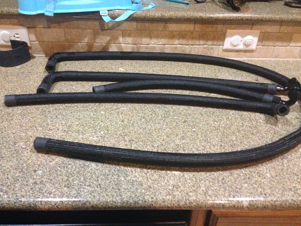

all the rest of them
