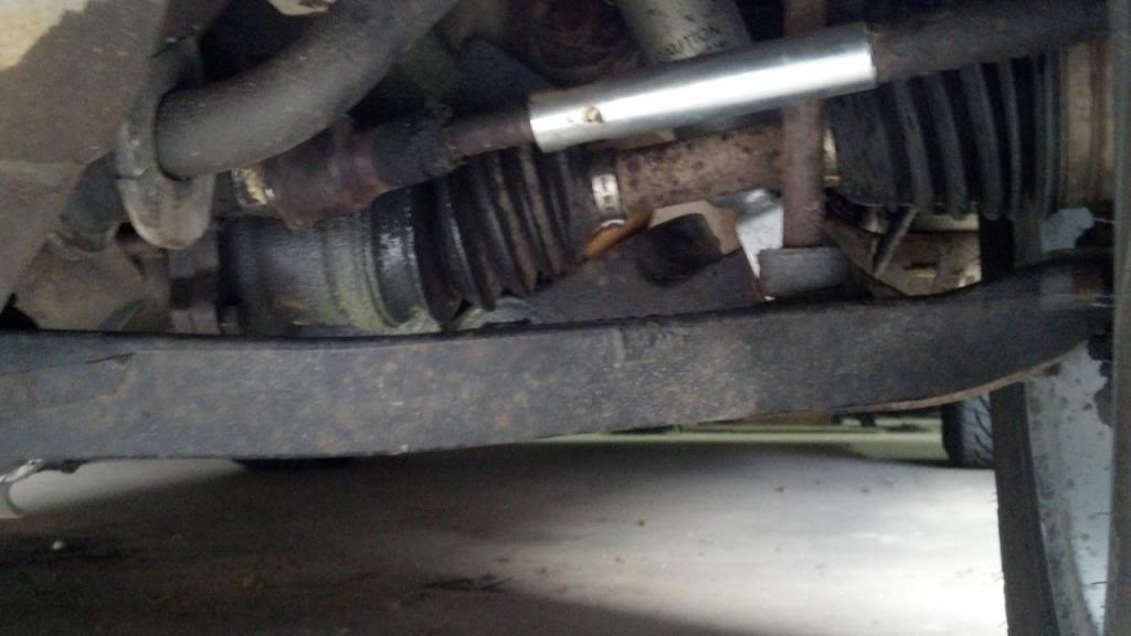

What do you guys think of these angles? I know the diesel guys like to have everything flat to keep from bending tie rods, I'm hoping slightly negative will be ok since some of the weight will transfer to the rear when launching.

you can always get some bump steer ends to lower the tie rods down

What are those? Never heard of them.

Chris Alston's Chassisworks, Inc.; Chris Alston's Chassisworks, Inc. - Bump-Steer Tie-Rod Sets , just to give you a idea on them

Originally Posted by thunder550
I did check the UCA adjuster bolts and they are maxed out...are there different UCA's that I can get to allow it to be aligned properly again if they can't get the camber in spec?
You can get 2* offset bushings for your upper control arms. There are also aftermarket eccentrics for another 1 1/2* if you need more.
