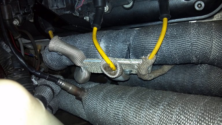

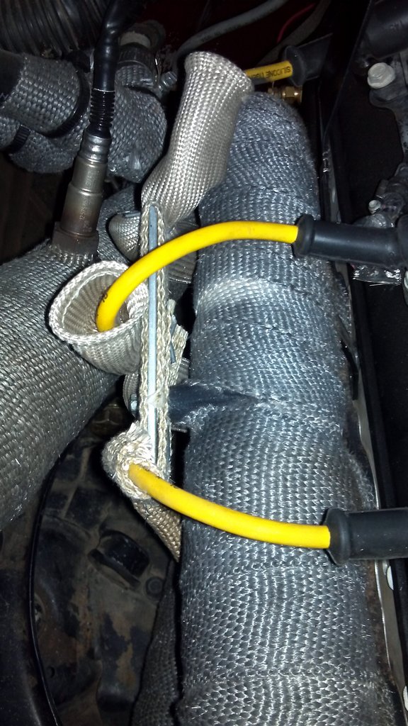

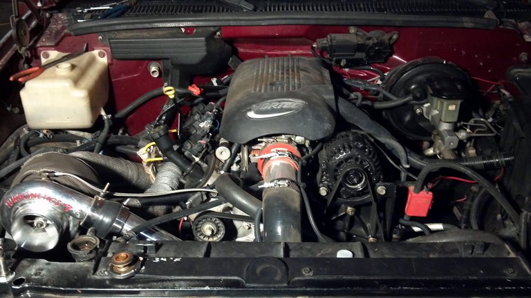

Well I was having problems burning up my plug wires so I did this! Cheesy, I know but very effective! I bought a roll of new wires and just use the ends off of my burned up wires to make slightly longer ones. Plate is aluminum wrapped with header wrap.

Old Oct 5, 2012 | 02:39 PM
  #106
SuperStepside's Avatar
Joined: Apr 2012
Posts: 53
From: Miami, FL
Looks good. Intake setup is next? Also harbor freight needle nose pliers ftw.

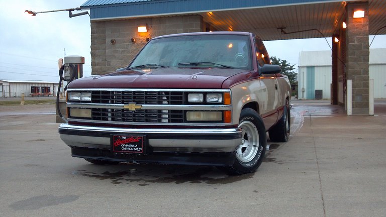

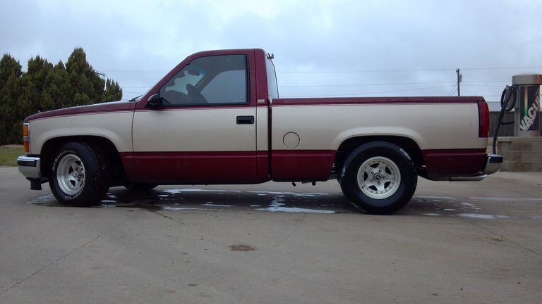

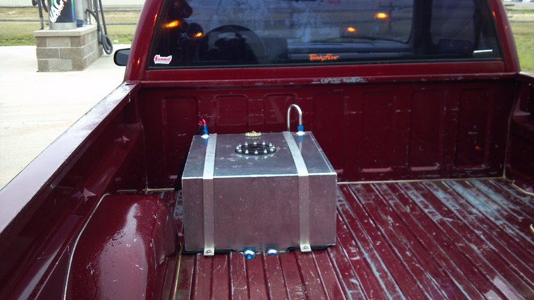

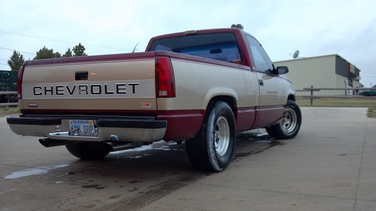

Finished product pics!!! (although the intake is temporary lol)

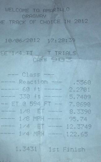

Also got some track times!!! I'm not to concerned about the time because its still on the stock converter. This was 3400ft D/A, 4200# race weight and on 11psi.

Old Oct 8, 2012 | 12:31 PM
  #108
WhiteChevy3's Avatar
Joined: Aug 2005
Posts: 612
From: Oklahoma
Nice build bro!
I assume u are running untouched stock 317 heads?
Old Oct 8, 2012 | 12:47 PM
  #109
oakley6575's Avatar
Joined: Dec 2010
Posts: 5,235
From: Las Vegas, NV
That is a good MPH. Lets see some driving vids!
Old Oct 8, 2012 | 12:53 PM
  #110
black00chev's Avatar
Slowest turbo build ever!
Joined: Dec 2009
Posts: 2,905
From: Warrenton, VA
damn that 122mph trap speed is nice!
