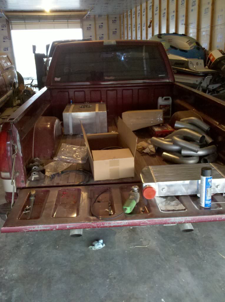

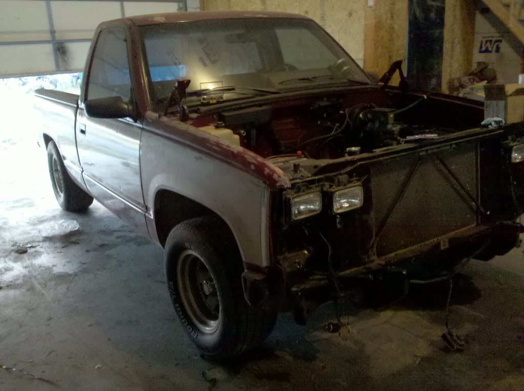

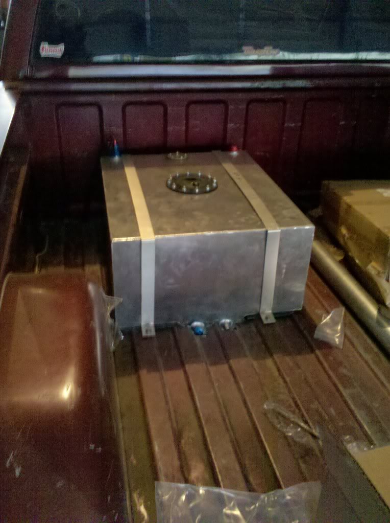

Here's what the truck/progress looks like lol

Your making progress though. Keep the updates coming

Looking good. 1 question though, why have the fuelcell up front on the left and not in the back center of the bed where it would be adding better weight to the rear tires evenly?

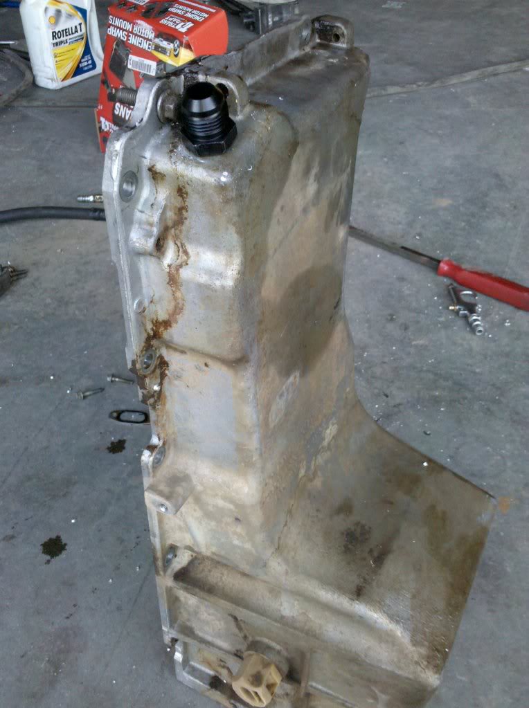

Have you installed the oil drain fitting in the pan yet? Im looking for where to put mine.

my best guess would be he did it for a general shorter length fuel system
Truck is gonna be more than just a drag truck so I'm trying to leave as much room in the bed as possible, I'd like to still be able to load a 4-wheeler with the tailgate open.
Yup, here:
