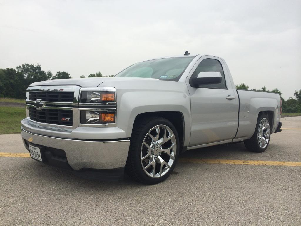

After 4/7 drop with paper tags still
And how it sits now with painted handles and mirror caps

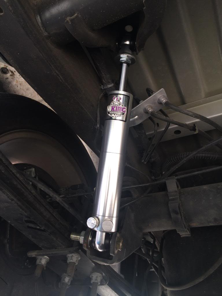

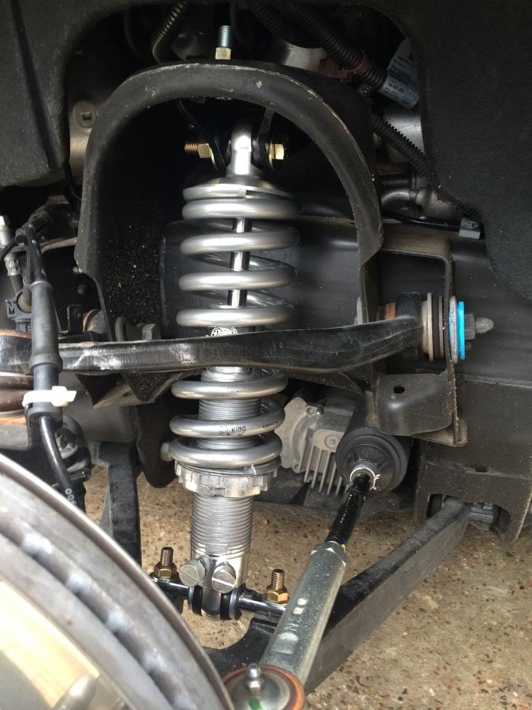

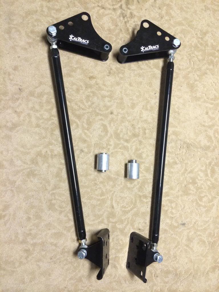

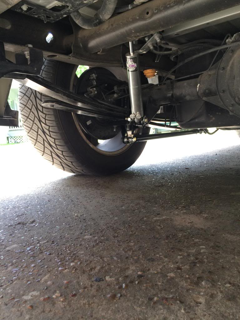

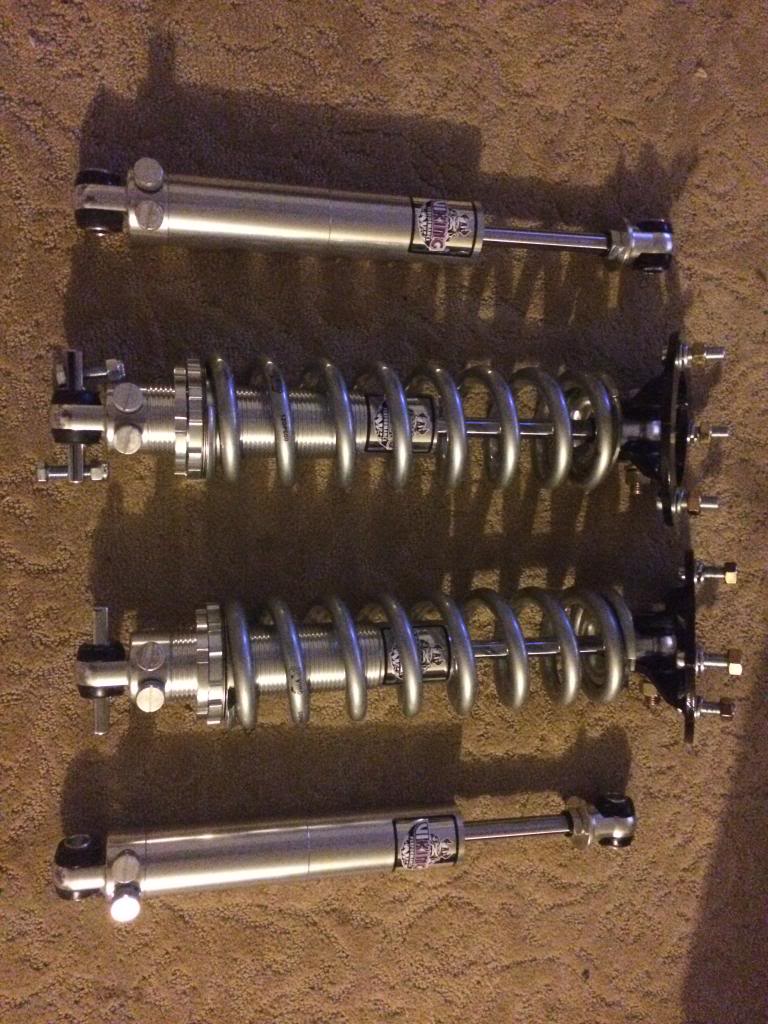

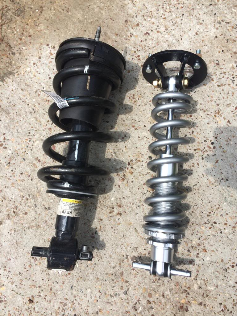

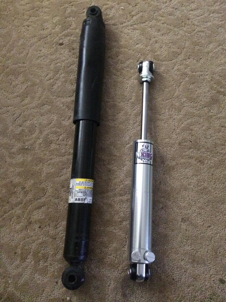

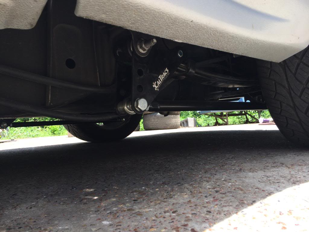

Well I finally got my coilovers and double adjustable shocks from Viking installed. Got the idea from GWEE
also my cal trac bars. Major difference!!!

Thanks fellas. They are Viking shocks and coil overs. They ride a lot better than the factory shocks with drop cups and the rear shocks from mcgaugys. C210t is the part number of the coilover. The spring is part number 12dp600. They are like 250 each for coil overs with spring. I'm still tuning on them to get them completely right for my setup. I also have pro-comp coilover mounts. Unless your truck is dropped 4" up front these coilover will be different than you would need. My front ride height is 14 1/2"

Man that truck looks good. This looks very promising. Do you have the part number for the rear shocks and the T-bars on the lower front coilover as they show a 3" and a 5"? Now C210 is the front coilover part number they show, on your previous post you show a C210t, is this correct?.
