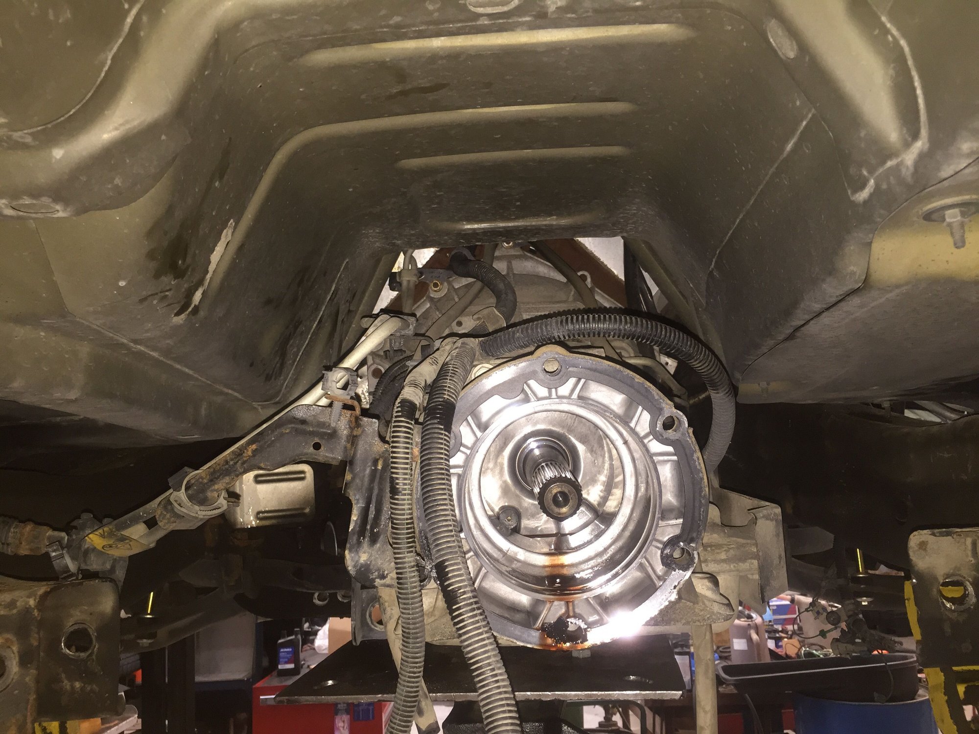

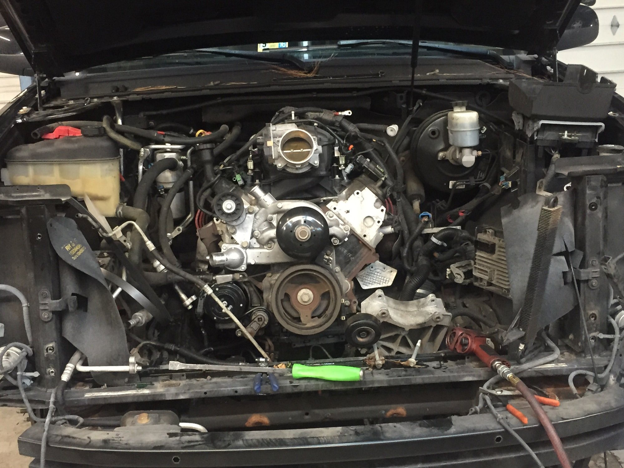

Transfer case out, most of harness disconnected
This is howni left it thsi evening, another 45 minutes to an hour and the 5.3/4l60 wouldve been on the ground... Had a few snags along the way.....
