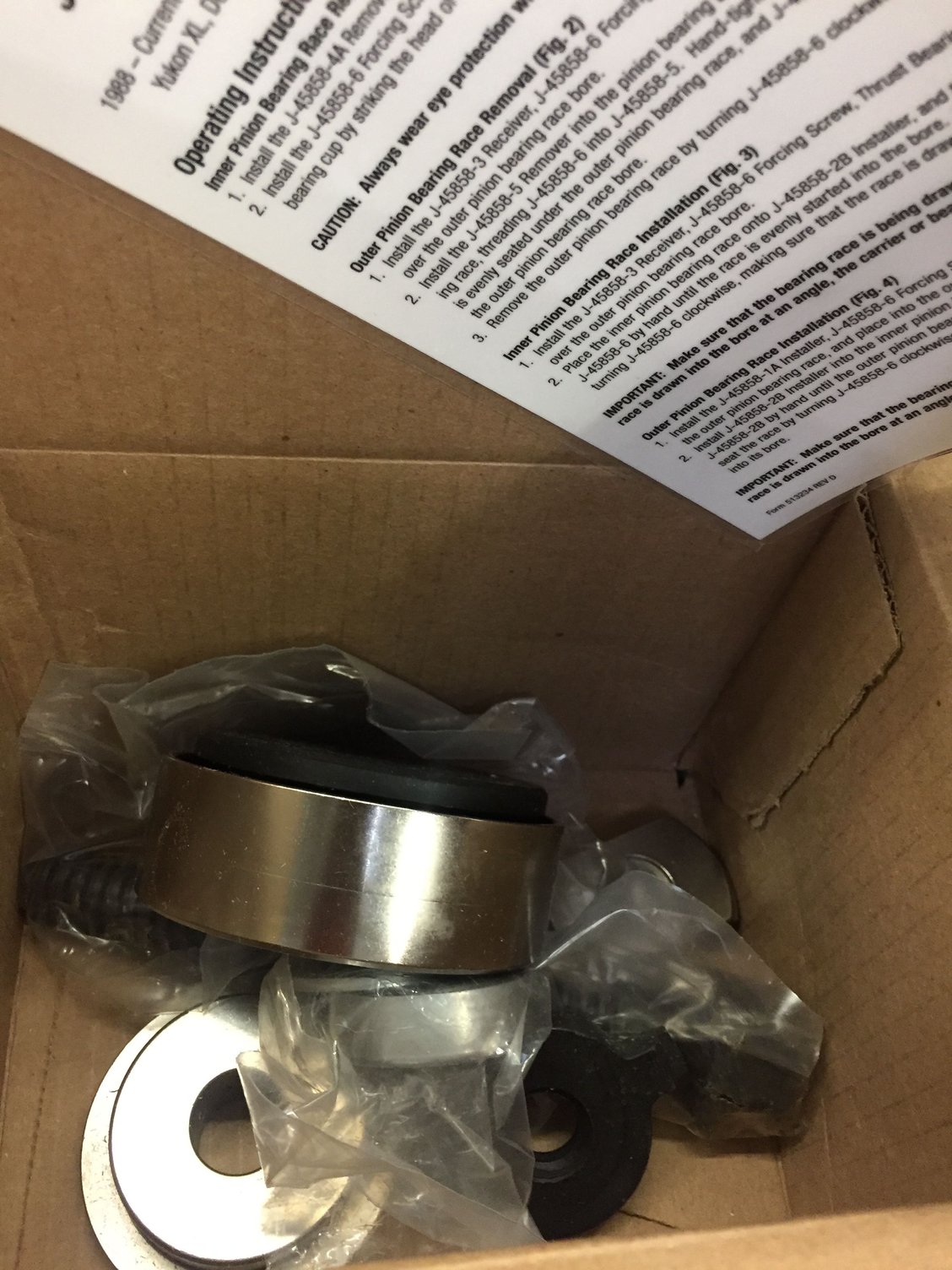

Been busy as hell with work, this ridiculously expensive holiday and everything else, however i did get a few tools to help with the front diff bearing swap i really need to find time to get to sooner than later....
Adjuster for side bearing shims
Pinion bearing remover/installer for gm 8.25....

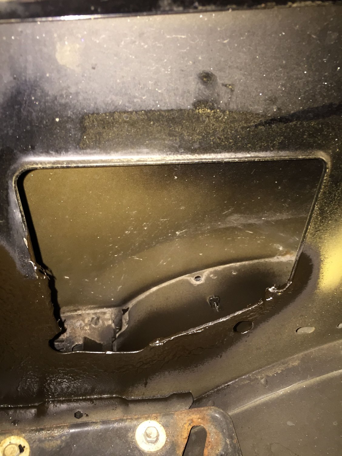

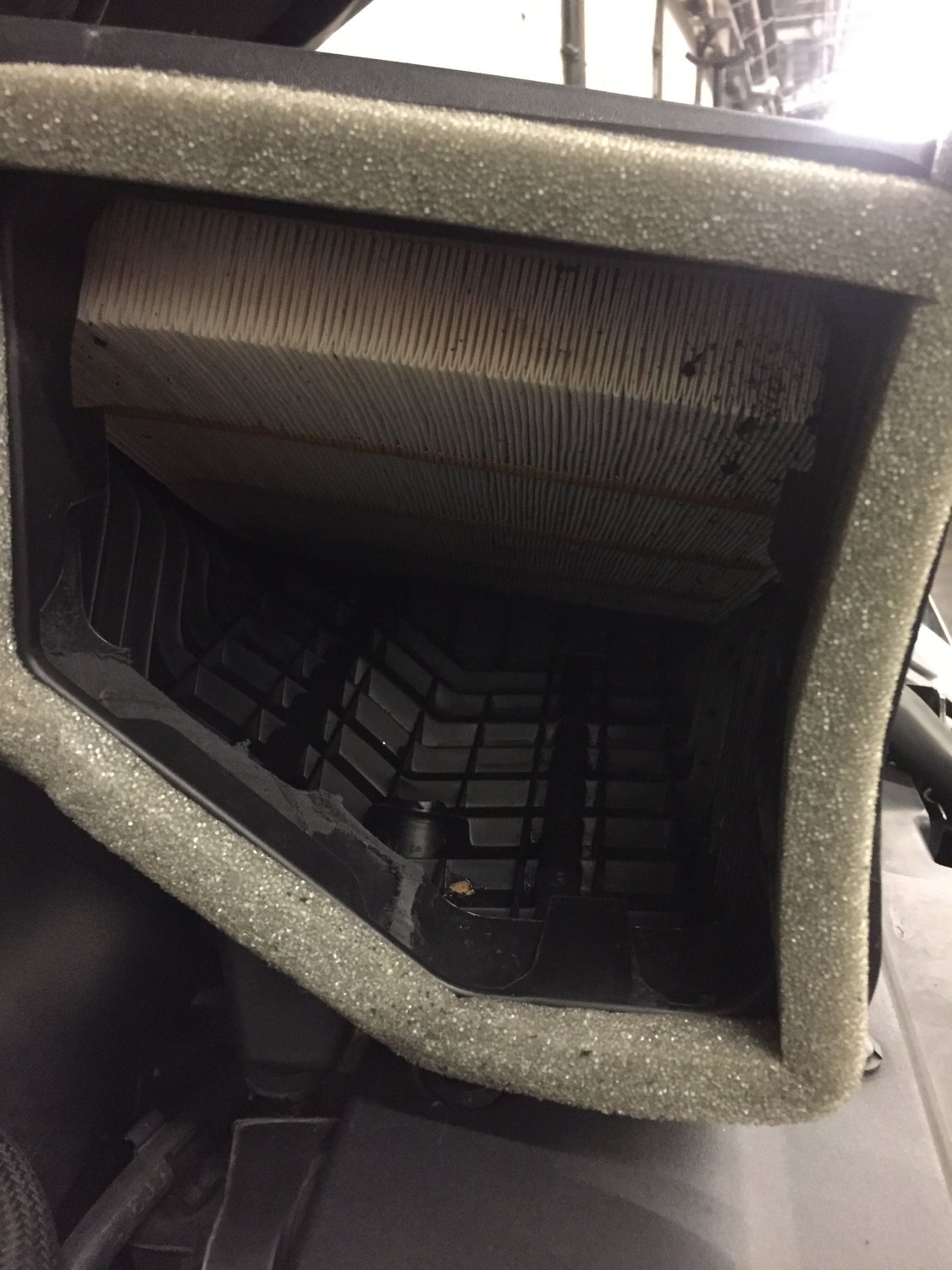

Had a headlight go out on me ... So i had to change one of my headlights today and ended up just going ahead and changing both of them, which meant rather than pulling the front fascia completely off i had to pull the air box out, so i went ahead and did the air box mod to open it up a little, not sure it really makes a differemce but i did it anyway.....
Airbox and fender mod done....

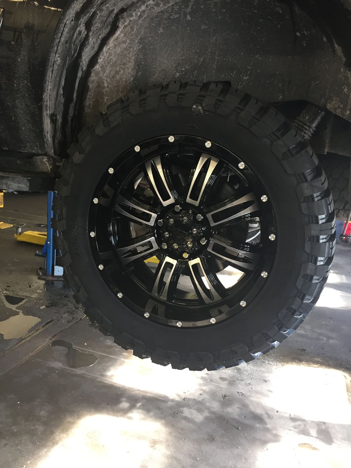

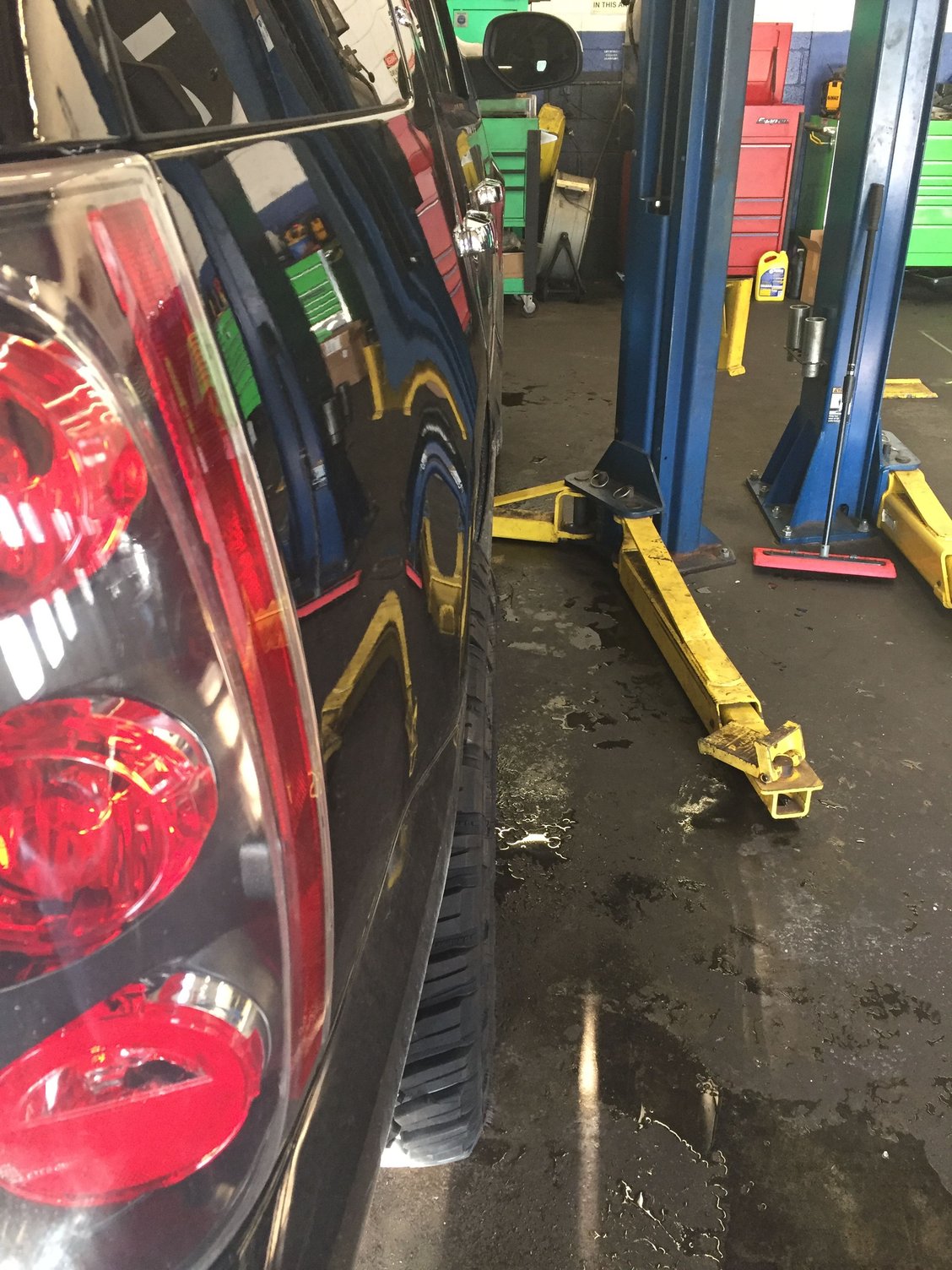

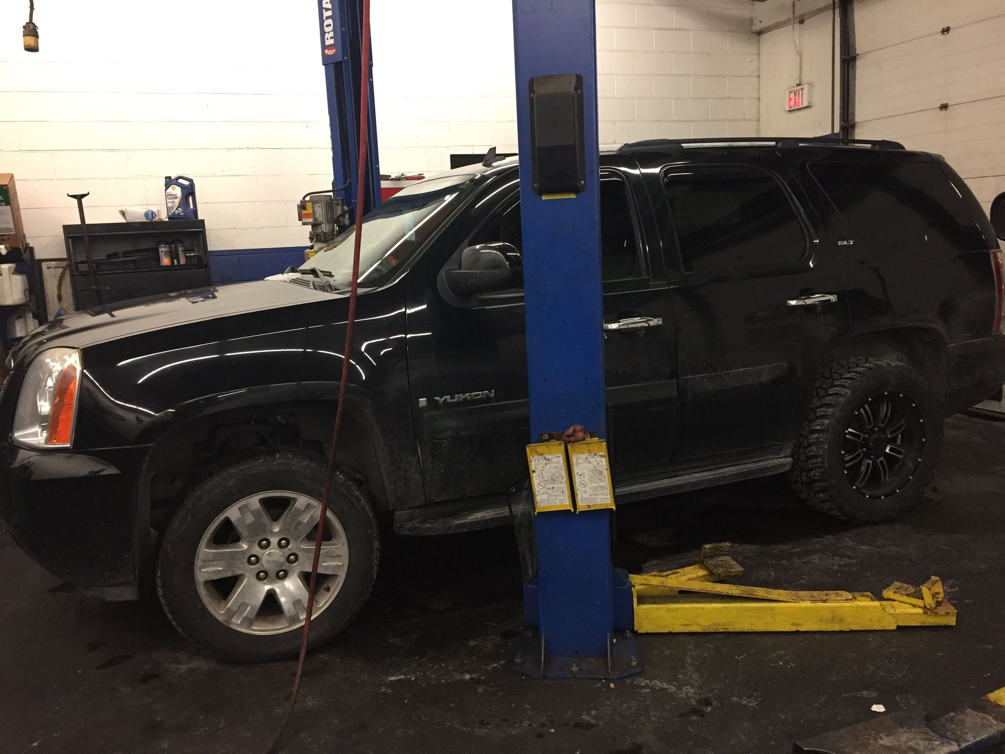

As much as i liked the factory wheels, i wanted a different look and some meaty tires, and after the flood i have decided a lift is eventually in order...
General grabber x3s in 295/55r20
The wheels have a +15 offset which works out to something close to 5.6" backspacing, puts them right about flush with the fender lips!!!
Mounted the rear tires first, ran out of time to get the leveling kit on the front..., new tires were awesome in the snow and ice we got this weekend

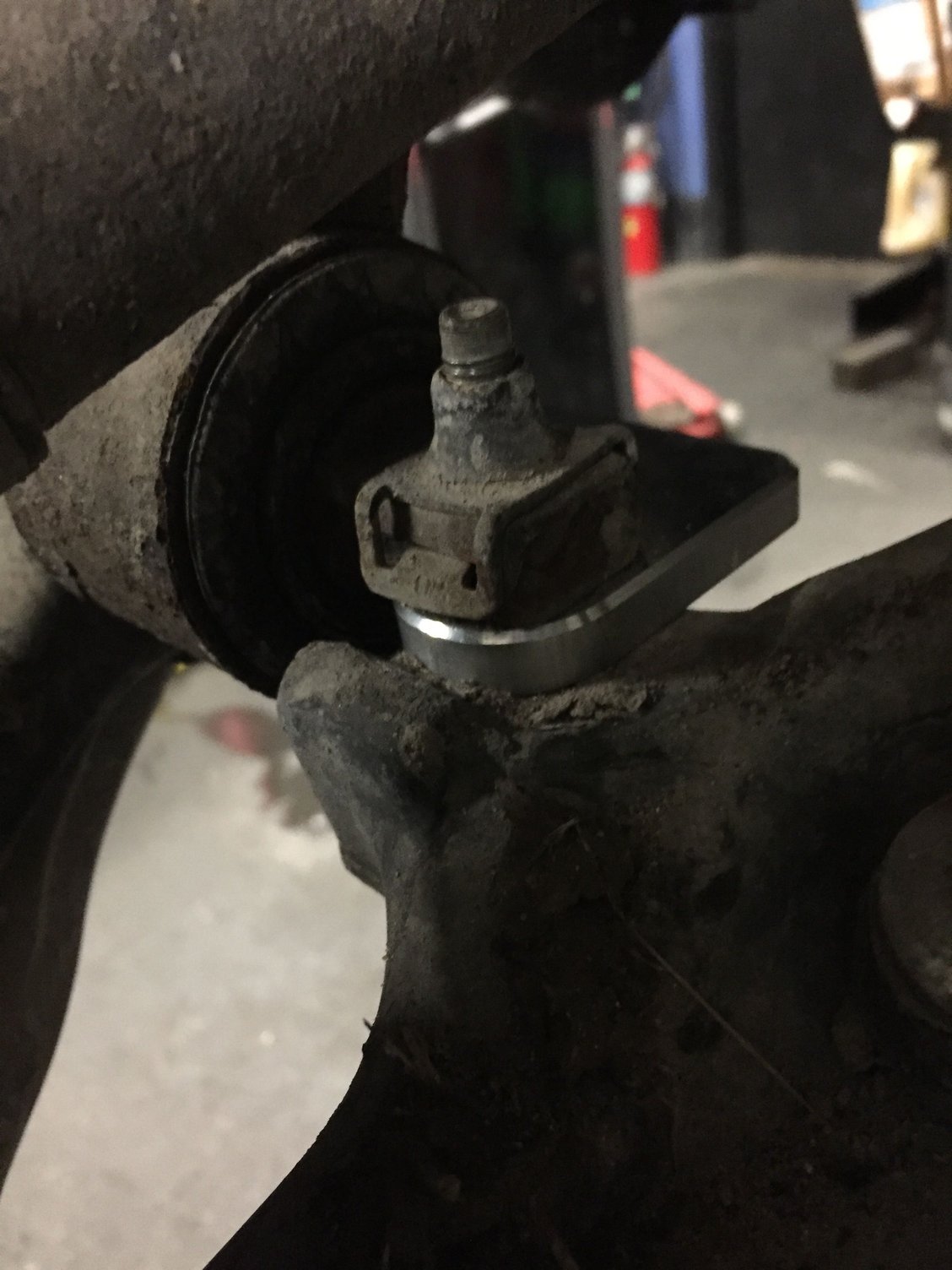

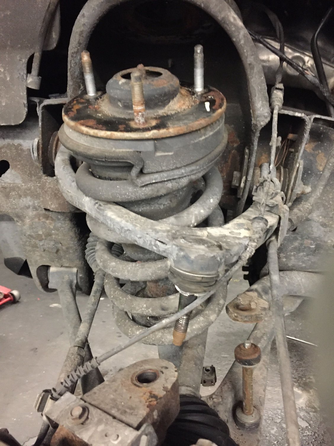

Got around to getting the leveling kit put in earlier this evening, front tires will be on tomorrow evening... loosened the upper strut mounts first...

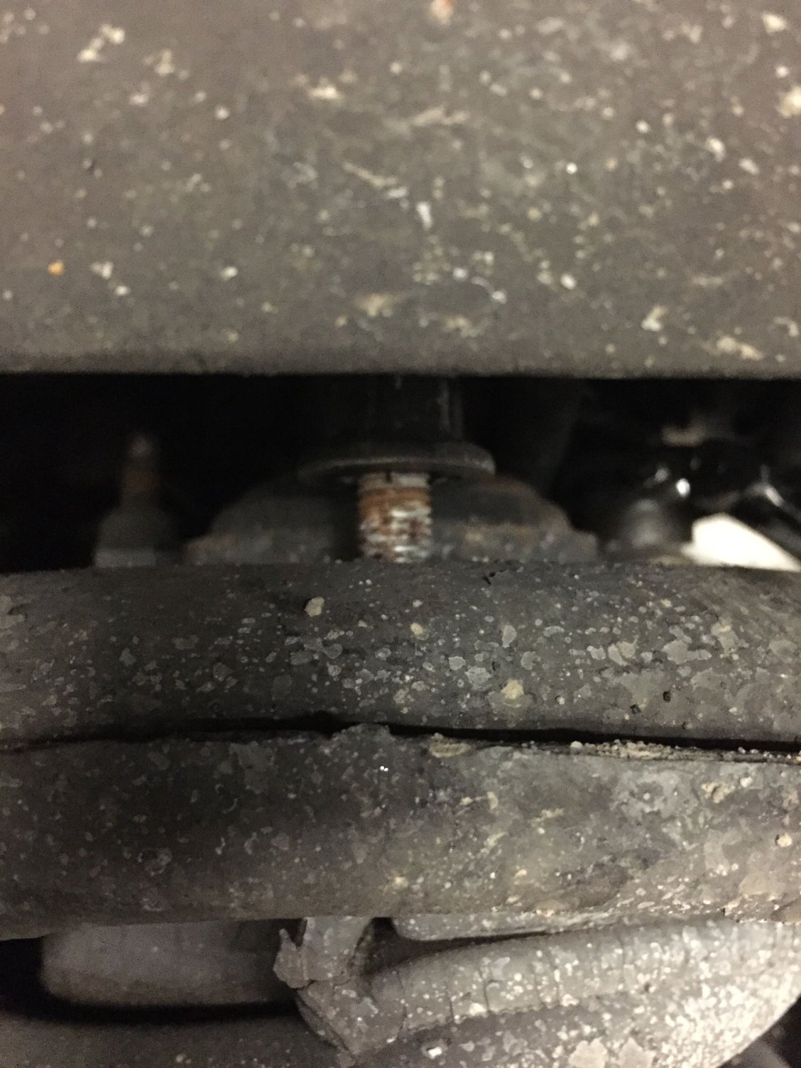

Unbolted the sway bar links...
Unbolted the lower strut mount...

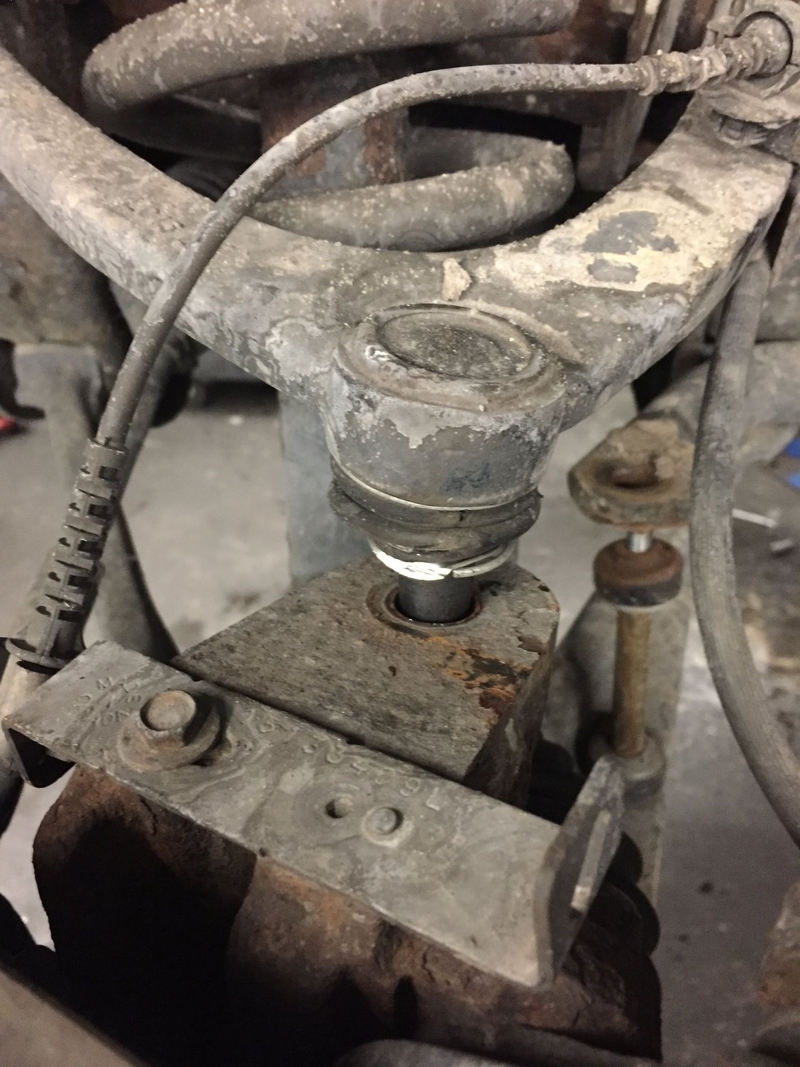

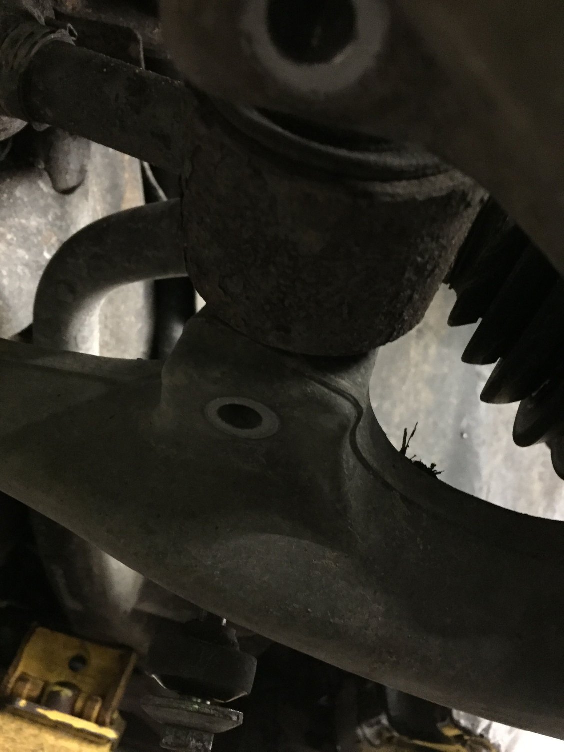

Knocked upper ball joint loose...

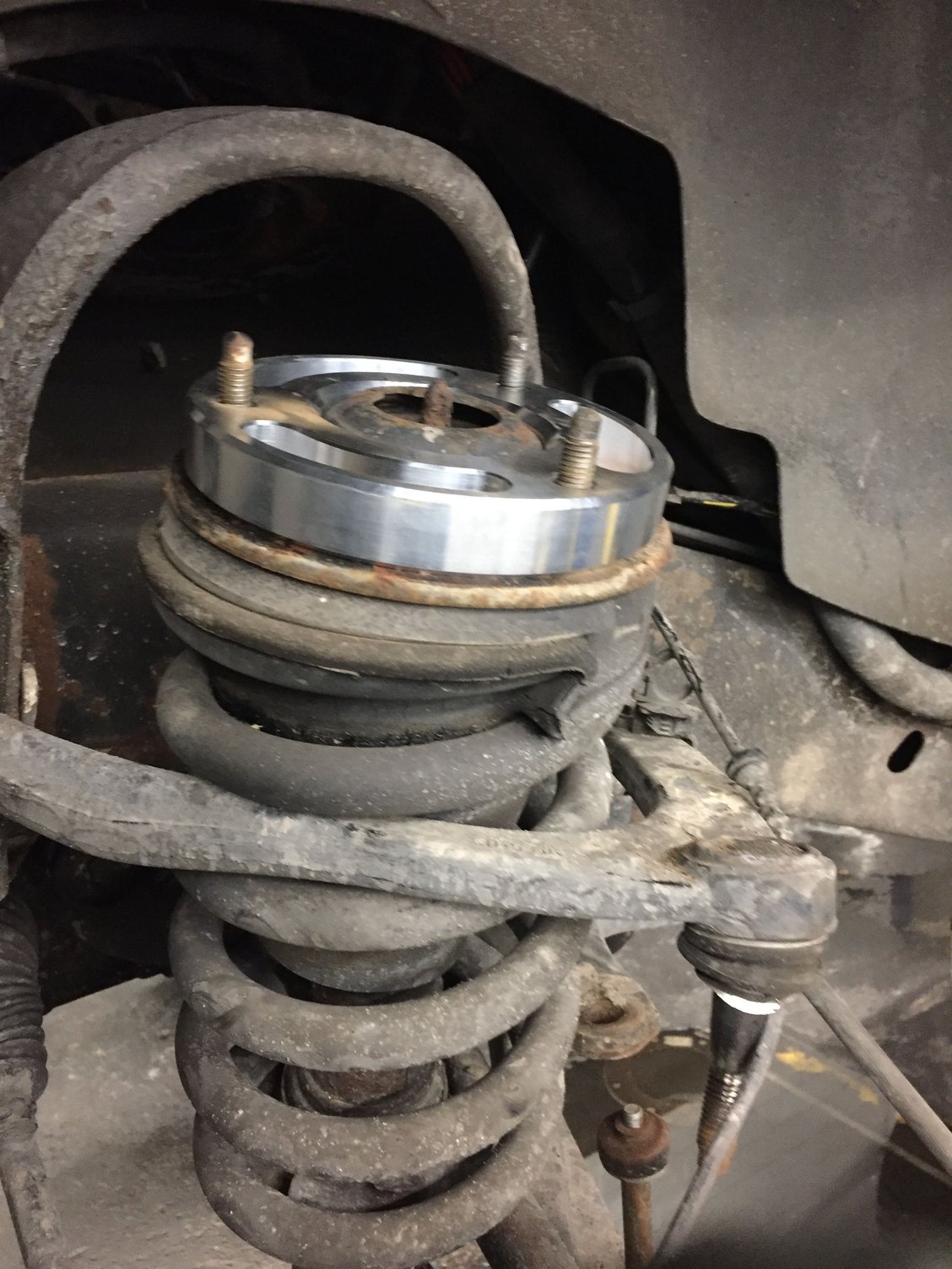

Dropped the strut down enough to install the upper spacer...

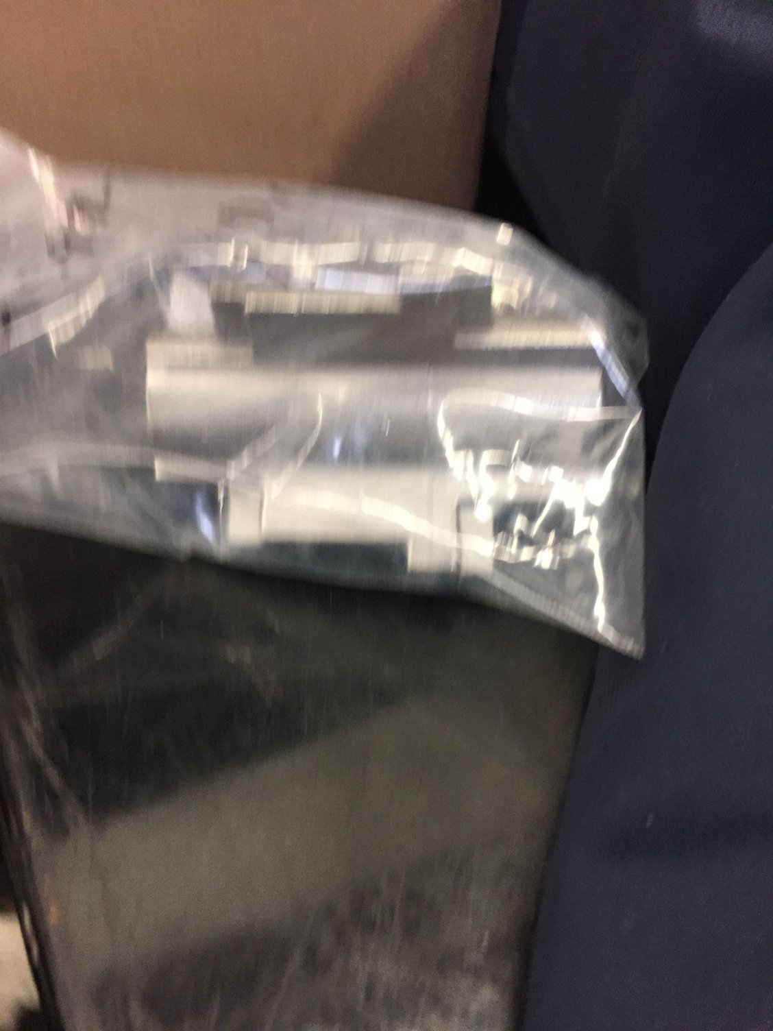

Installed the upper spacer...

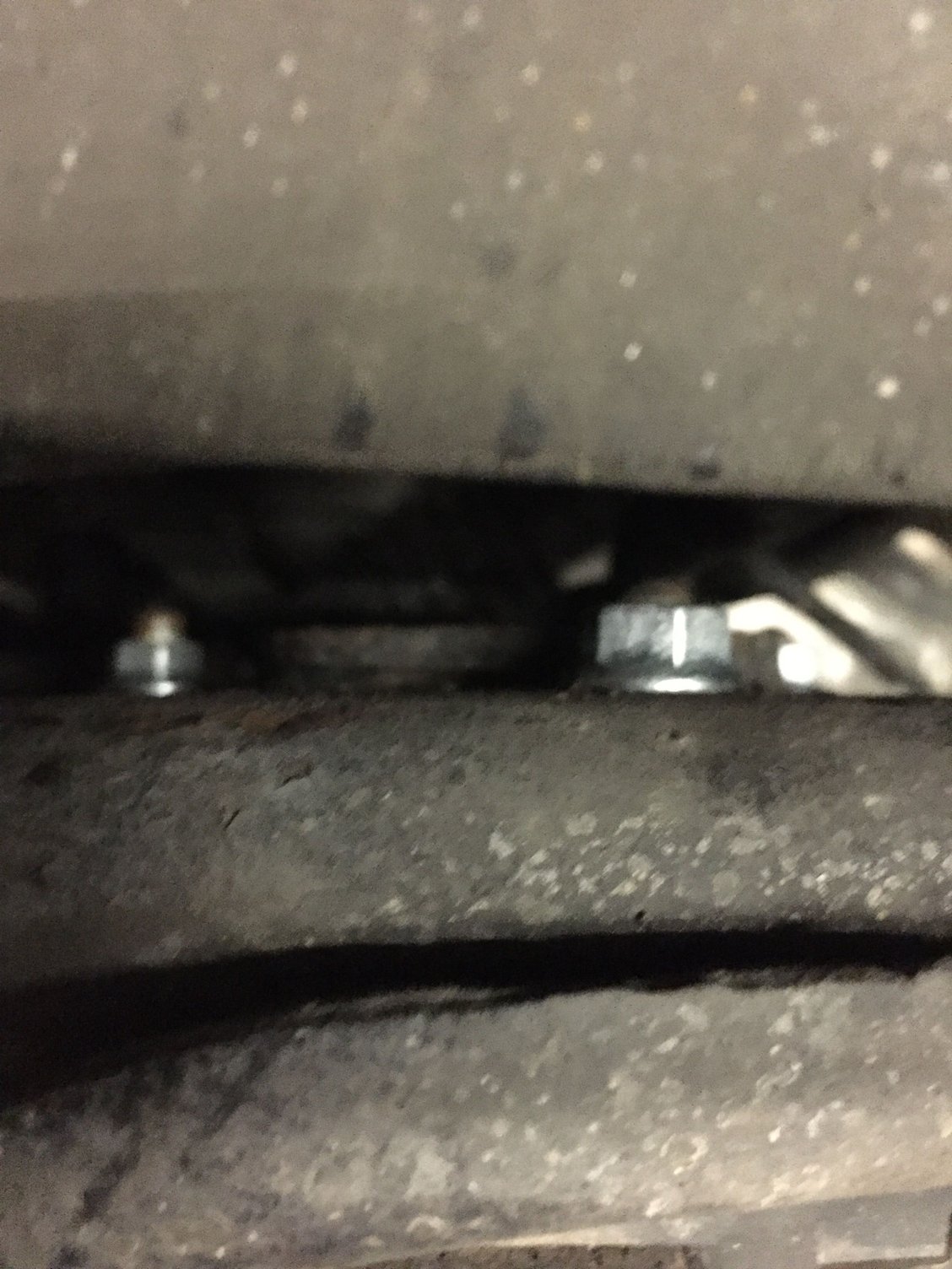

Started the supplied nuts..kept the factpry nuts for the full lift.
Started the lower bolts through the lower spacer....
Tightened the lower bolts.... along with tighteneing the upper nuts, reinstalling the ball joint, sway bar link, and put wheels back on...
...and, the truck is now level, this is just temporary until i can get a full 6" lift...
And my quick 15 minute alignment after i was finished just to get it home... really want to increase the caster a little bit and bring the camber to about .5 on both sides... the factory tires were wearing on the outer edges... especially the right front... but the only adjustment i had really needed to make was the right toe which ended up at +0.90

Yes, the new x3s, only downside is weight and fact they only come in E load range, but for a mud tire they ride really well and arent very loud... i had no issues on the skating rink they called roads last week!
