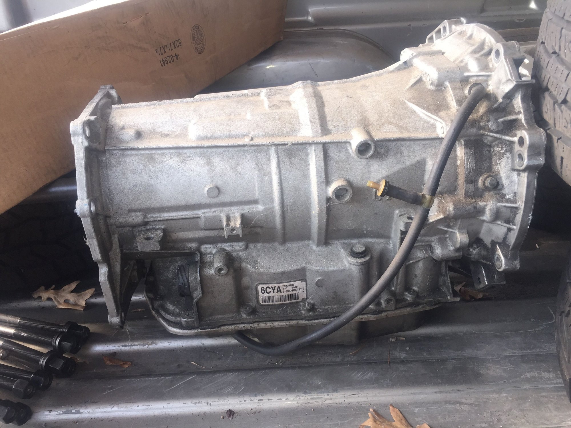

6l80 came in, out of a vette, dude said it was blown, was expecting to not be able to turn the output shaft, or if i could it feel for, lack of a better word, chunky; but it turns.... Quite smoothly i might add!!!Didnt have a chance to open her up tonight, but hope to sometime later this week or early next.... Figure iut what i need for it along witha list of what i need to convert it to a 4wd, and mate it to my t case.... Want to finish my other little headache of the moment first.... One transmission problem at a time....

Havent been able to tear 6l80 down, however i do have a bellhousing, pump and 3-5-r drum, out of a 13 caprice, so the pump has the newer style stator and i am fairly certain the 3-5-r drum came out of the same car and was replaced as a unit because the parts guys figured out it was cheaper under warranty to replace the assembly than the individual parts within.... Now to find output shaft and tailshaft adaptor and to figure out what i need to do about transfer case input..... The yukon has a bw t case, im sure they used in later trucks/suv with 6l80 just need to verify!! I know the output shaft will be a 32 spline....

After some research, and i dont know why I kept thinking the tcase is bw, but this its not a bw t case its MP3023.... And i need an input for it out of a hybrid or a 6l80 equipped truck/suv....just need to make sure my transfer case hadnt been replaced with a 2nd design tcase before i order the input for it!! Also remembered i have two 6l80 harnesses one out of the denali the l92 came out of and the other out of a 2011 pickup.... Need to take time to lay them out and see which one has the t case plug i need.... Both vehicle had vvt but the truck harness was a 5.3 that had vvt and afm!! Now to get the hard parts and a rebuild kit and find the time to test the tcm in this trans and get all of my engine parts back together.... i need like a month off, with pay!!!

I looked at the 6l80 today.... Thats about as far as i got!!!
