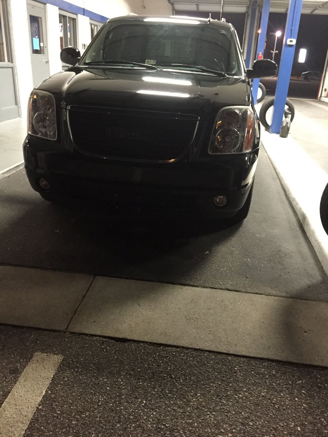

This is the yukon i traded my 13 ccsb in on.... It is the kid carrier/road trip vehicle so probably not going to go too nuts on it some little mild stuff here and there as time and money permit.....
The night i test drove it and sign paperwork

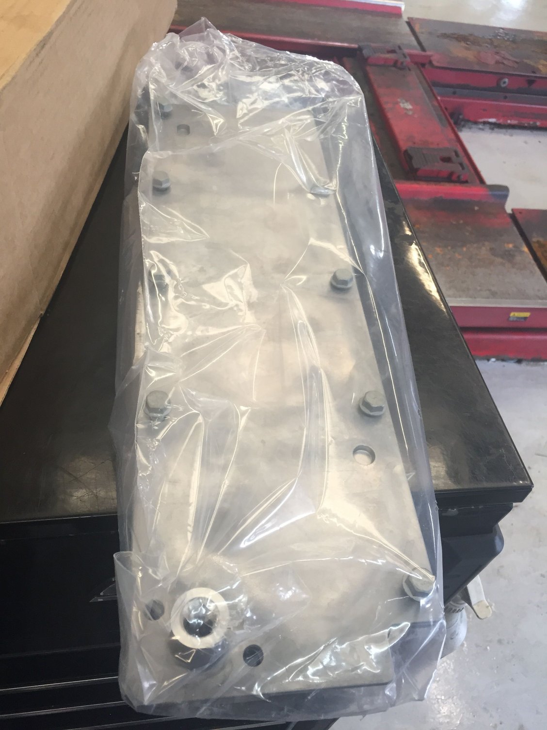

The parts gathering has begun!!! My first purchases towards dod delete....
Lifter trays, have 4 didnt see point in taking individual pics....$27.54 for the set
Non dod valley cover $34
