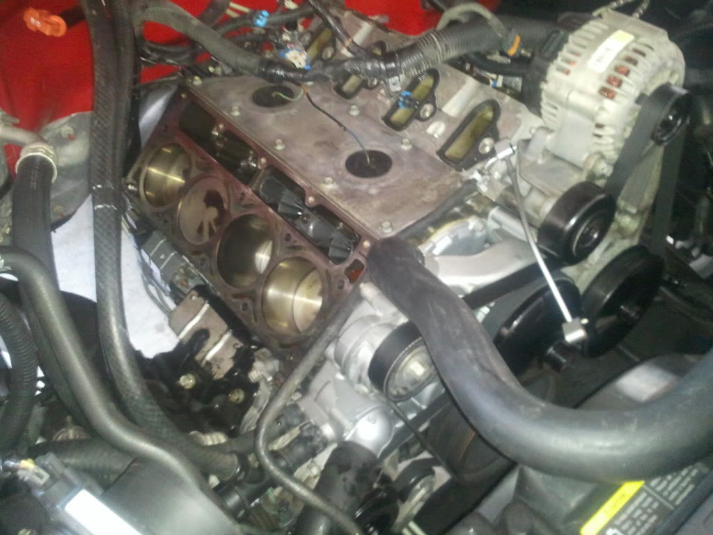

When I got the exhaust installed on my truck I realized I had a issue. I got a lifter that had a manufacturing flaw. It didn't have a oil pressure hole drilled in it. Disregard what I said in my first post about running LS7 lifters because I was gonna run those but later changed my mind to run the (unnamed)Company's I currently am. These are supposed to be the best Hydraulic roller lifter out right now. It must have slipped by their quality control. Oh well, I guess....
(On a side note the supplier treated me very well and supplied all needed parts)
It's been all back together for several days now but I've been down and out with the flu.
