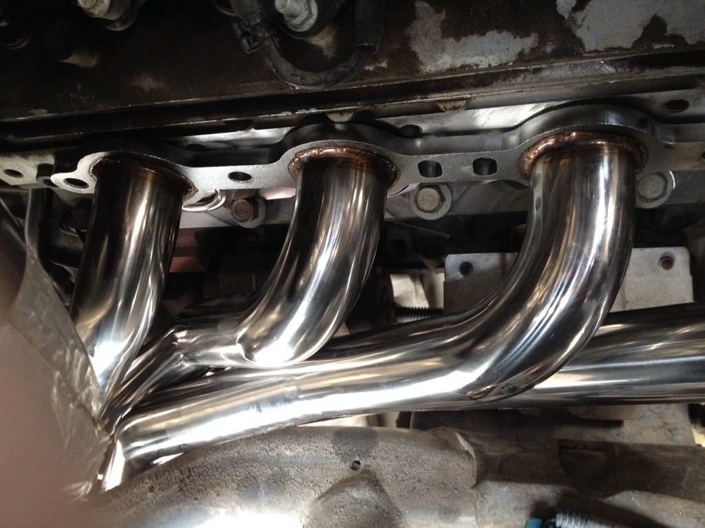

I just installed my headers this weekend on my 2003 silverado RCSB 5.3l 4l60e 2wd. I had fitment issues on my passenger side headers. The headers would not mount up flush without modification to the tubing. The frame is not bent and the motor mounts are not broken. Initially the fitment issues were really bad, but this was due to the transmission resting down further than normal. To get the original y pipe out ( and install new y pipe) the transmission cross member needs to be removed and the transmission held up . We held the transmission up with a floor jack and overnight it must have dropped an inch or two. This made the header fitment really bad, after noticing the transmission was low, we jacked it up (actually higher than if it where sitting on the cross member) and we still had header fitment issues. Ended up flattening out , unfortunately , one of the pipes that was hitting the frame. I originally posted this in their sales thread but I was asked to remove the post , so I removed it and posted this here.
This picture was before jacking the transmission up where it should have been, so this is exaggerating the issue a bit, but like I said, even after lifting the transmission up , the header still contacted the frame enough to not allow flush mount of the header flange to heads. I will try and post pictures of the headers installed.

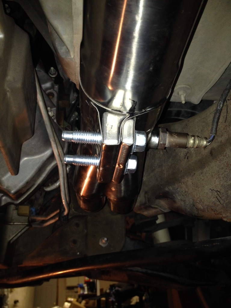

If you are using the supplied bolts that come with these headers - please use a washer. The holes ( at least in the center of the header flange) are too big for the supplied bolts. I was torquing the center bolt and it started to cut into the flange , luckily i was able to back it out and bought some grade 8 washers (along with new header bolts) and used these on each of the 12 header bolts (the new ones i just purchased) just to make sure that did not happen again..
New passenger 02 sensor location works and no clearance issues , I am hoping the angle is enough to not cause condensation issues with the sensor...
Y pipe runs right along the front of the transmission cross member running right underneath the back end of the transmission pan. It does not touch but it is very very close

Your mounts are sagging bud.
And should have know not to use those bolts. You knew to get better clamps..
Loosen your trans crossmember. Use a jack to lift it as high as it will go then torque the cross member bolts back down.
You will gain cross over pip to pan clearance.

I did not know to not use those bolts, I never saw anything online telling me otherwise . I did however see some information on how the supplied clamps are not the best , so I got band clamps instead.
That is a good idea with the cross memeber, I will have to try that and maybe gain another 1/8" or so.
Look closely at your mounts, and you might see the inner and outer shells touching..
Will be very easy to determine by eyeballing, then jacking up the engine and eyeballing again.
I've only ever had "good header" frame clearance issues when I had sagging mounts.
Can't say 100% that's your prob, but, just a long term observation.

The speed engineering headers rubbed with old mounts and new mounts on my buddy's VMax truck. Take it for what it's worth. Get the torch out, heat them up and bend them a little.

No heating or modification should be needed with our headers. I was emailing zblee over the weekend about the motor mount issue, but I guess didn't believe me lol. We have seen one other case that I am aware of where the header hit the passenger side frame rail, and it was fixed with a motor mount swap.
JohnDaMan: Were the headers you installed our 1 7/8" 99-06? If so our first batch of those were closer than usual to the passenger side frame rail. They have since been pushed in approx 3/8" of an inch to help with clearance. Our 1 3/4" shouldn't have any clearance issues however. We have sold a bunch of those without any complaints, and no modifications have been needed besides the O2 Bung location. Which, has also been fixed in this current batch.
