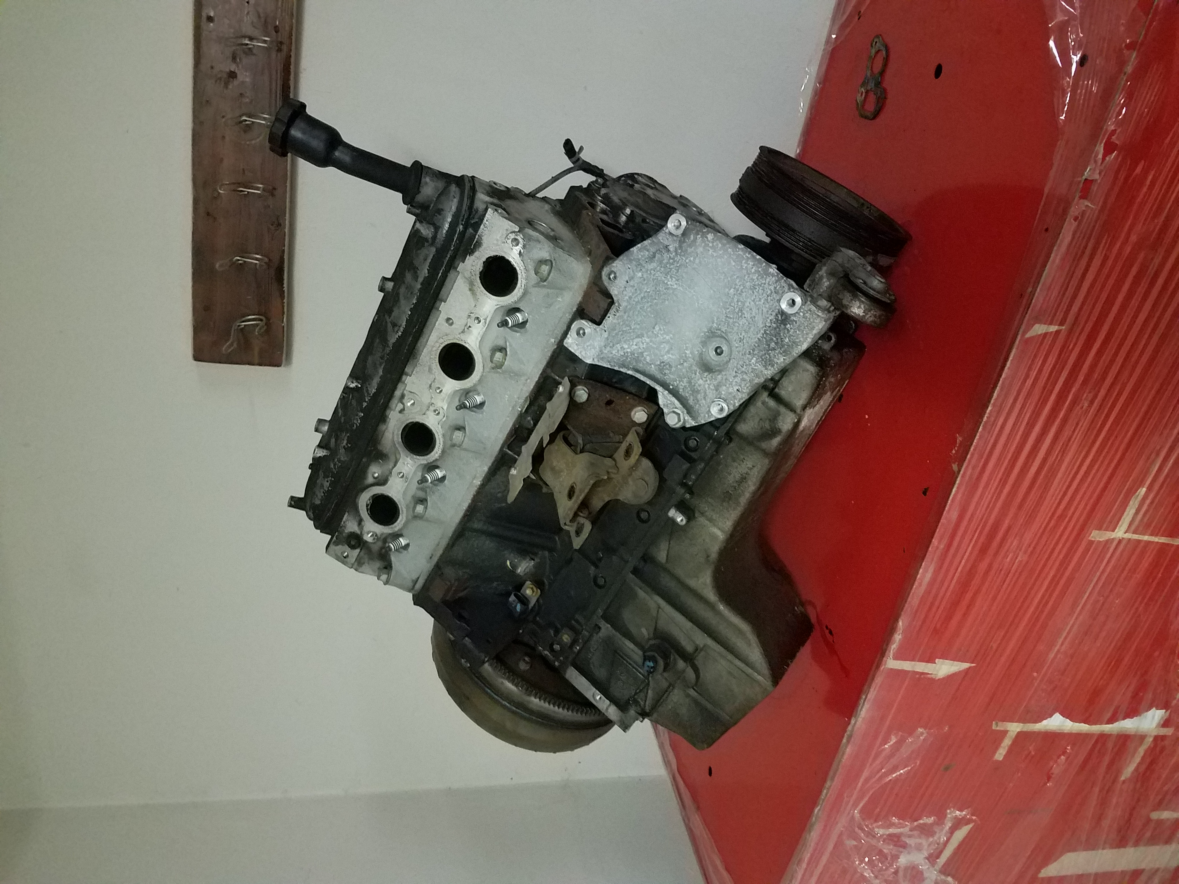

Finally getting around to my truck build after the bike build last year and my big x-country move. First off sorry i havent been around. Mainly due to moving. (Still seting up the garage.) Truck started as a 00 S10 Xtreme with a 2.2. Daily driven until the tranny gave out on me. Last year the motor was pulled as was the motor and interior. Last weekend i found myself in the junkyard yanking a motor from a tahoe. Ended up with a LM7. Plans are to rebuild and turbo the motor. Can use some help with info. Judging by what i found it is a 24x reluctor ring motor. Almost done with the teardown. Waiting for a few things. Will try posting pictures when i get on my computer.

I highly suggest buying some better connecting rods if that LM7 is an early engine, they shouldn't be pushed much past 500-550hp because the rods are weaker.
Buy some GEN 4 rods that are thicker or get some aftermarket rods if you plan to push this motor.

I wouldn't say you have to go forged, just find some GEN 4 rods on like 04.5+ motors and swap them in. Those are good for over 800hp and the pistons are fine so long as the tune is good like always.
Or just find some aftermarket connecting rods and stock size forged pistons and slap it to together. Increase the ring gap for boost (on either plan) and call it good. You'll find that even at 500-600hp you will be on struggle street for traction and just shredding tires.

It will be stock sized, that i know. I may see if i can find 04.5+ pistons and rods. If not i would like to forge and balance everything.

From what i can tell it was a 02 tahoe. Thought i was lucky and found the LQ series motor i was looking for.
