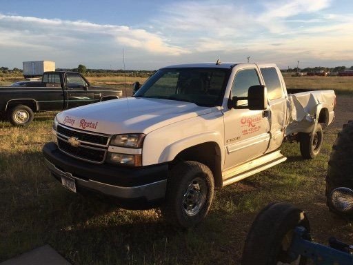

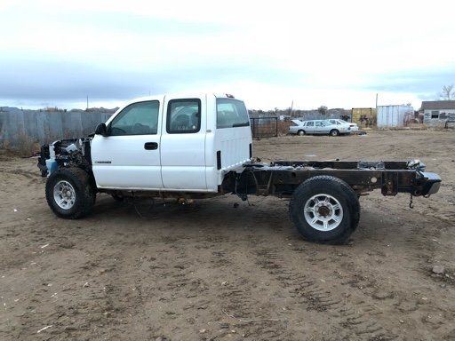

Wrecked rental truck with 200,000+ miles
Box off
Cab off

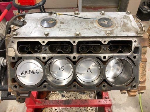

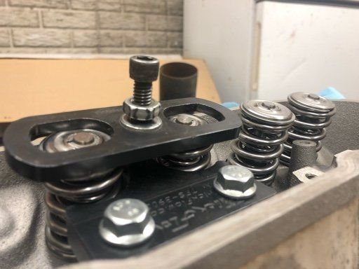

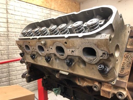

Gapping rings
Loose as a goose
tools of the trade
neat
sponge boi reference lol
studded
Studs are kind of a pain in the ***.
happy little pistons

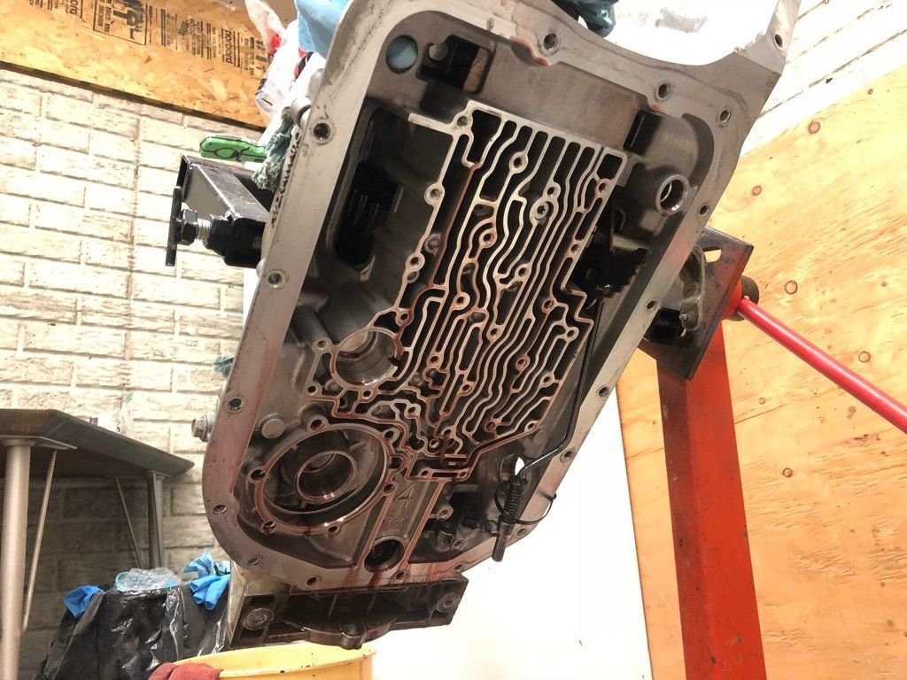

Went to pull tranny and t-case and found the start of crack in the t-case adapter. Also somebody used standard thread bolts and impacted them in the bottom of adapter to the trans mount. Going to get a different adapter, don’t want to chance this one breaking. Wish they made a billet one but couldn’t find anything online.
Lifting out the beast. (Fairmont, Volvo 960 & 245 hiding in the back) I am considering cheaping out and getting Jakes “trick kit” and recalibration kit. I am reevaluating my goals and I think I going to try and make it a bit more streetrable. The $1000 I’d save over the stage 4 will help me get Terminator X and get it running sooner. If it breaks something transmission related I can just address that later. More worried about U-joints at this point.

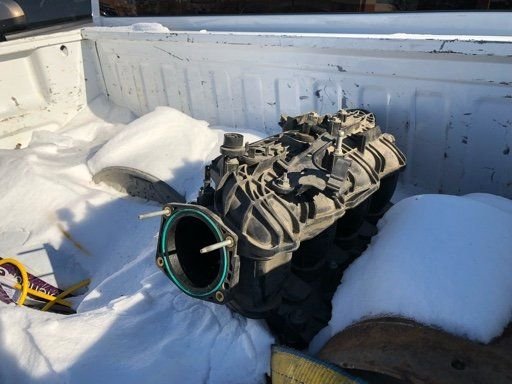

Just mocked up for the time being. Need to make a special junkyard trip to find 12mm cab bolts and a breadbox intake. Tried spraying a valve cover white but it looked like **** so I took it off and polished it up.
Specs: 226/231 Intake: .605. Exhaust: .598 LSA: 113°
Size reference for a S475. Weighs about 60 lbs.
I got half way to work this morning and got a call saying we weren’t working today because of ice. Decided to road trip to the city since I was 1/4 of the way there. Went to my favorite junkyard and found this race intake for $50.

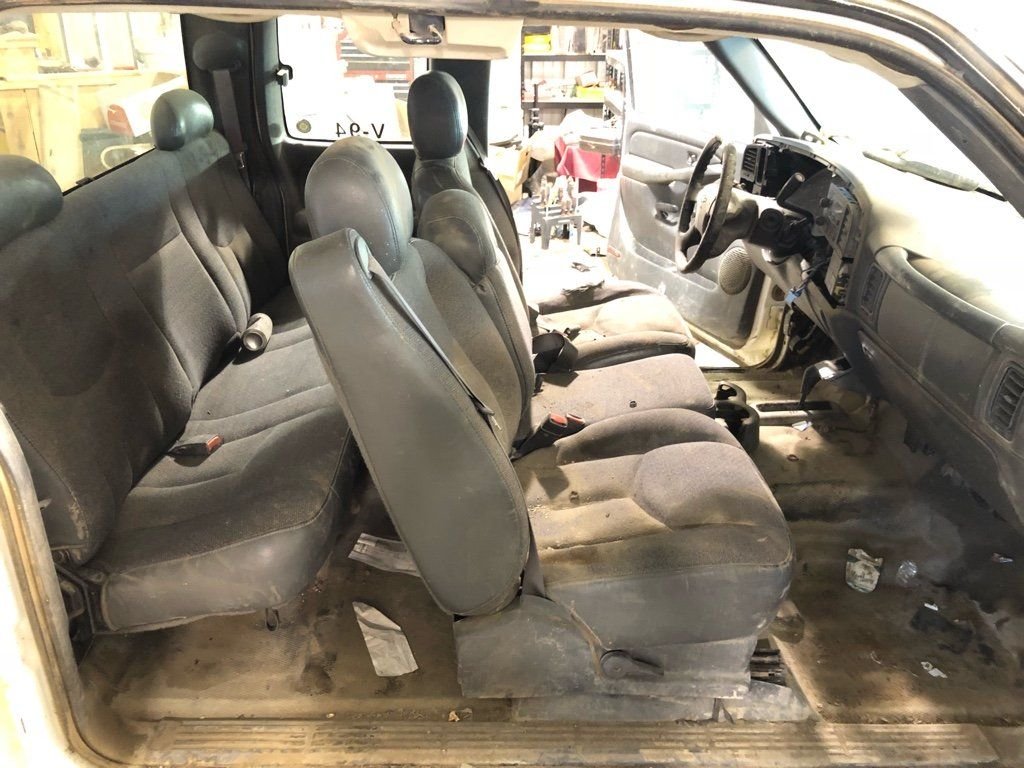

seats out, preparing to swap some interior stuff from the crunched 06' cab

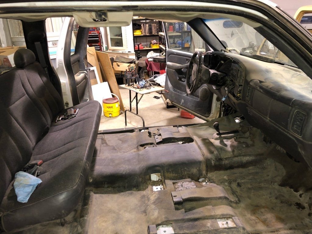

Cleaned the vinyl floor. Decided to fully swap body harness. Really wanted power seat, thermostat, compass, tow mirrors that dim and flash the turn signal. A little above and beyond but whatever. Considering using the stock computer to run gauges and a/c after watching sloppy’s latest video. Matt makes a valid point about freeing up Terminator X’s i/o. I don’t know if I can really hijack the rpm and speedo signals though? seems pretty janky, might have a backfeed or noise? Gonna have to research that.
