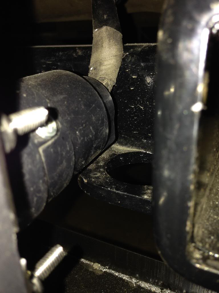

It's the weight of the truck. I could take a picture of the bushing that's on top and show you how it's not compressed. Polyurethane just can't take the abuse. Or, I should say, can barely take the abuse.

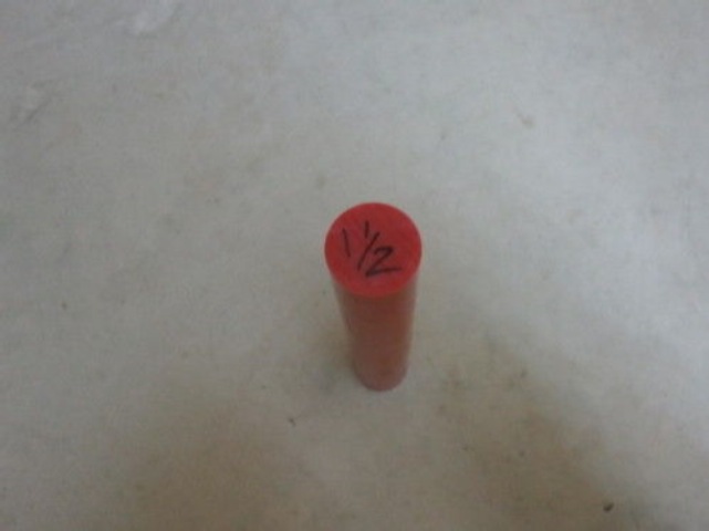

I just ordered some acetal homopolymer to play with. I couldn't find some in bushing form so I ordered a 1 1/4 x 12" roll. I'll cut my own bushings.

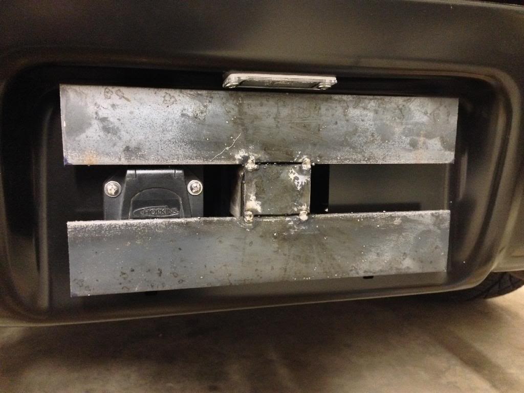

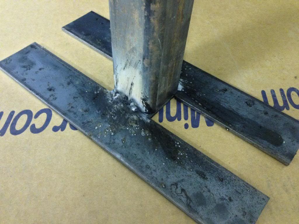

I started building my license plate bracket. It's way overkill. 3/16" thick steel. LOL.
Consequently, my 110 welder can't penetrate it very well. So I did my best to tack it into place. Tomorrow I'll stop by my buddies place and use his 220.

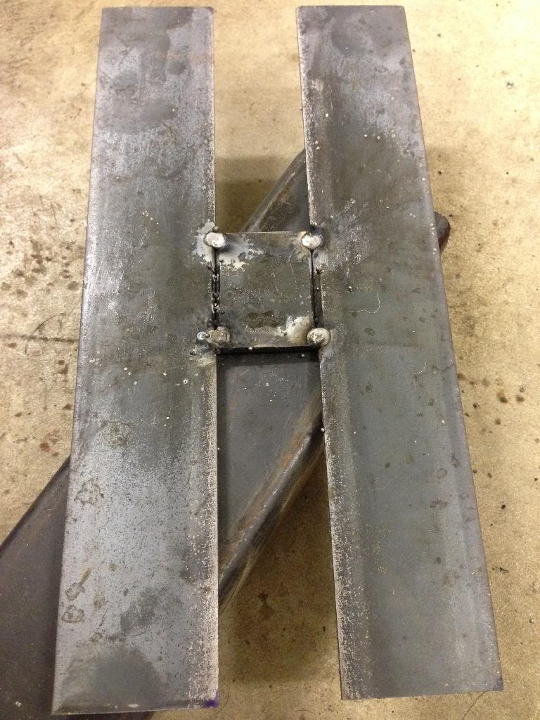

I cut a piece of 2" x 3/16" flat stock into three pieces and welded them together.
I welded the 2" receiver hitch tubing to the H bracket I made.
Like this:
I'm actually going to trim the 7 prong plug lid a bit and also part of the bracket. That way the license plate will sit back in there farther.

At this point I can't recommend the stud mount. I've really thought a lot about this over the last few days. Polyurethane shouldn't really fail like that. Especially with such low miles on them. It makes me wonder if I got a bad batch (Seems unlikely) or, if they made the shock mounts weaker than they would make a body mount. I've seen hockey puck style lift kits for Jeep's that seemed to last just fine. It's really puzzling.
I think a possible solution would be to capture the polyurethane bushing with steel. I may look into this.
After considering it, I don't think Delrin is a good solution. Essentially, when I went with a stud mount design, the bushings are allowing for some movement with suspension travel. With the Procomp adapter and the hiem like bushing mounted in the upper eyelet, it allows for minor movement with the suspension.
Delrin will not allow this. It's too hard and once crushed or conformed, will not bounce back.
Perhaps a solution is to use a derlin spacer below with a polyurhethane bushing above. That may still allow for some movement of the stud mount.
Long story short, I recommend going with the Procomp adapter.

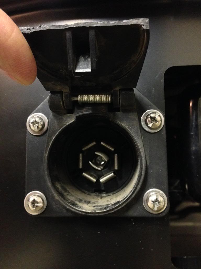

I cut the lid down. I couldn't completely remove it because it has a hook built into it that holds the trailer plug, or 4 prong adapter into the socket.

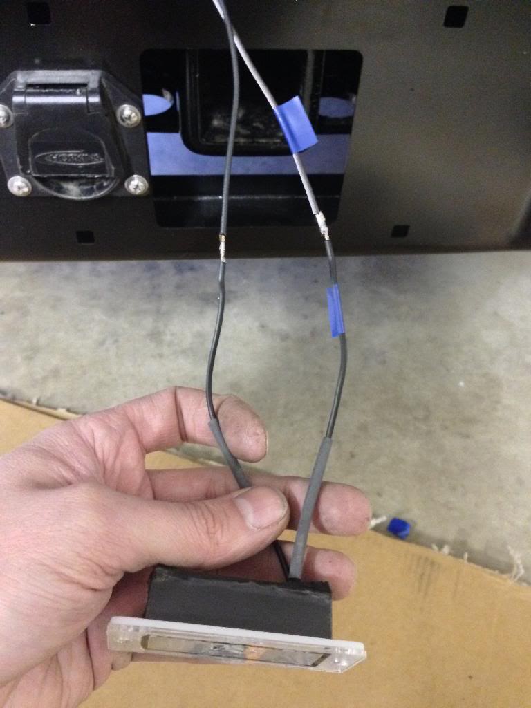

I took apart my factory harness and soldered in my led tail light.
I made sure it worked, and put the wires in the loom.

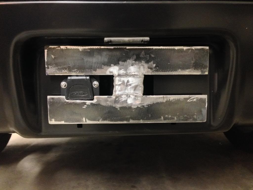

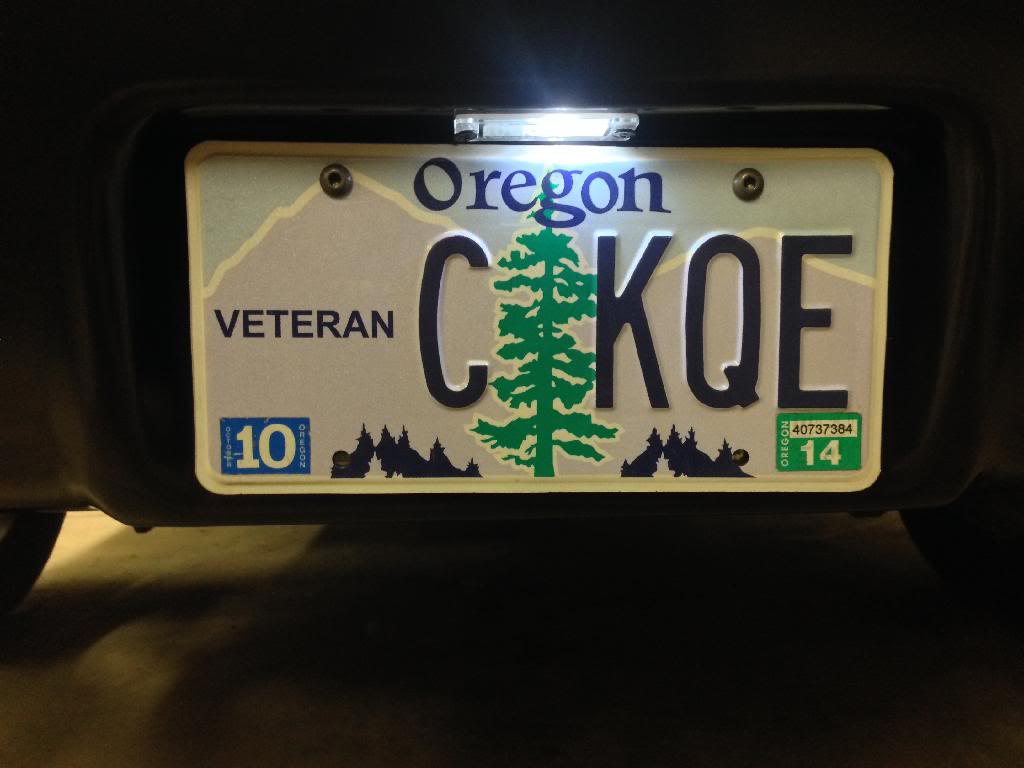

I went over to my buddies house and welded everything solid with his 220 welder. Also, I notched the bracket so it could sit back farther.
I test fitted everything. Looks like it'll work!

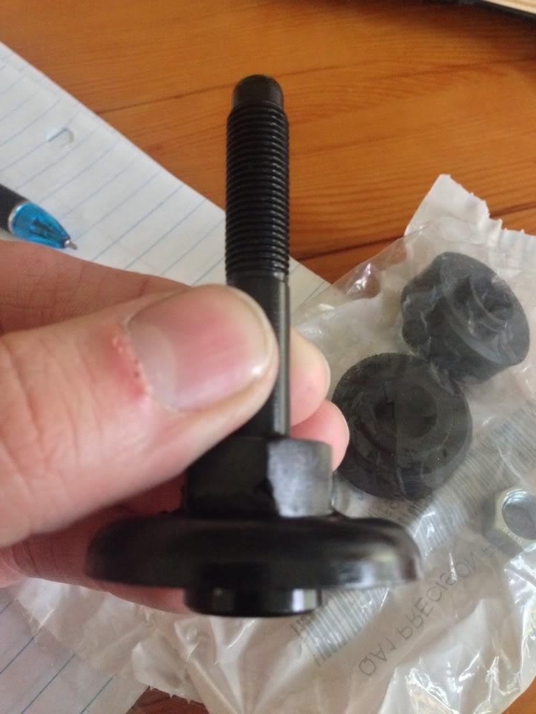

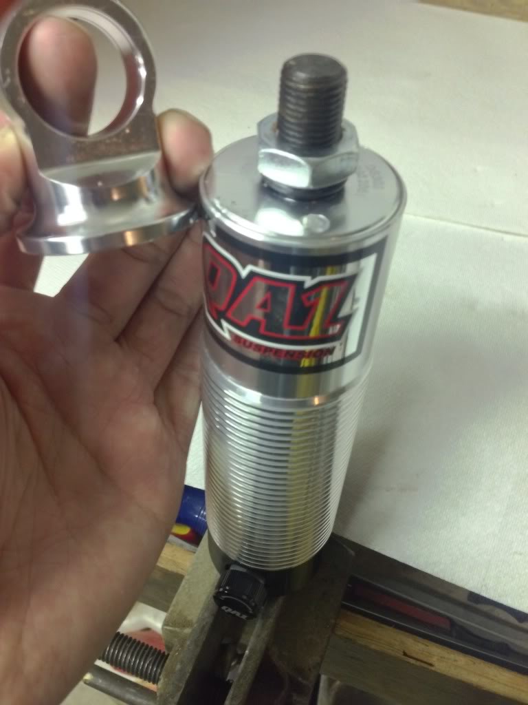

No. I know you keep pushing ridetech, but I'm not unhappy with the QA1's in any way.
My QA1's came with upper eyelets. I swapped to the stud mount.
Here's the adapter:
The removal of the eyelet.
I'm not going with the Procomp adapter because it would add a 1.5" to the ride height. I don't have the room to adjust the Coilovers to make up for the adapter. I ordered a longer coilover and spring to take advantage the stud mount.
I've been researching different compounds that may work for me. I seriously discourage the use of Delrin. That's what's been suggested, but it has zero flexibility. That is not what we need here.
Essentially, the bushings are allowing for upper coilover to pivot with suspension travel. With the Procomp adapter and hiem insert, there's a pivot point. If I replaced the stud mount bushings with something solid, it would eliminate movement and stress the stud adapter.
Through my searching I discovered that polyurethane varies wildly in hardness. I also found a pretty cool resource.
BODYMOUNT BUSHING PAGE
It doesn't really say each bushing's harness rating. Energy suspension won't give out that data. Hell, they won't even give out measurements.
I've researched it pretty hard and found this on eBay:
http://bit.ly/1fNZL1k
This sample has a hardness of 95A. That should be in the range of an aftermarket polyurethane body mount bushing. I've already ordered the Delrin, I'll have to find another use for it.
