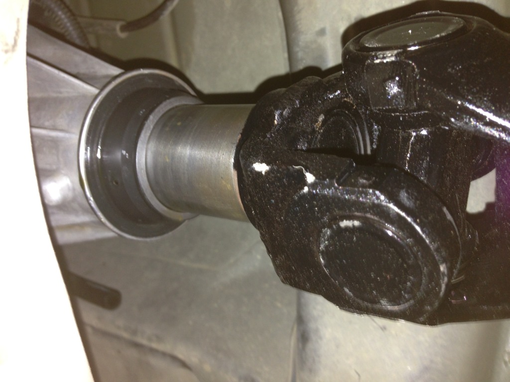

Hey, does this look normal do you guys? I think the driveline guy took out more then I asked him too. There's about 2 inches of shiny in this picture.
The driveline is probably engaged into the transfer case is solid 4 inches, so I'm not too concerned about it.

Originally Posted by iregret
I'm going to spend a couple of weeks reading about tuning. So, if I contact HPtuners and have them do a segment swap instead of the relay mod, does that mean that there are no codes to disable?
Correct, it is that easy...
With that slip yoke, i would like to see it farther in the tcase, but i doubt it will cause any issues as is. Maybe someone else will chime in with firsthand experience on the matter.

Yeah the driveline kind of irks me. Then again, we are only talking about 1/2 an inch.

Is the pic of the yoke while the truck is sitting ont he ground or with it up in the air and the rear suspension hanging. It should be much closer than that if you gave the guy measurements. Mine actually pushes against the dust boot. Mine actually looked too close by the driveshaft shop told me that mine is perfect. You want as much surface contact with the splines as possible.
I get that you want as much contact as possible with the splines but with the truck on the ground, touching the boot would be way to close!
That picture is taken with the truck on jack stands. The jack stands are under the rear axle. So essentially the suspension is compressed.
My driveline is sticking out about 3/4 of an inch farther than it was from the factory. I had them cut off 1" 11/16. It looks as if the cut 1" 15/16 off instead. We'll see if there's any issues in the future.

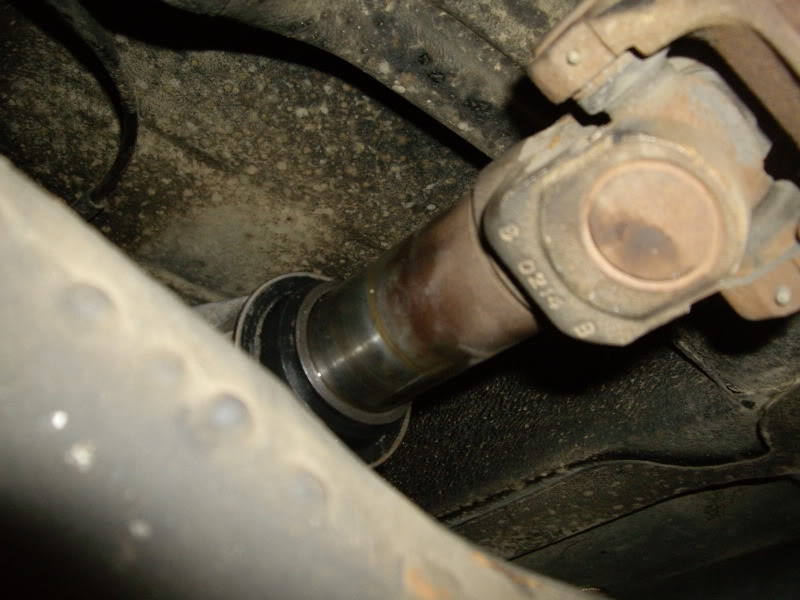

Well I did some searching around looking for driveline pics. I found this one.
Here's how far my driveshaft sticks out.

Here's how far a fellow members sticks out.
I think I'll be okay.

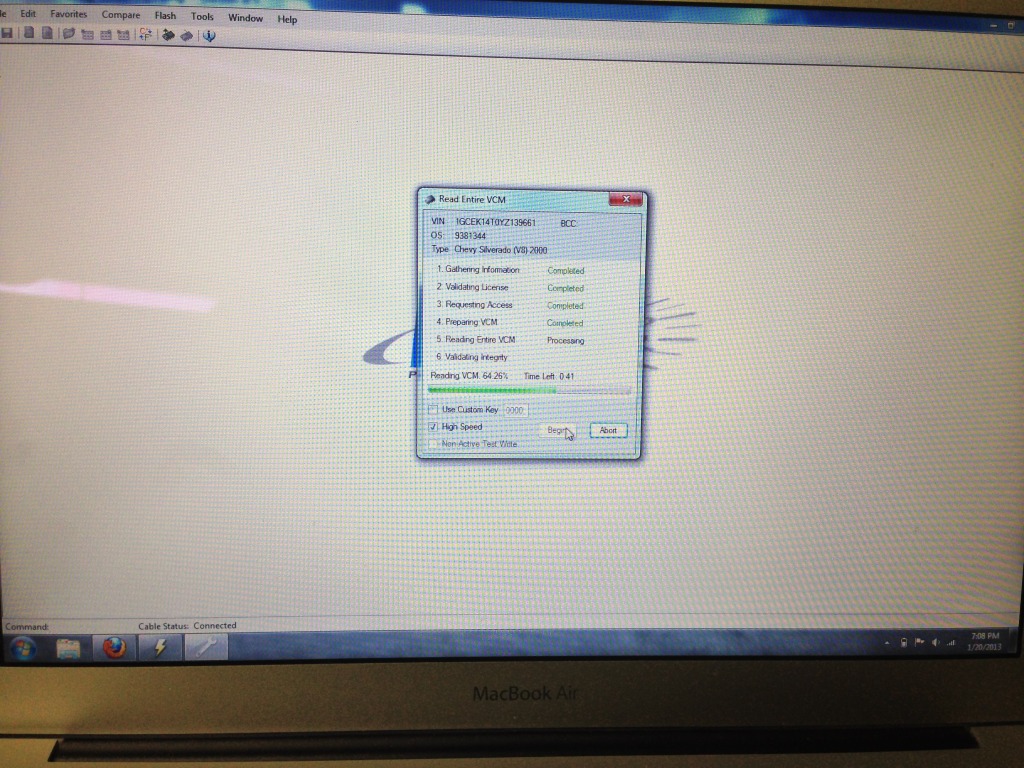

Now, I've been reading a lot about tuning. I downloaded 2.23 and scanned my truck.
This was before I learned how to take a screenshot. LOL.

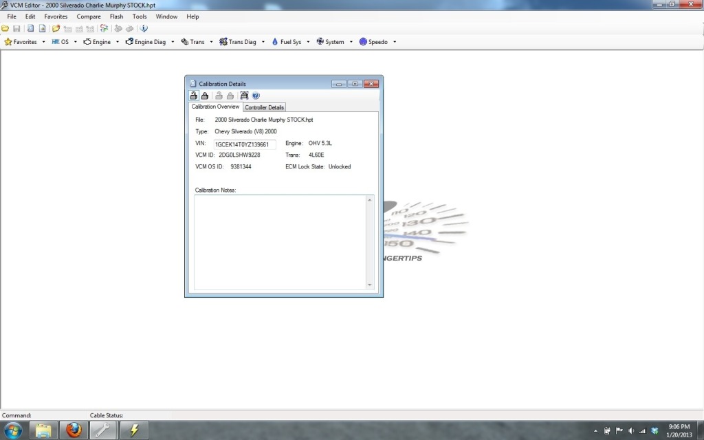

I was told that I need to perform a segment swap to control the 80E. I had planned on using a relay and controlling the 80E with my factory 60E tune. Apparently the latest HPTuners will fix the lockup issue folks were having.
Read about it here:
https://www.performancetrucks.net/fo...tuners-512674/
So I scanned my stock file and looked to find what my OS was.
I also emailed a copy of that file to myself, stored it in my Dropbox and uploaded to to the HPTuners repository.

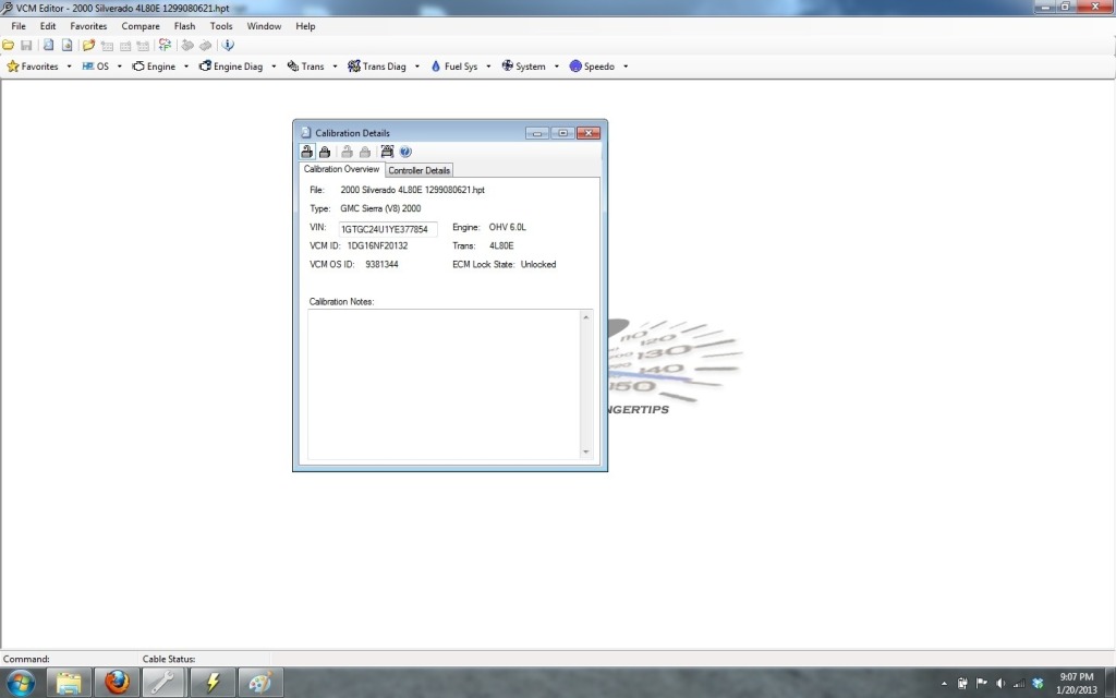

Then I searched for the same year truck except a 6.0L and 4L80E. I checked to make sure that it was the same OS.
Now I'm going to email HPTuners both files and ask for a segment swap.
