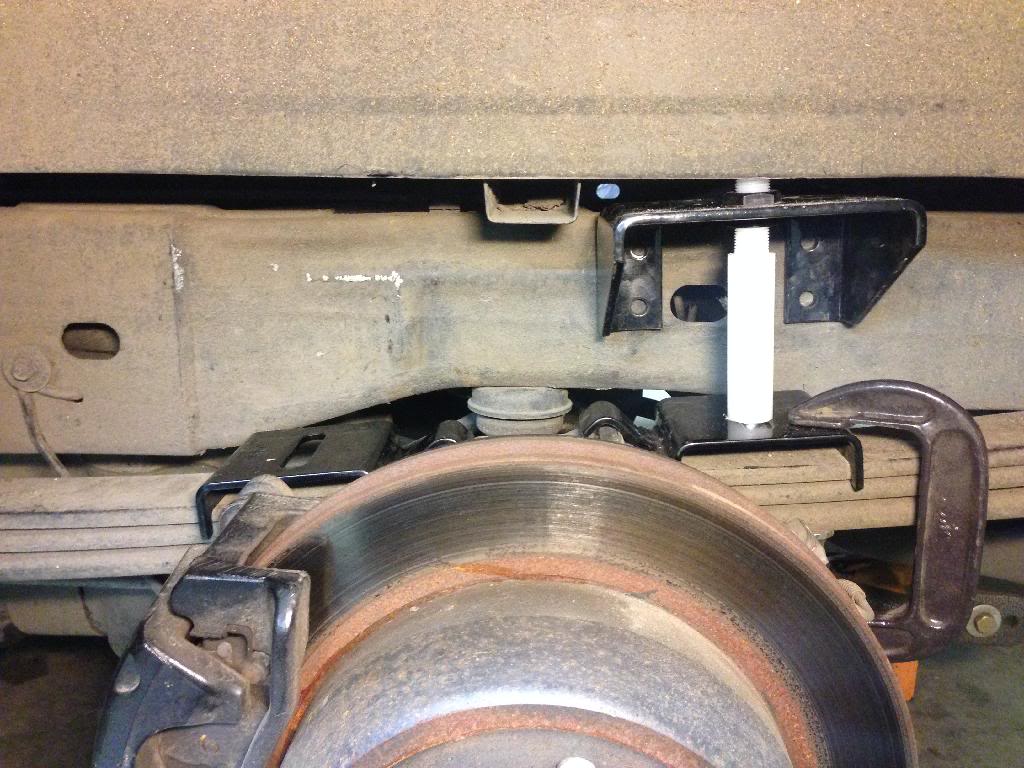

So, I finally had some time to mess around with the helper bag install. Earlier my truck wasn't low enough so I installed spring hangars and Atomic's coilover adapters.
I followed the instructions and I just couldn't get the air bag mounts to line up where the instructions wanted them to be.
I searched around for other people's installs and found this:
Originally Posted by classic07
I installed Air Lift Co. Slam Bag #59103 yesterday took me like 3 hours used all basic and tools and a drill for the installing the upper brackets. I have a 2/4 mcgaughys drop kit, n the rear was bottoming out all the time. Heres some pics of the install…
Box Contents
Frame
Lower Bracket Installed With the installation tool
Upper Bracket installed
Air Bag Installed
Air Bag Filled and Aligned

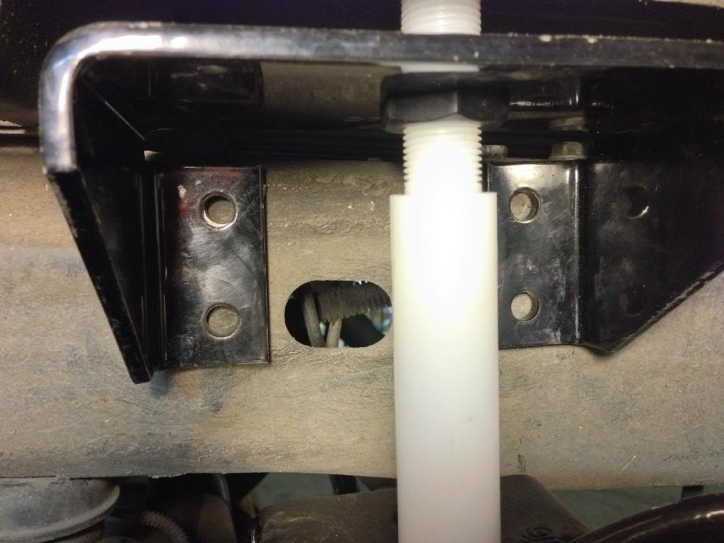

I tried to install my kit the same way but it wasn't working out for me.
The instructions want you to install like classic07 did above. On earlier trucks there is a dimple in the frame for added strength. It doesn't change where you install the airbags. You just have to line up the upper hole with the bump and use a spacer on the lower hole.
No matter what I tried I could not get it to line up the way the kit wanted it to be. I tried bending the lower mount and it still wouldn't line up.
So I installed mine on the other side.

See the lower mount on the left and where the paint is scrapped away? That's where I tried to mount the upper bracket. On the right, I moved the bracket up higher, above that dimple in the frame. This made for a more flush mount anyway.
If you look closely, you can see the spacer behind the upper left bolt hole.

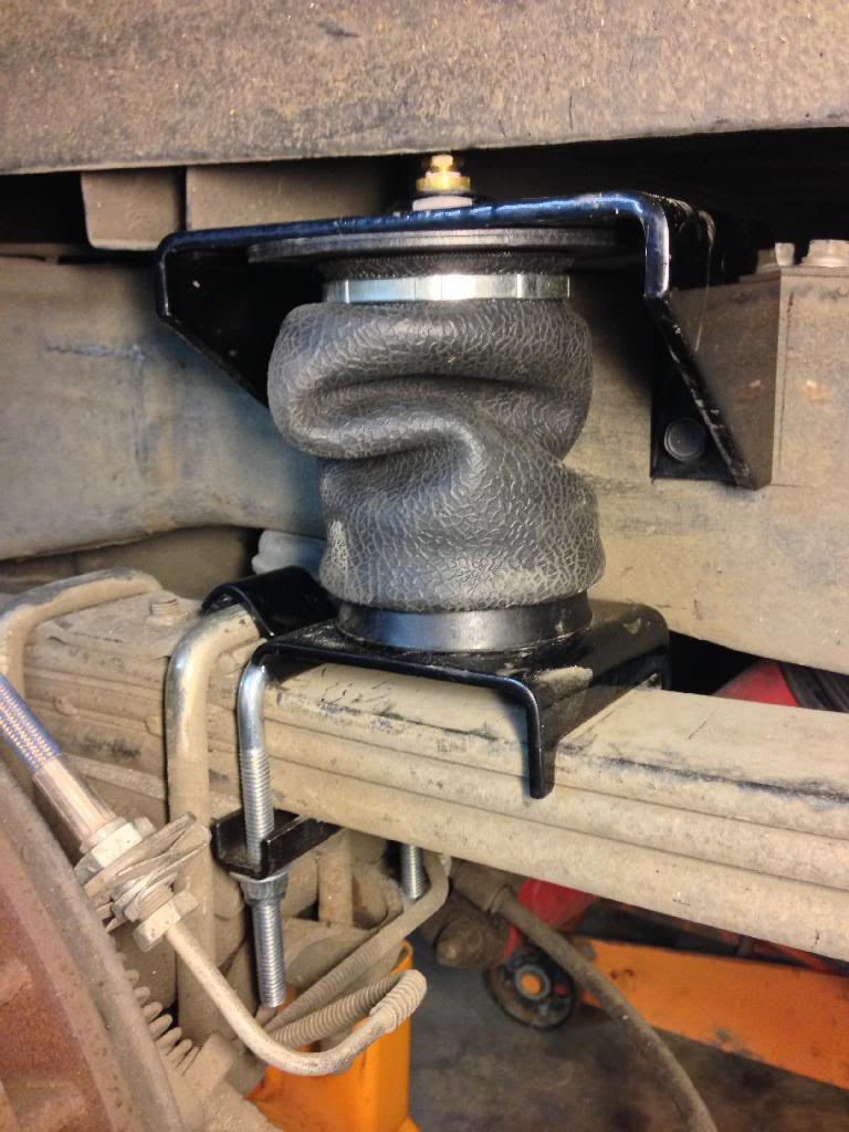

Here it is mounted up with the empty airbag installed.
I still need to install the passenger's bag and run the lines.
Something occurred to me though. Wouldn't it be better having the bag installed on this side anyway? Wouldn't the air bag be helping prevent axle wrap under hard acceleration? I know it's no replacement for traction bars, but it has to help right?
I'm planning on running the airlines to the gas fill door. Right now, the passenger side rear sits about 1/2-3/4 inch higher than the drivers side.
I should be able to fix that by adding air to the drivers side, correcting "Chevy lean", right?

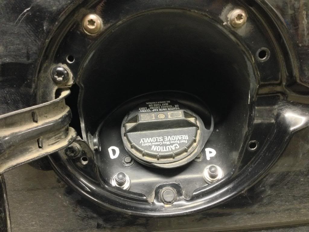

I installed the schrader valves behind the gas door.

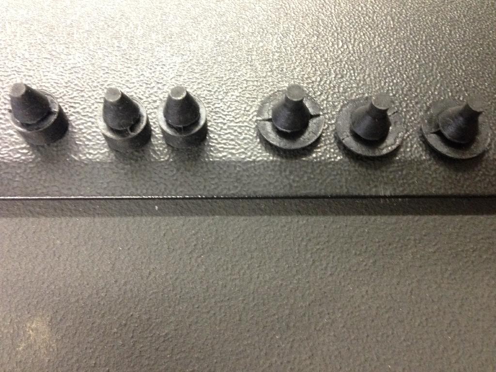

Does anyone know where I can get replacement rubber bumpers for the gas door? There should be 2 in those holes on the right side.

I searched around for the gas door bumpers and it looks like there are a couple options. On eBay you can find factory like replacements or you can go with an upgrade of sorts. The different version has larger bumpstops on them. Dorman part number 961-375.
I'm going to hit up my local Autozone and see if they happen to have them. If not, they can be ordered through Amazon or Summit for like 6.00 shipped.

I picked these up at autozone for 3.00 and couldn't be happier.
Here's what you get.
I decided to go with the taller ones. I used some silicone spray and a small screw driver to get them to go through the hole.
