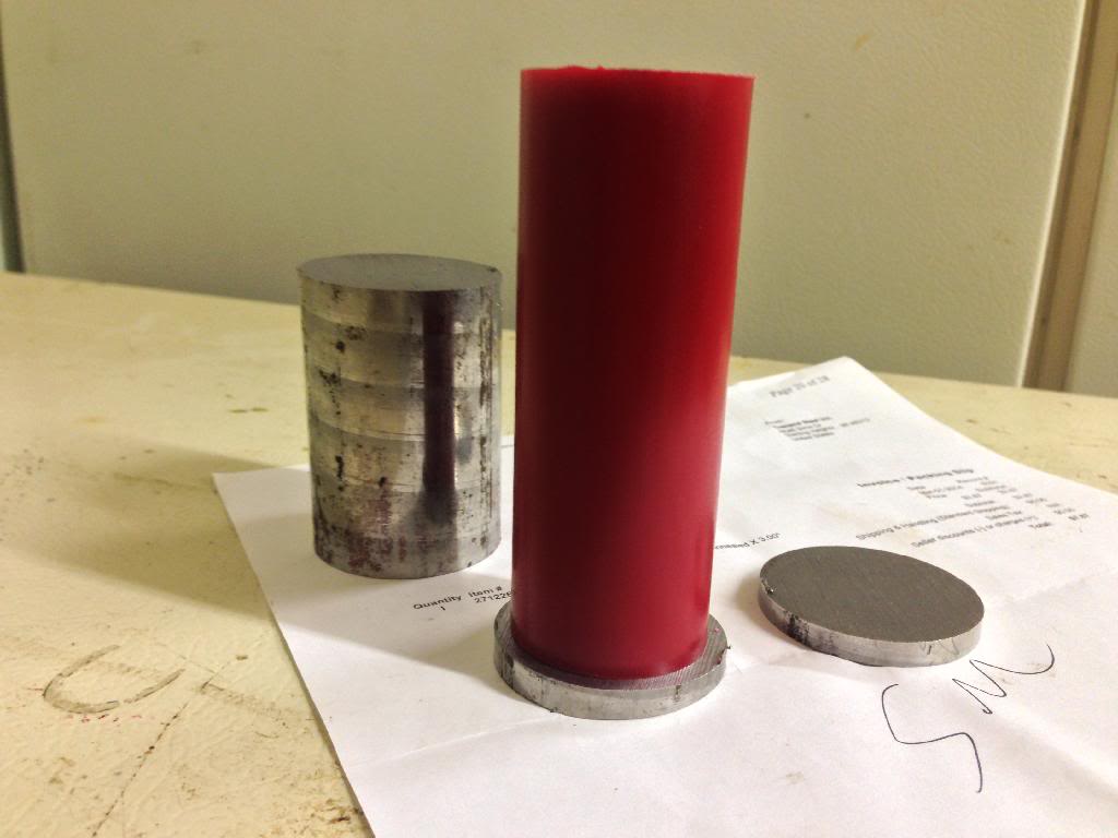

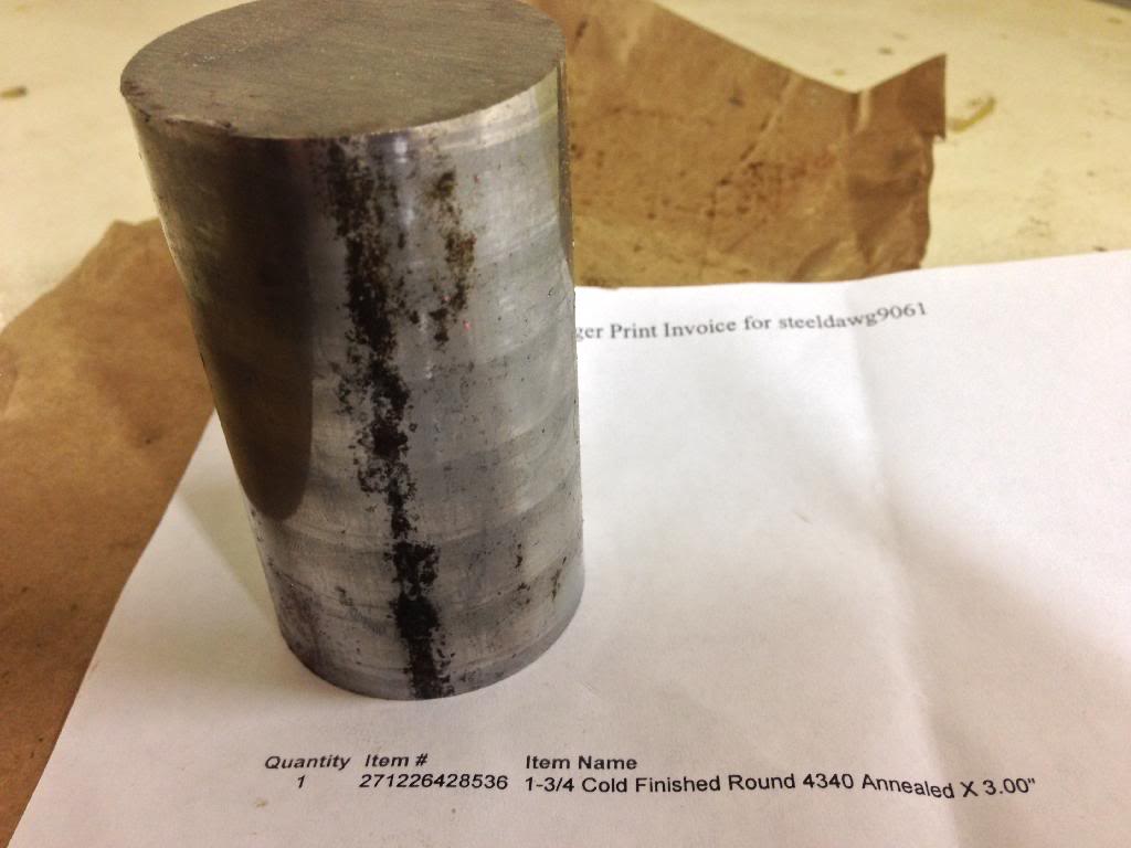

I bought a rod of 4340 steel off of eBay for around 8.00. I want to make a wider base for the polyeurathane.

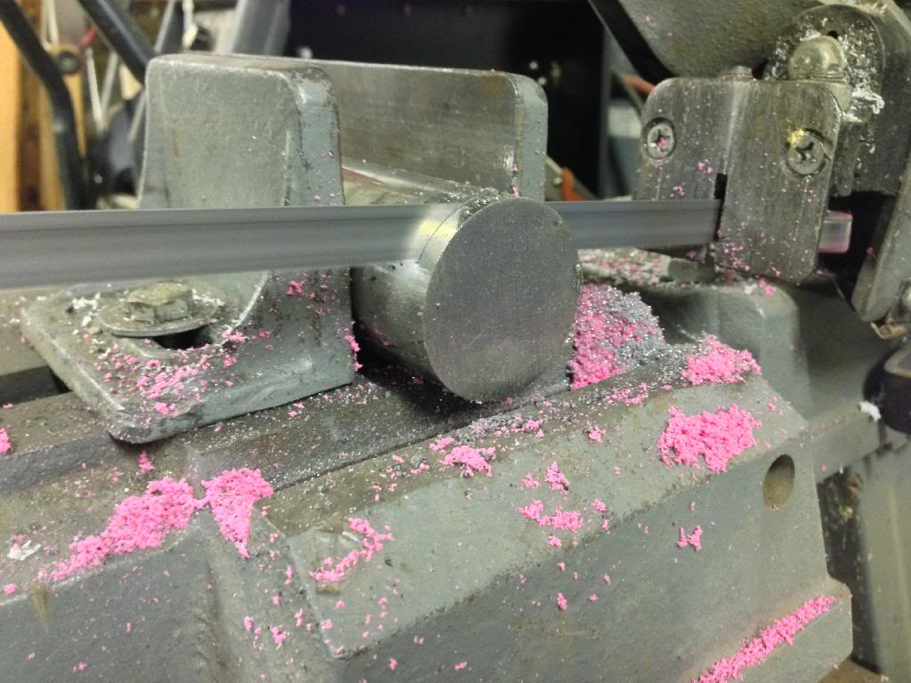

I had to cut it very slowly.

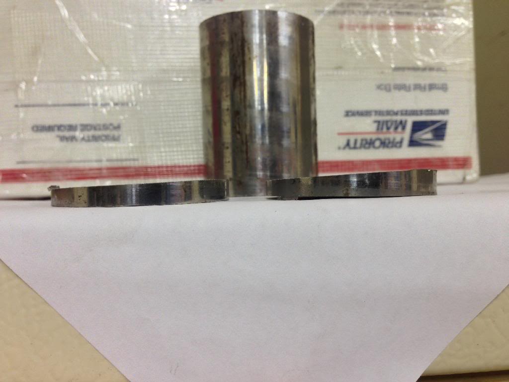

Only problem, it's near impossible for me to cut a square piece off. Ironically, that may be to my advantage since the bushing is compressed at an angle.

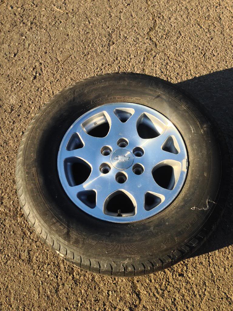

I went and picked up a set of tires/wheels today. I've been looking for a deal on a set for quite a while.
I'm not too picky about which wheels they are, but that have to be 17" to clear my spindles and 05+ brakes. I'm not going to be convinced that they'll clear until I actually get them bolted up.
These came off of a 2002 Tahoe.
I like these a bit better than some of the others. Originally my idea was to have another set for winter tires, or even drag radials. If I happen come across a decent deal on some studded tires, I'll probably pick them up. It'll be nice to have 2 vehicles at the house that have winter sets.
I proped them up next to my truck.
Haha.
These tires are 265/70/17. Are these the factory size? My destination ST tires are 275/45/20. That means these are about 1 3/4" taller than what I'm running. Good thing I have airbags and coilovers! LOL If they don't clear, I'll have to make a few adjustments.
That's all I have for now. Hopefully I can support those bushings a little better. Right now I'm hesitant to drive it. Once I get these in, I'll start putting some miles on, and see if that polyeurathane is resilient enough to take daily driver abuse. Also, I'm going to go check out a set of 17" wheels/tires tomorrow. The tires are a bit warn wich is perfect timing actually. I'll be able to mess around with the Coilovers and not care about the alignment.
Here's a link to what I bought.
http://bit.ly/1iuntRt
I *think* that is a pretty good price for that 4340, thanks for sharing the seller.
I bought a mini-lathe back in January to make a short-throw shifter adapter for the T56 that I swapped into my 2WD Tahoe in place of it's stock 4L60. I just measured and I can fit 1 3/4" round bar into my lathe and machine you a reasonably square 90-degree ends if you'd like. If you end up liking those diy washers and want some that are square then I'll buy some of that stock because I may need to do this myself.
