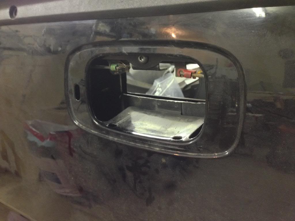

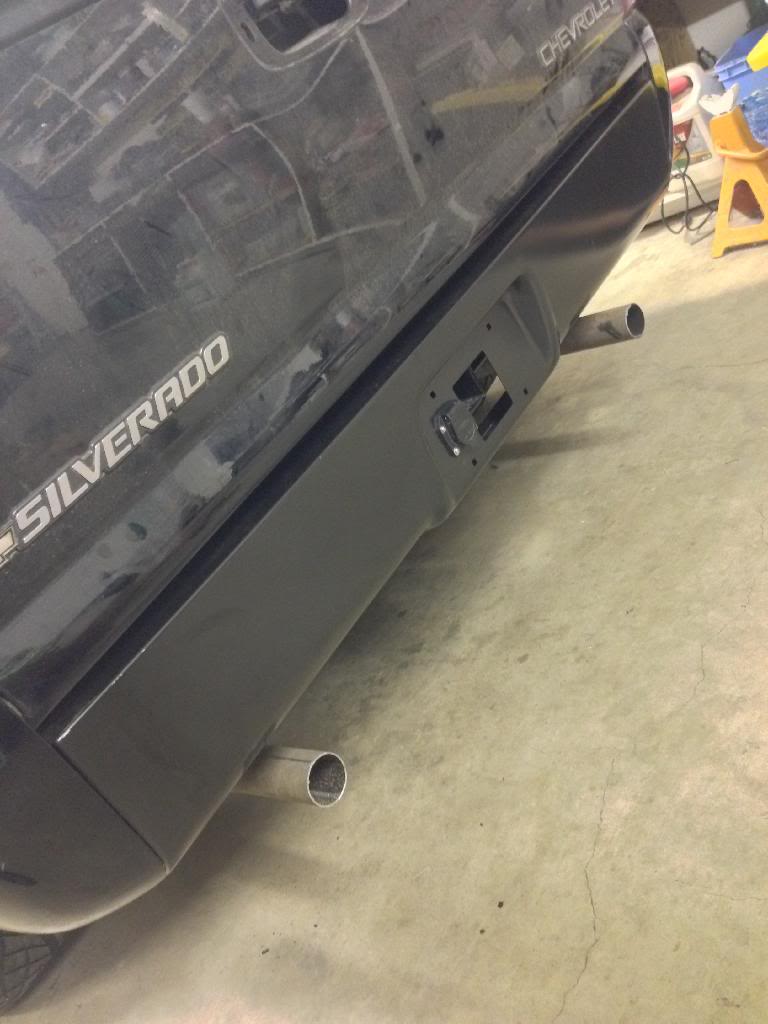

Better?
I trimmed them the best I could with the tools I had on hand. I still have some grinding to do.

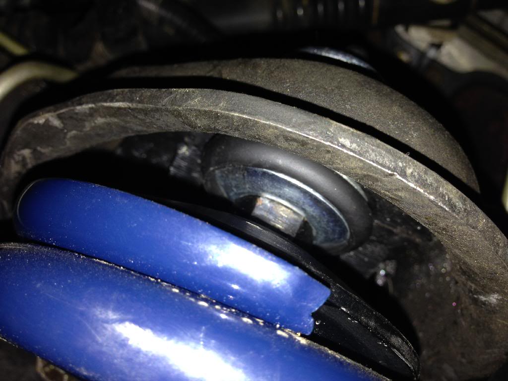

Originally Posted by WS6 What
Awesome thread and great detailing the progress you have made especially on the coil overs. I wonder if you have drove the truck around since you last added the washers for the stud mount. This is my debate at the time, either go stud mount or pro comp mount.
This is about 20 miles on them.
I don't think they're going to last. I think it's just too much weight for the bushings. It may be time to take the bushings out and replace them with solid bushings. I'll have to source a solid bushing of some sort. Perhaps I could weld a stack of washers together?

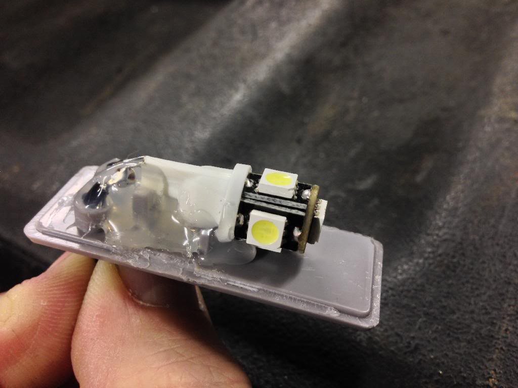

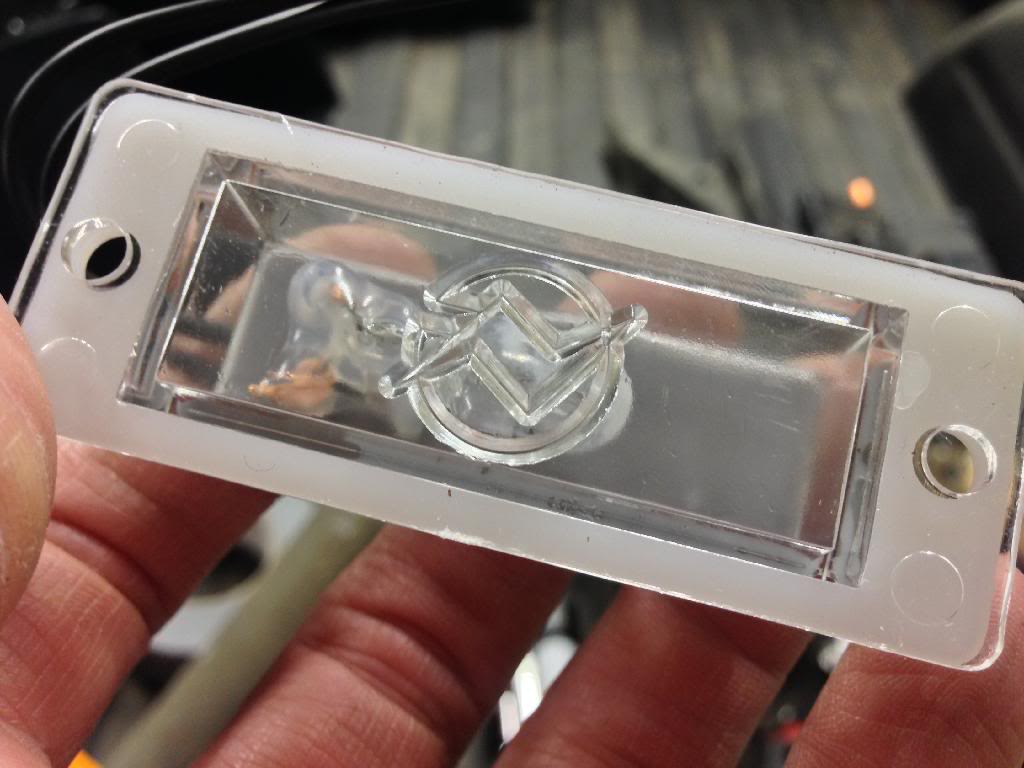

I received my 194 LED lights from amazon, so I tore apart my license plate light housing.
I soldered in the LED replacement.
Then I used a hot glue gun to hold everything in place.
We happened to have some reflective tape around so I put some in the housing. I was planning on wrapping electrical tap around the housing anyways. I didn't want scattered light from the housing after it was installed.

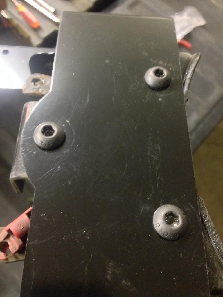

The bolts that the factory used seemed to rub on the tailgate skin when I was test fitting. So I ran down to the hardware store and got some Allen headed bolts.
All done. Pretty straightforward really.

Trucks coming along nice man, looks good. Curious about the ride on the coil over setup? Considering doing the swap to my DD. As someone mentioned before look into derlin for solid bushing material it's good stuff. Just wondering when you tightened the top bushing down did you crank it tight like that or is that the truck compressing it? Just wondering thanks man.
Billy
Old Jan 30, 2014 | 08:53 PM
  #270
PaulyC's Avatar
Joined: Nov 2012
Posts: 93
From: Mass
they compress like that just from the weight. go with ridetech coilovers. they come with delrin instead of rubber and the shocks are actually made by fox. way better quality than qa1s.
