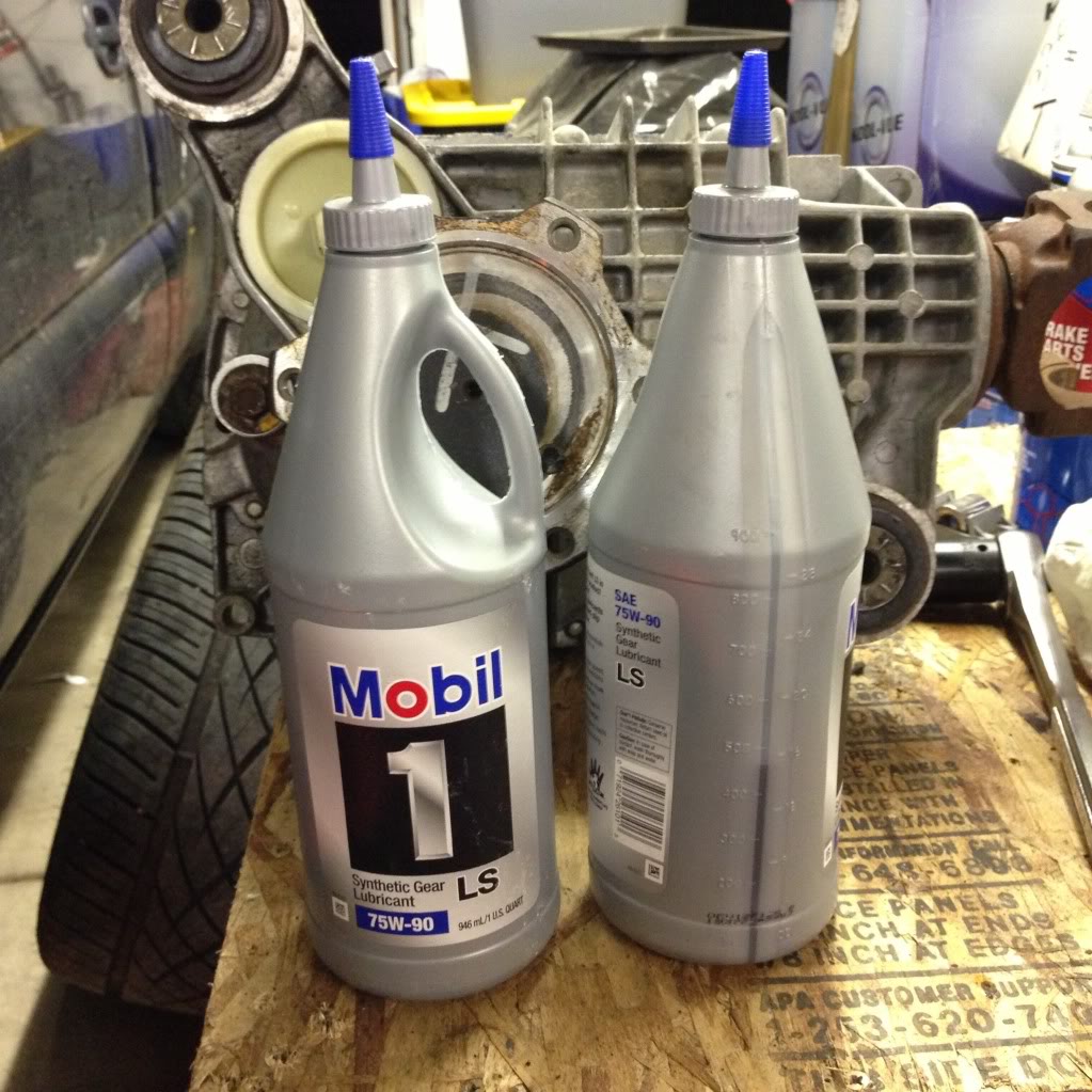

Since I have the front diff out and everything I went ahead and replaced the black vent with the newer white vent. Supposedly there were problems with the black vent backing out and being incompatible with synthetic gear oil. Looking at both of them side-by-side the only difference I can tell is that the newer one (white) has a metal breather instead of a plastic one.
After that I filled it up with approximately 1.5 L of Mobile1 75/90 weight synthetic gear oil.

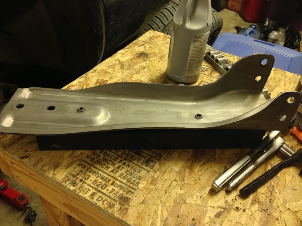

The first thing I did today was clean up this piece.
This part goes under the oil pan. It was full if gunk and build up oil. You basically fill it with oil every time you perform an oil change. LOL. I scrubbed it down with a wire brush, a screw driver, paper towels and brake cleaner.

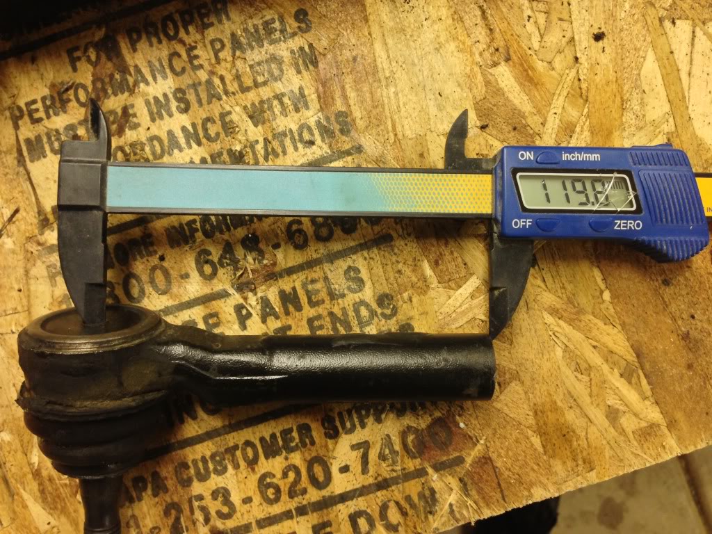

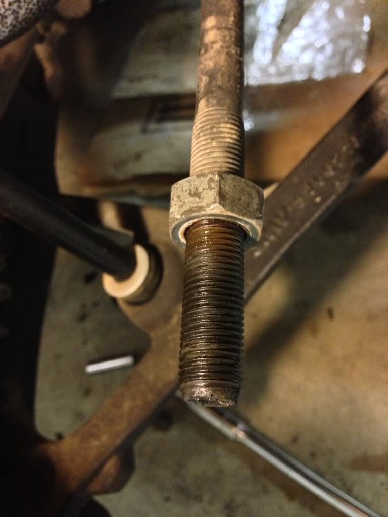

Then I moved on to the tie rods. I don't want to pay for an alignment, so I did some measuring.
So the replacement tie rods from autozone are slightly different. So to get it as close to where it was as possible, I measured the length from the grease zerk. I needed to get as close to the center of the tie rod as possible.
The factory piece measured 119.8mm.

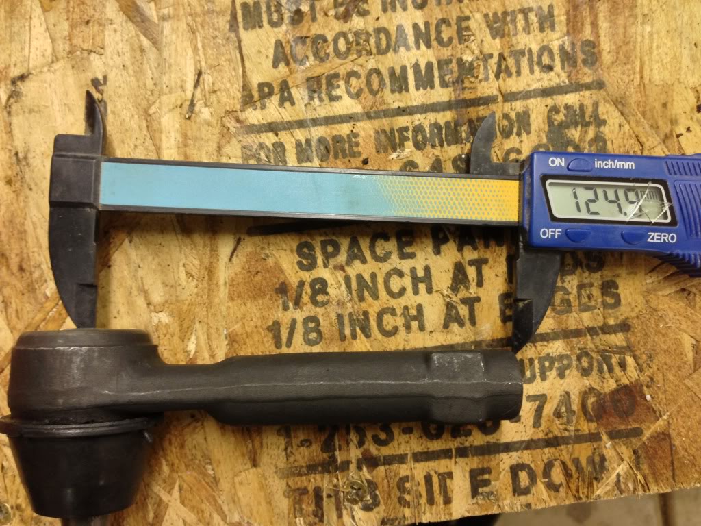

The autozone piece measured 124.9.

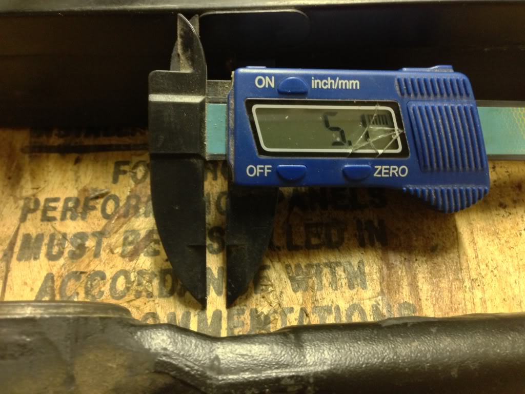

A difference of 5.1mm.

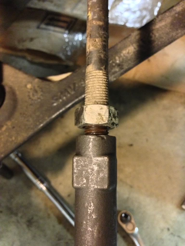

Before I removed the factory tie rod end, I loosened the nut, then hand tightened it back to where it was. This gave me a reference as to where the factory tie rod was located.
I put the replacement tie rod on and tightened it to the nut. Then I moved the nut 5.1mm farther in.
After that, I screwed the tie rod in to meet the nut at the new location. I tightened everything down. Now, I'm within 1/16 of an inch from where the original tie rods were.
