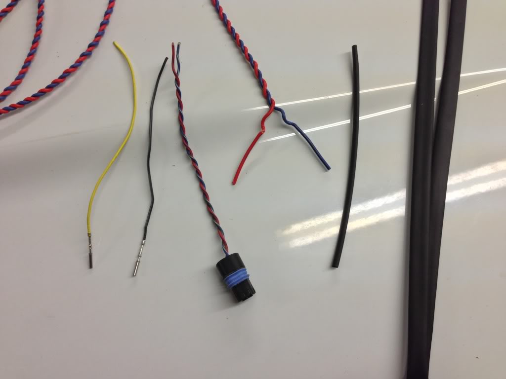

Well it turns out I grabbed the wrong connector ends. I took them from a different truck and mistakenly grabbed the wrong ones.
Here are the correct ones.
The correct ones are round.

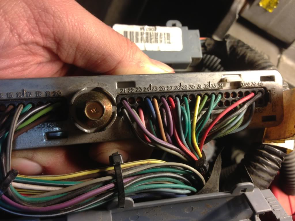

So I took apart the factory computer to add the wiring for the ISS sensor and while I had it apart I decided to put my LS1 fans in.
I removed the cover and then used a 7mm socket to remove the computer's plugs.
Pin 22 and 23 is what you add the ISS wiring to.
I didn't take a pic, but pin 42 is what you add for the LS1 fans. I did the one wire setup. If these don't work I'm going to upgrade to the 05+ e-fans and radiator. They use a 2 pin setup. It's a bit better than my setup tapping the A/C signal.

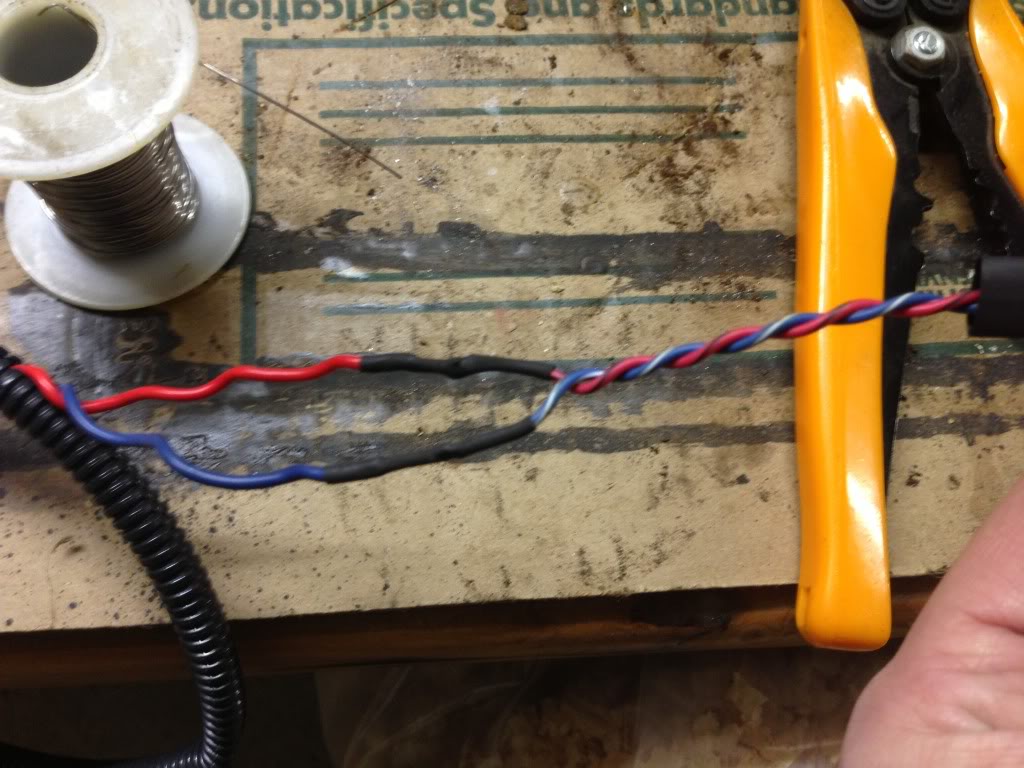

So I went ahead and soldered the ISS wiring up. Be sure you twist the wires. I shrink wrapped the wires.

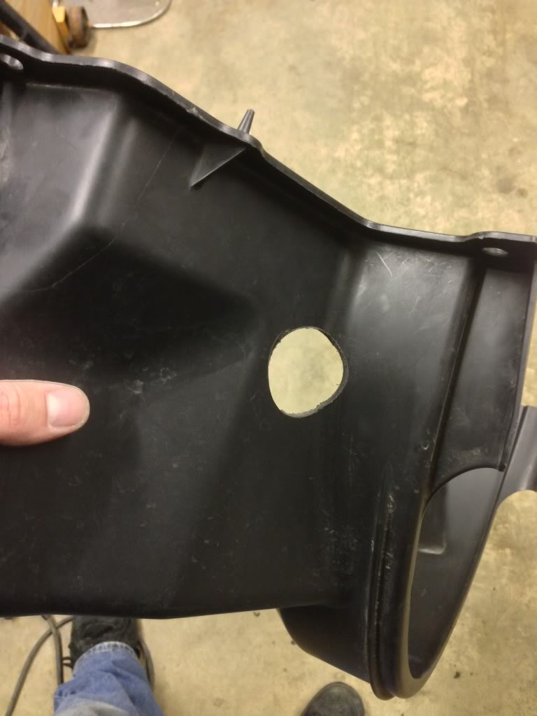

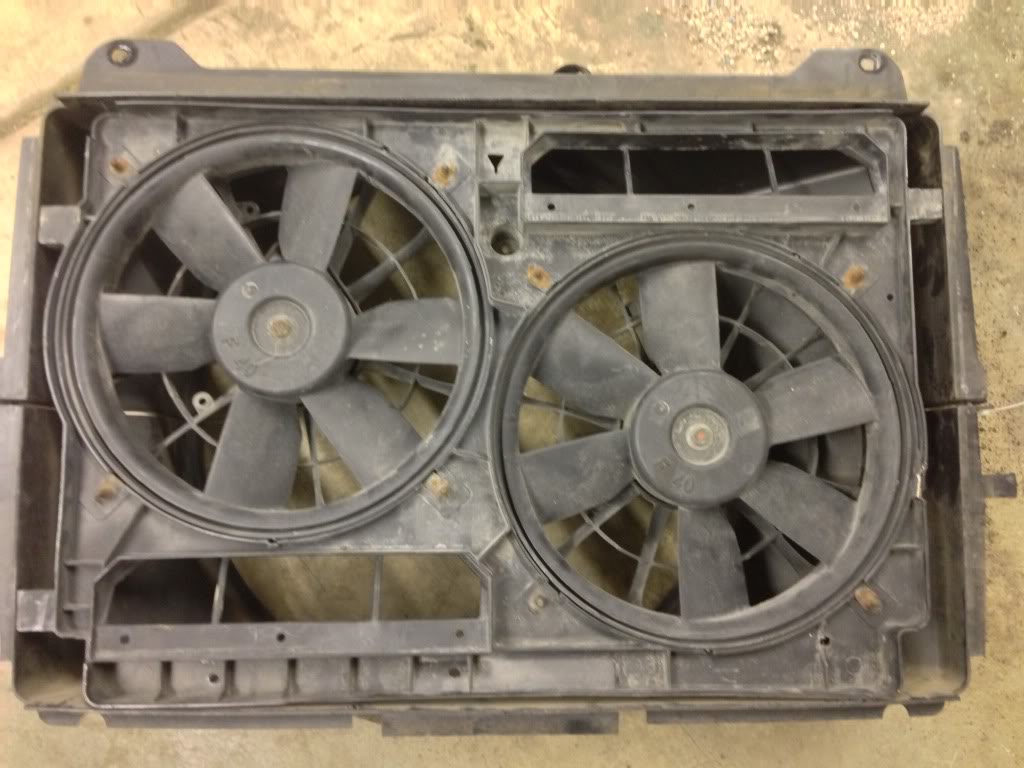

Then I moved on to the LS1 e-fans. I searched around for what others have done, but ultimately decided to just reuse my factory shroud. I didn't have any flat stock around. This will work for now.
I trimmed the fans a tiny bit to fit inside the factory shroud.
Then I drilled a hole for the fan's wiring.
Here it is all buttoned up. Looks factory for the most part.

Those look like LT1 fans, not LS1.
Old Jan 30, 2013 | 12:12 PM
  #183
iregret's Avatar
Charlie Murphy!
Joined: Dec 2010
Posts: 1,057
Likes: 14
From: Oregon
Well hell. They were sold to me as LS1 fans. What's the difference?

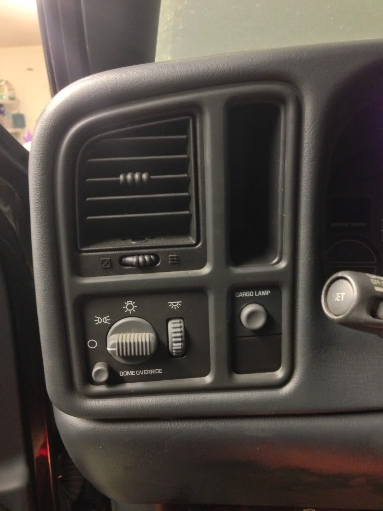

I had a problem, not being able to engage the front axle. It ended up being several little things.
First off, the actual button broke. The solder broke where the pins meet the circuit board. I resoldered that and it was fixed.
I still couldn't get the front axle to engage. So what I did was remove this assembly from my factory transfer case.
I plugged it into my factory wiring. This allowed to me engage the front axle. Once the front axle was engaged, I unplugged the part from the factory transfer case and the front axle.
After I started the truck, I got a "Service 4x4" error on the dashboard. I had to post up a thread asking about it, and do some searching through the forum.

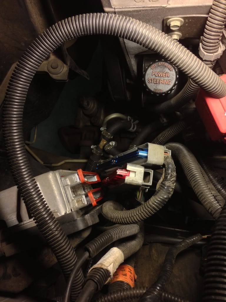

It turns out, to fix it you unplug the transfer case control module (TCCM). This is located directly behind the factory 4x4 buttons.
It's that part with the orange plugs.

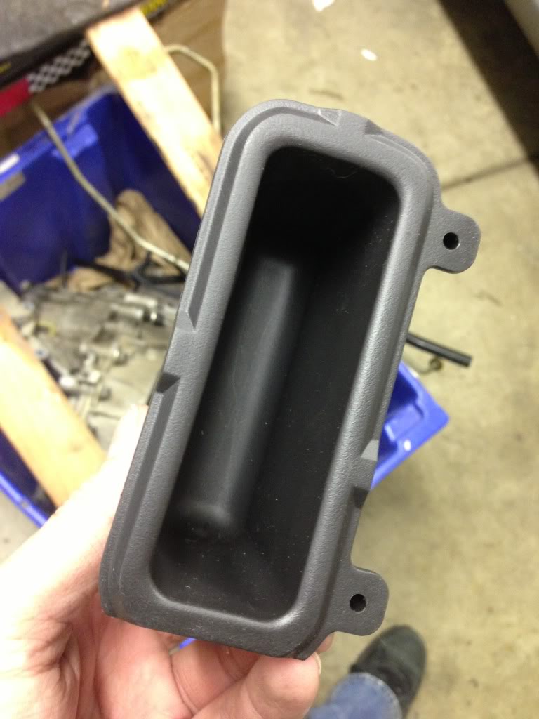

I had to dig through some boxes but I found my pocket I ordered a while back.
There we go, all installed. This is the last part that would indicate 4wd or AWD. For the average person looking, my truck should look 2wd! Woot!
Well, except for the fender flares. Those are a hint, but nobody notices.

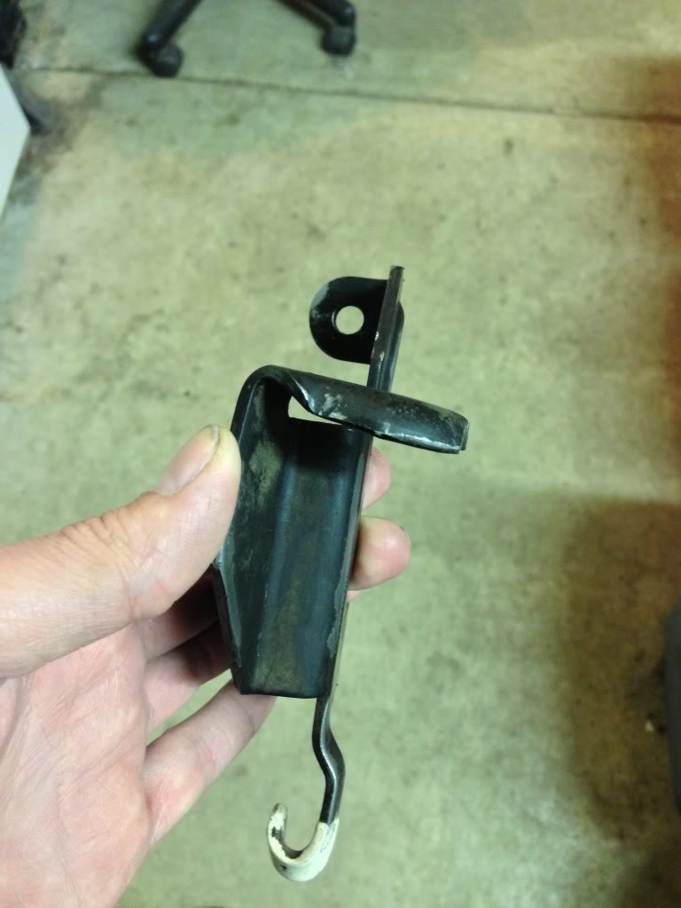

For some reason I couldn't get the shift column to engage first gear. When I pulled it all the way down it would only go down to two. That's why I thought it was the neutral safety switch.
I had to take the front driveshaft out. I removed the shifter cable mount and noticed it was a bit bent. So I put it in a vice and straightened up a bit. I actually bent it a little farther than 90°. This solved my gear selection problem.

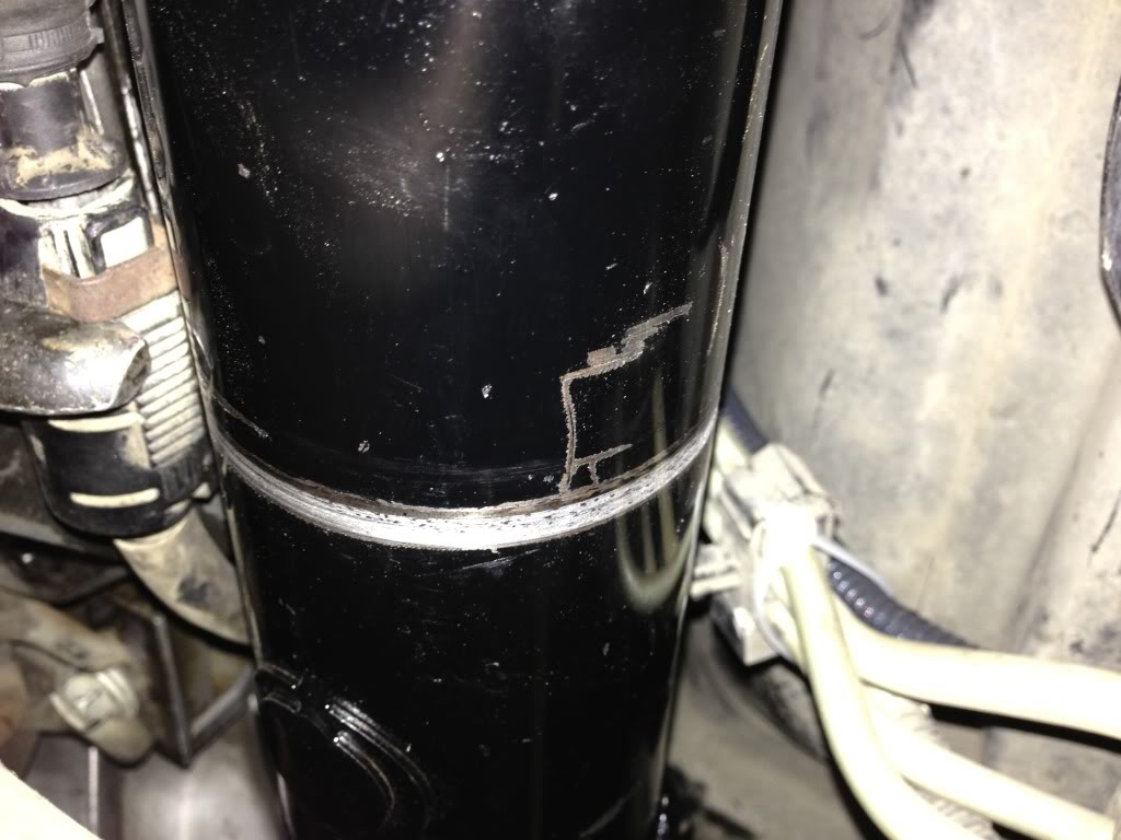

I figured out the ticking noise. It was the same part from yesterday! Under a load the driveshaft moves over slightly and touches that bracket.
I bent the bracket a bit and it seemed to fix the problem.

Do you think you'll be doing anything with the driveshaft? It's hard telling in the pics how deep those scratches are.. Would hate to see it cause a stress fracture there..
Nice build, I'll be borrowing a couple of your ideas for sure !
Old Feb 6, 2013 | 04:17 AM
  #190
iregret's Avatar
Charlie Murphy!
Joined: Dec 2010
Posts: 1,057
Likes: 14
From: Oregon
I think the picture makes the driveshaft look worse than it actually is. It rubbed through the paint and barely into the metal.
