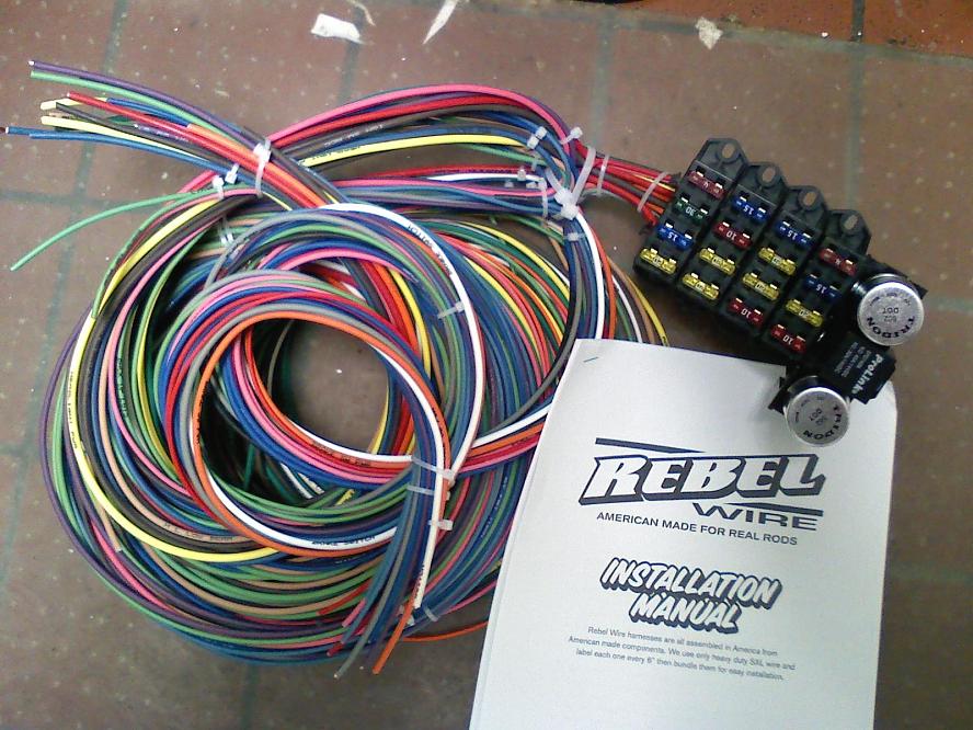

Got my 20 Circuit Rebel Wire harness today. Its a Stand alone EFI ready hook up harness. Im not playing around with the stock wiring at all.
Attachment 50591
Justin
what is this for?
I'm going to be dealing with all this wiring crap come summer. the wife wants a pontiac ventura (nova with a pontiac sticker) as a daily, so i'm going to toss a 5.3 in there. any link that helped you on making the stand alone harness? I love my current harness but I dont have another 850 to spend on it.
your stand alone harness looks top notch!

Thanks Dude! Alot of searching and cussing went into this harness! But I'm happy with the out come.
Here is the Links I found:http://lt1swap.com/index.htm
This is good start, the guy has all the pin outs and stand alone wire diagrams on his site. Read very closely and be through on your moves! Get a high lighter and mark the pin outs as they are highlighted on the page. Get yourself a good amp meter, label tags, good solder iron.
You also have your Current Harness on Ms. Mia to use as a guide too!
Take your time, Take your time!! I cant stress this enough!
Get your ducks in a row, and it should go good!
If you have any questions or need pictures I'll be glad to help!
I had a hell of a time getting the 5.3 longer harness to work with the LS6 intake. After putting on the engine about 3 time's to get the length right!
The stock wiring on my 88' is dog ****! I hate old wiring and chasing someone else screw ups. That why I bought this Chassis harness! Little more money on the project, but this way I wont have to search for things!!
Thanks for the props! Hit me up when you start the Pontiac! I had a 71' Poncho same body style w/ 69' GTO 400 in the beast! Old high school car, wish I still had the old X-body!
Taker easy LSX!
Justin
