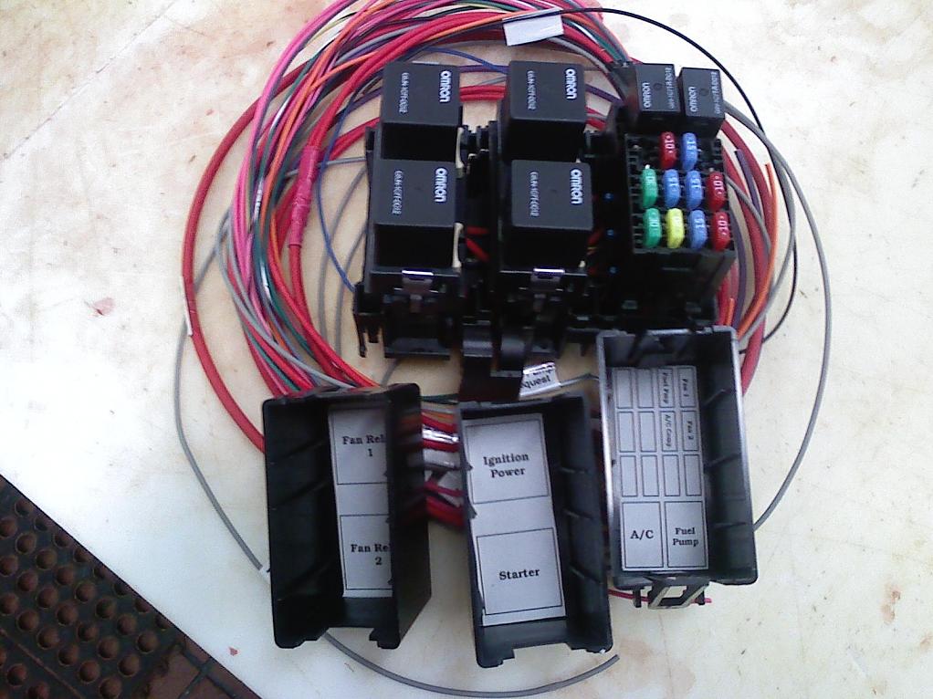

Jarad At Current Performance Hooked my up with one of his Relay boxes.
This thing is great! My harness is almost finished, just have to loom the wires and route them. 1988 Blazer 5.3 Swap-1210091224-00.jpg
I didn't like how the harness was put together from the GM. Real mess, ground wires twisted all over and longer than needed wires. I solved all that mess,, and should have no problems.

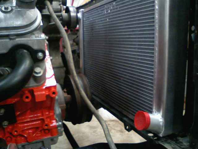

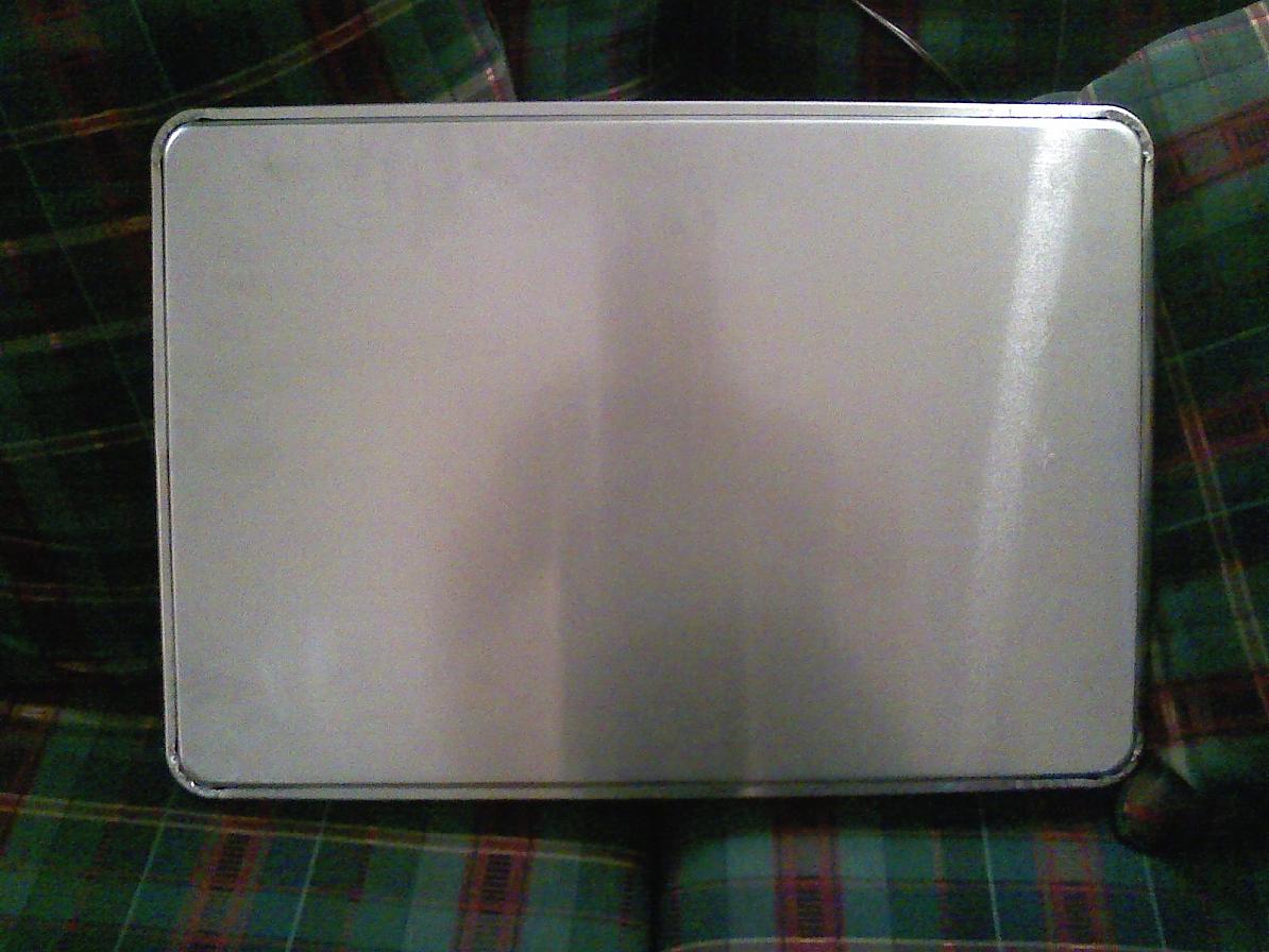

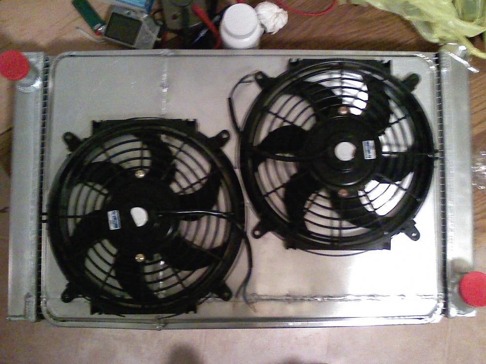

I'm also Building a Fan shroud out of ( Are you Ready) A Bakers Sheet pan!
I have 2 Procomp 10" Electric Fans off of Ebay. $35.00 for 2 them! And I have $11.00 in the Aluminum Sheet pan. Should be nice when Its done. I have to cut the pan Down and TIG weld it back together. Extend the the sides of the pan for proper clearance for the fans. Should have the cooling system finished this weekend. 1988 Blazer 5.3 Swap-1209091834-00.jpg

Post Welded up almost a fan shroud!
More done Harness still coming together. Got the Fan shroud almost completed. Just need to cut openings for the fans. Not sure how I'm going to mount to the radiator yet, Come up with something.

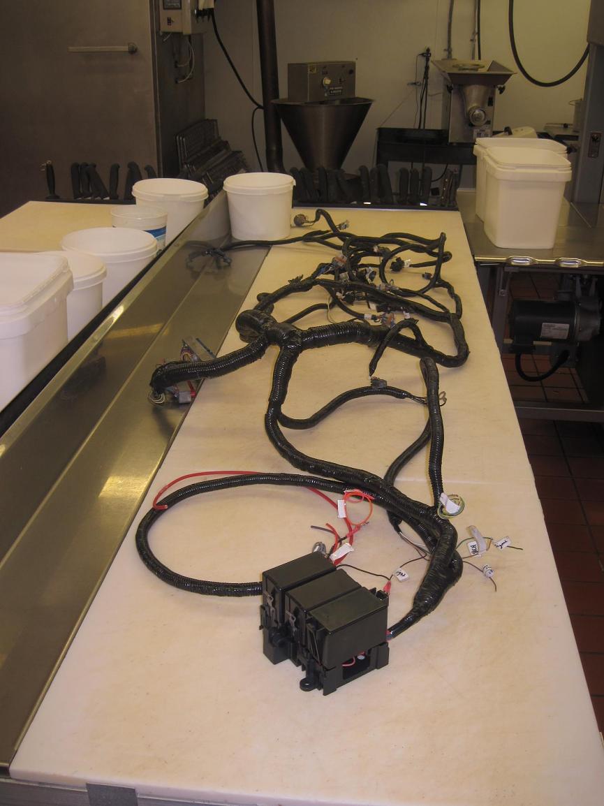

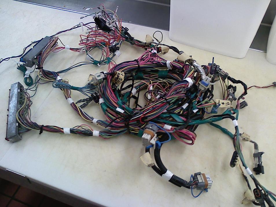

Post Harness Is Finished
After few hours a night for the last 3 weeks, I have stand alone harness!
Really happy on how it came out. Should have it on the engine and wired in by this weekend. Just need to send the PCM off now!
The Relay box from Current was the nicest thing! Sure made life easier.

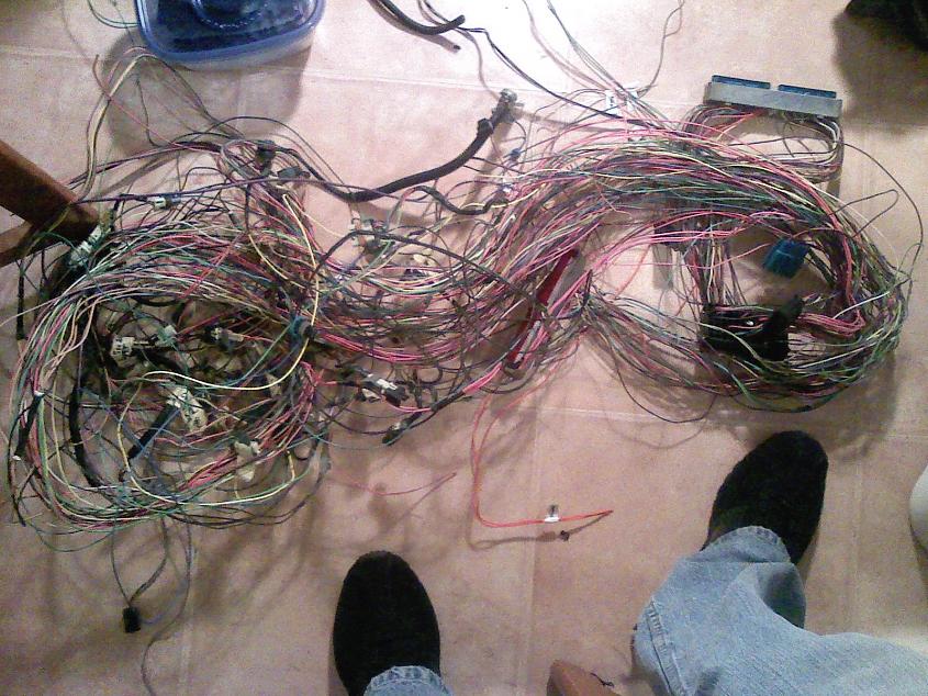

1988 Blazer 5.3 Swap-1201092132-00.jpg What I had to deal with. The jackass I bought this engine and harness had cut all the under hood wires from the Factory relay box. So I had to chase every wire!

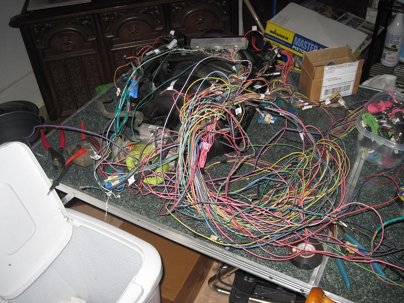

1988 Blazer 5.3 Swap-img_0456.jpg Labeled all the Needed Hot wires and sensors. Sure glad I had a Amp Meter.
1988 Blazer 5.3 Swap-1202091221-00.jpg After I found all the wires and got It looking like a harness again.
1988 Blazer 5.3 Swap-1210091224-00.jpg If anyone is needed to have a Relay box, This is by far the Best in my opinion! Strait forward and correct.
1988 Blazer 5.3 Swap-img_0558.jpg Finished and ready to rock.

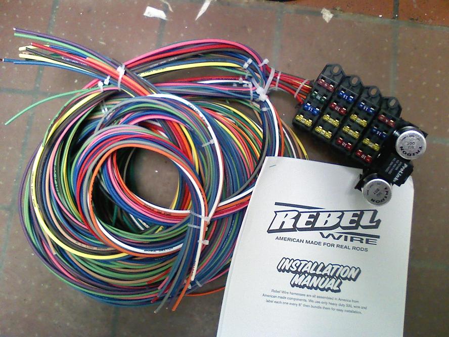

Post Chassis Harness came today
Got my 20 Circuit Rebel Wire harness today. Its a Stand alone EFI ready hook up harness. Im not playing around with the stock wiring at all.
