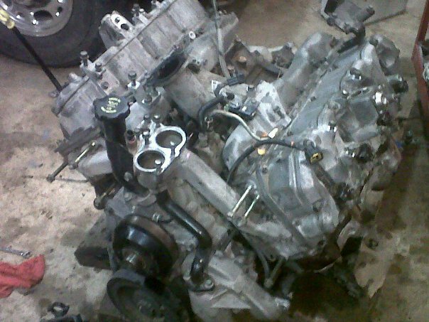

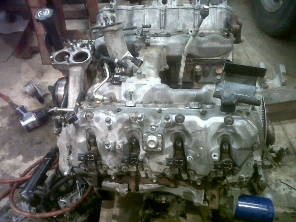

Just driving the wheels off it. Thats till I get my 05' Duramax fixed, Head gasket!
Started that adventure this week. Amost ready to pull the heads off. Thank go my best friend is a CAT diesel tech and Diesel junkie. I'd be sunk without his help! But its getting there. Weak factory hardware and a nasty tune is hard on the stock parts. You live and learn.
This time its getting ARP head kit, egr block, Air Dog Lift pump Airperferator. And 75hp injector nozzles. Pcv reroute, keep the engine clean.
1988 Blazer 5.3 Swap-arp.jpg I had trans issues last year, it was due to loaning out my truck to a buddy to tow a trailer. He got stuipid with it. It has a Sun Coast stage 5 and billet converter now. They say there rated @ 1K tq. Shouldn't have any problems. Still have 2 yrs left on warranty.
Got to get the truck done soon. It's out family truck now with the Twins due in July. Got to recover from this repair. So Ruby might be put on the back burner for a bit. Thank god I have it drive to work. Gas mileage isn't the best with the 3 speed. But so far no issues as Daily Driver. Knock on wood!
