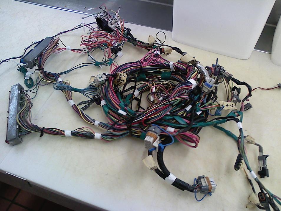

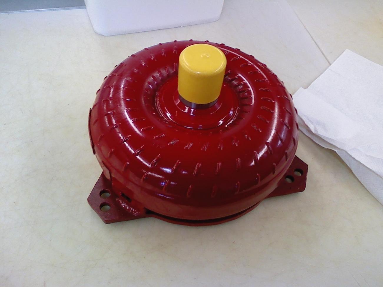

started my harness myself on monday. Got everything taken out and done except cover and relay box done. My Torque converter just came in. 3400 stall anti balloon. Should work with the 221-221 283* .558lft 114 LSA cam I plan to get. Besides that nothing new, but I am getting closer!

looks great, what kind of stall is that?

I have fresh TH-350 w/ manual valve body, Raybes. Green clutches and Band.( New sun shell, and TCI Pump) New yoke and shift kit. The converter is 9.5" 3,400 stall. Nos ready. I had this trans built for last project ( '71 Nova) that I sold before I could start it. I plan on a built 4L60-85E in the Future. Just want to drive this thing soon!
The harness is coming along well. Just a matter of time now. There sure proud of PCM tuning.
