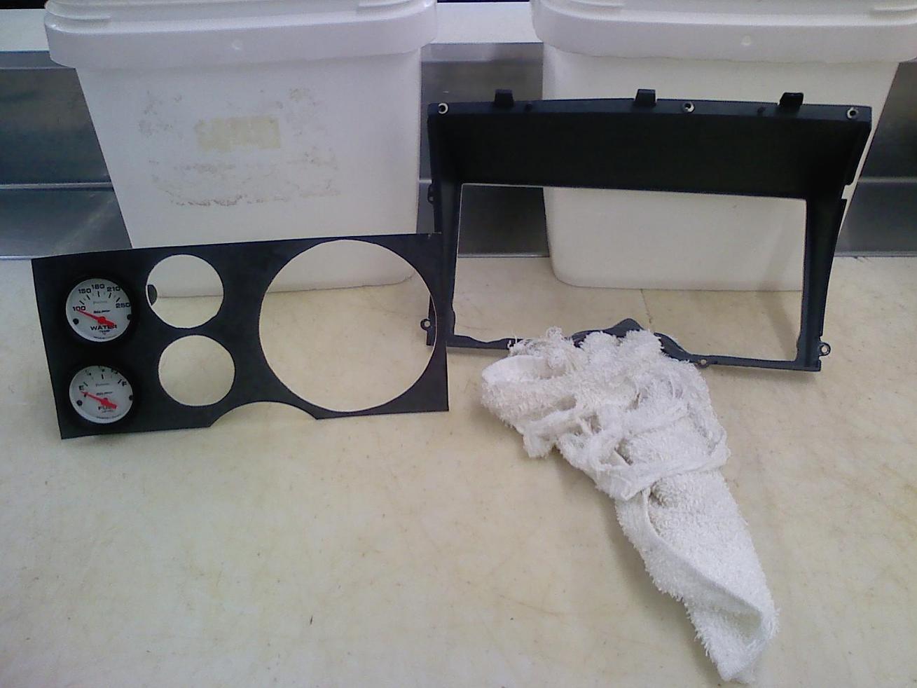

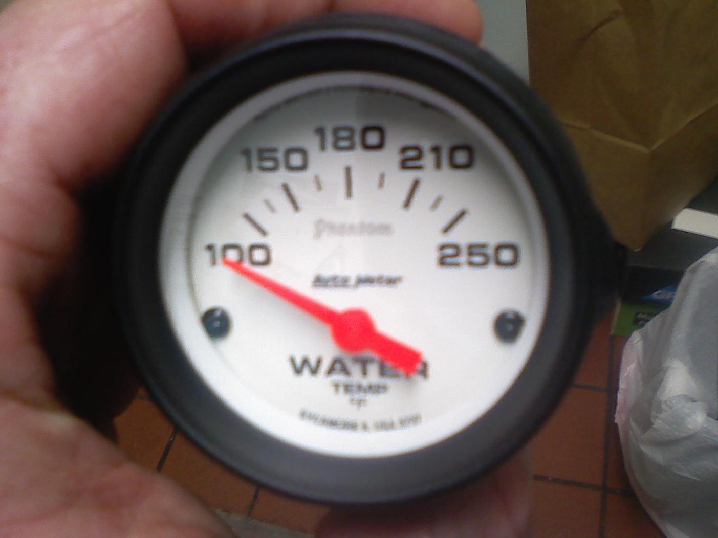

Over the weekend I started on my gauges.
Auto Meter Phantom's
2 1/16" Fuel, water, oil, volts.
5" Electric Speedometer
After I pay myself back from buying the set, I'm getting the 5" Monster Tach w/ Shift light in a few weeks!

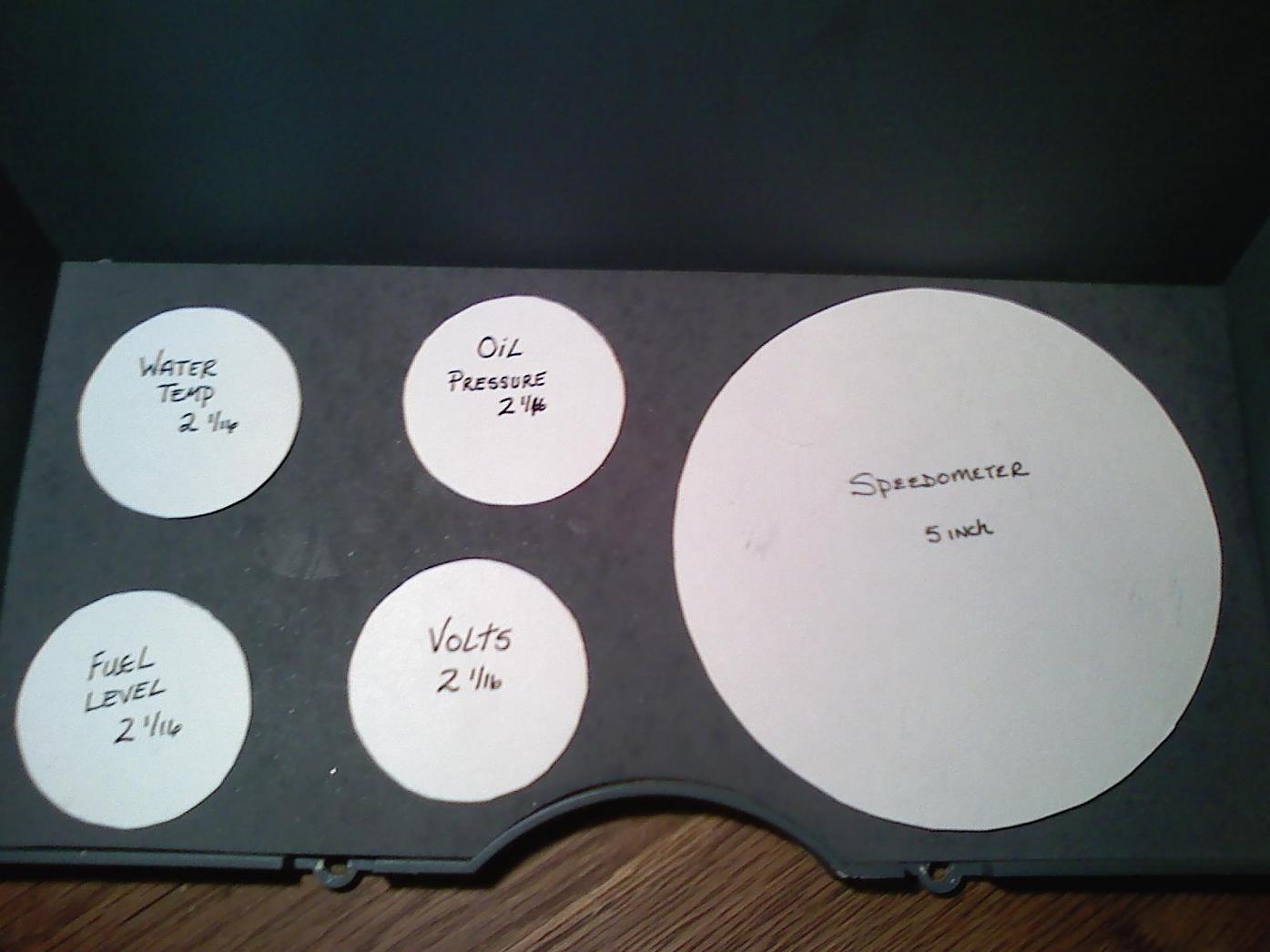

I cut out the stock Bezel and test fit the New filler panel. Mocked it up with .99$ poster board.
Fitting the 5" Speedo in there was a tight fit, but I like the end result.
Here the Paper panel! The other gauges should be here this week. "Back order E-bay, but saved me some coin!"

If anyone would like a pattern of the panel, I'd be glad to help!
It fits like a glove!

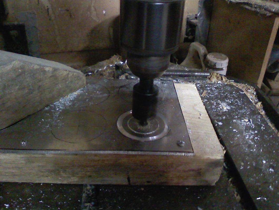

Tip: Cutting the dash ( or any hard Plastic) I found a little heat from with a heat gun and a utility Knife works great! Just make your outlines with the knife. Heat the back side of the part your cutting, and cut over the line until your though! Alot easier than having a slip with a sharp knife!

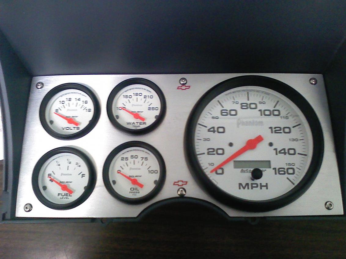

It's Finished. Besides Sealing it with a clear coat.
1988 Blazer 5.3 Swap-0217102127-00.jpg My RedNeck Machine Shop!
1988 Blazer 5.3 Swap-0218100142-00.jpg Run My Belt Sander over it. Like how The Phantom Gauges look Right at home!

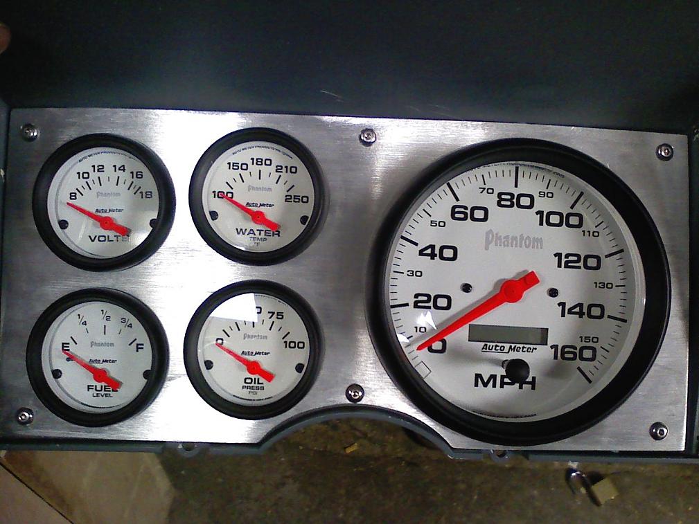

Wink Finished Gauge Panel
After a Contact High from the Clearcoat Fumes, Whoa! Nasty ****!
The Brushed Aluminum Sealed up nice after 3 coats of Adhesion Promoter and 4 of the Clear! I sanded and fixed the cracks the cutting made manhandling the bezel. And Shot it with some nice gray paint. Fresh looking with the Gauges, should look great in the dash.
Only need the green Turn signal lights installed yet.
