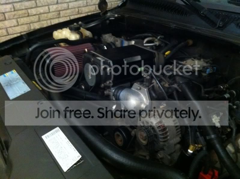

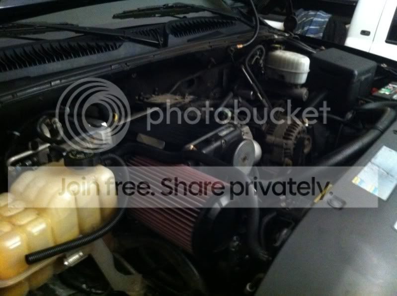

I just finished putting the blower on about an hour ago. Install went pretty smoothly, I have been installing everything other the past week. I still need to hook up my boost gauge and go to the exhaust shop to get a bung welded in for the wideband. I'll get some more pictures and videos in the next couple days.
I have driven it around for a little bit and had my buddy hook up his HP Tuners to make sure everything seemed ok and so far so good. I never got above 45% throttle and you can really tell how much easier it is to get up to speed and maintain speed compared to stock. Got it up to almost 3k at points and it sounds pretty badas, definitely has a good whine to it. Once we get it tuned its going to be pretty fun to DD
