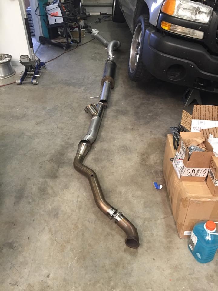

I helped my friend weld up an exhaust for the truck: 3" downpipe to 4" cutout, then on back to a 30" diesel magnaflow, and it exits behind the passenger rear tire out through the fender.

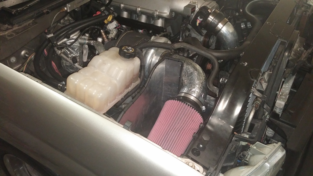

I also wasn't happy with how hot my IATs were getting. I wrapped the up-pipe and turbo inlet pipe in 1/8in insulation tape and then foil tape. I also made an aluminum heat shield for the air filter. This seemed to have reduced my IATs by about 10 degrees, which I'm happy with.

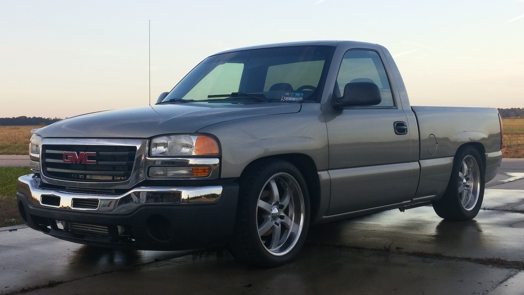

Lastly, I took the 2 year old plastidip off the grill...I think it looks better with the chrome.
What do y'all think I should do aesthetically to the truck? I'd like to color match the lower bumper/valence. Any other suggestions?

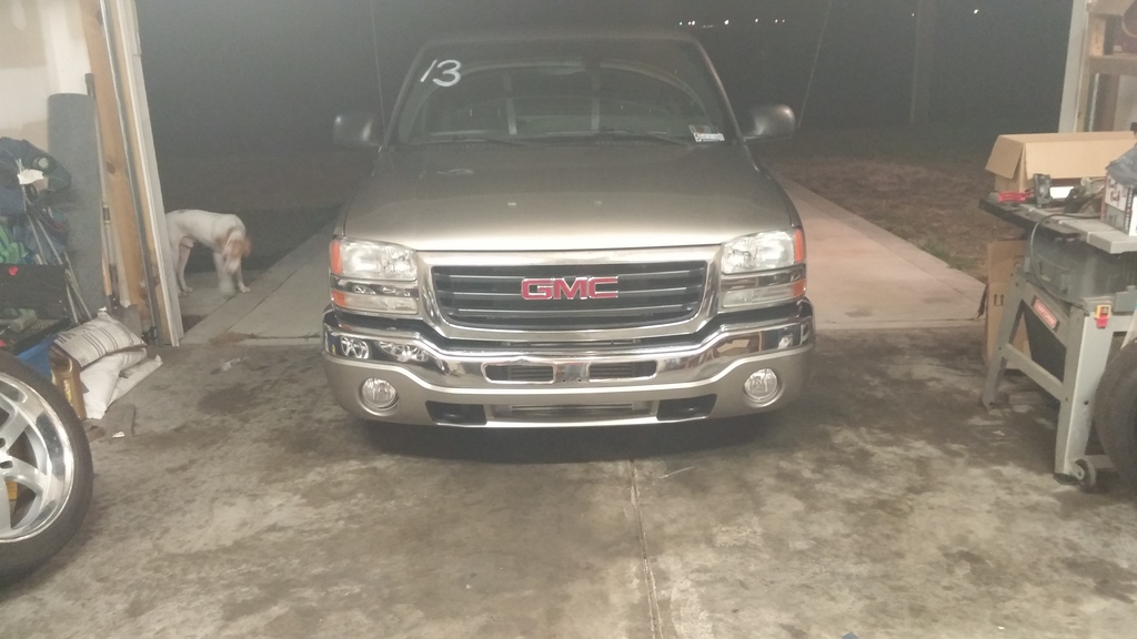

Got some progress to report. Installed a color matched lower valence with fog lights, which I still need to wire up. Looks a lot better in my opinion. I also have my door handles color matched but they need to dry for a while before I install them.

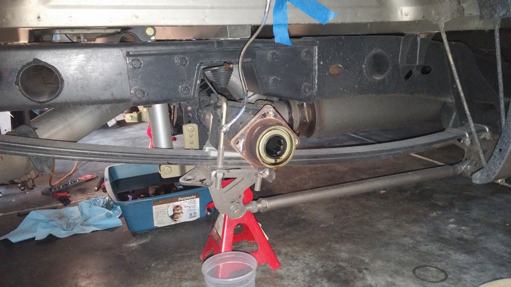

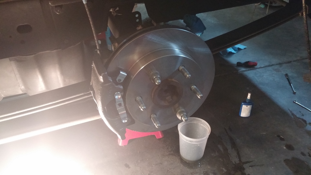

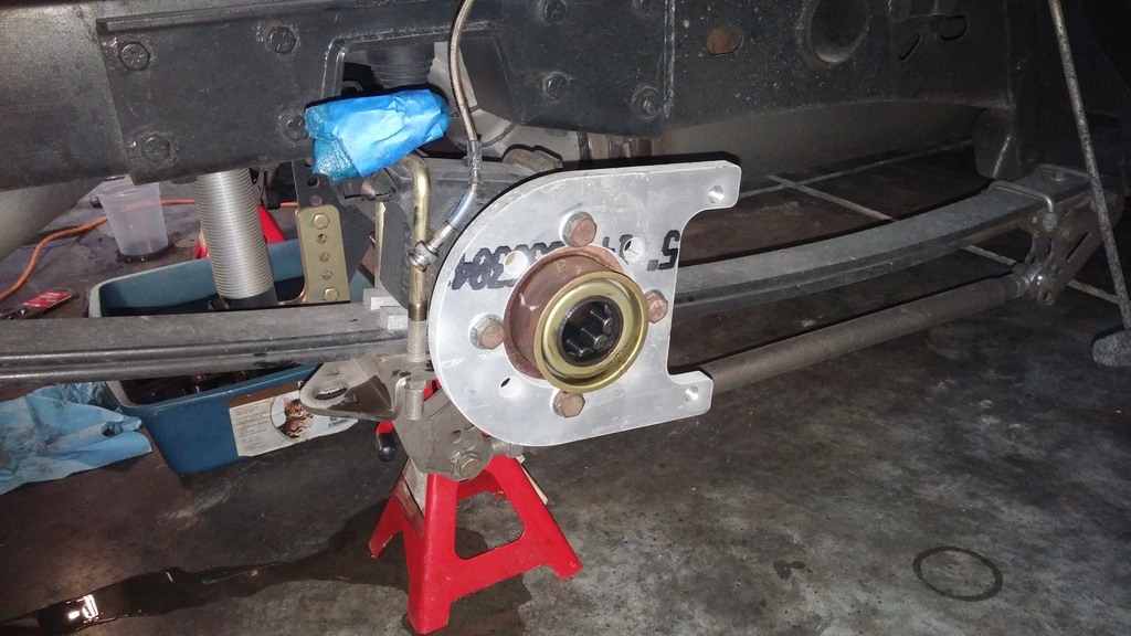

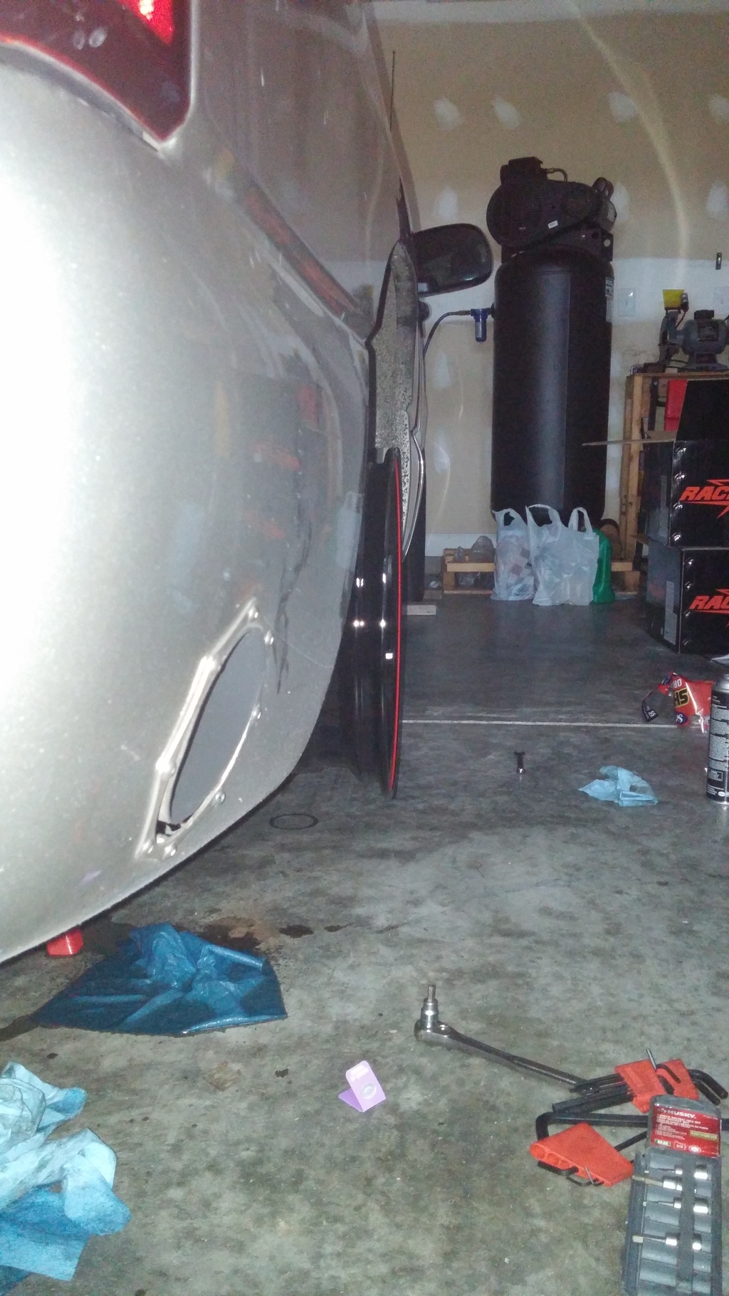

I also did the Oakley brake conversion today so that I can run my 15x10 Racestars.

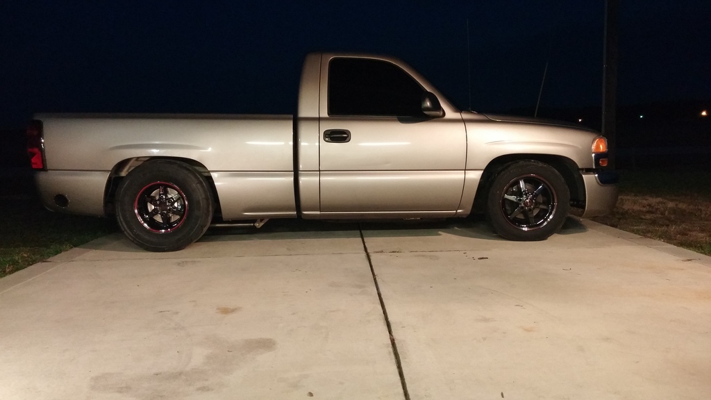

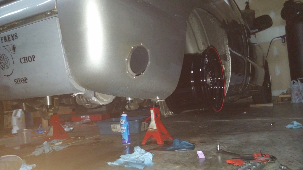

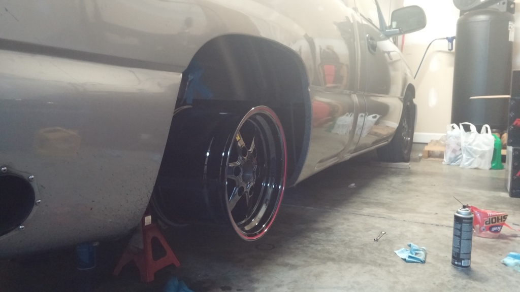

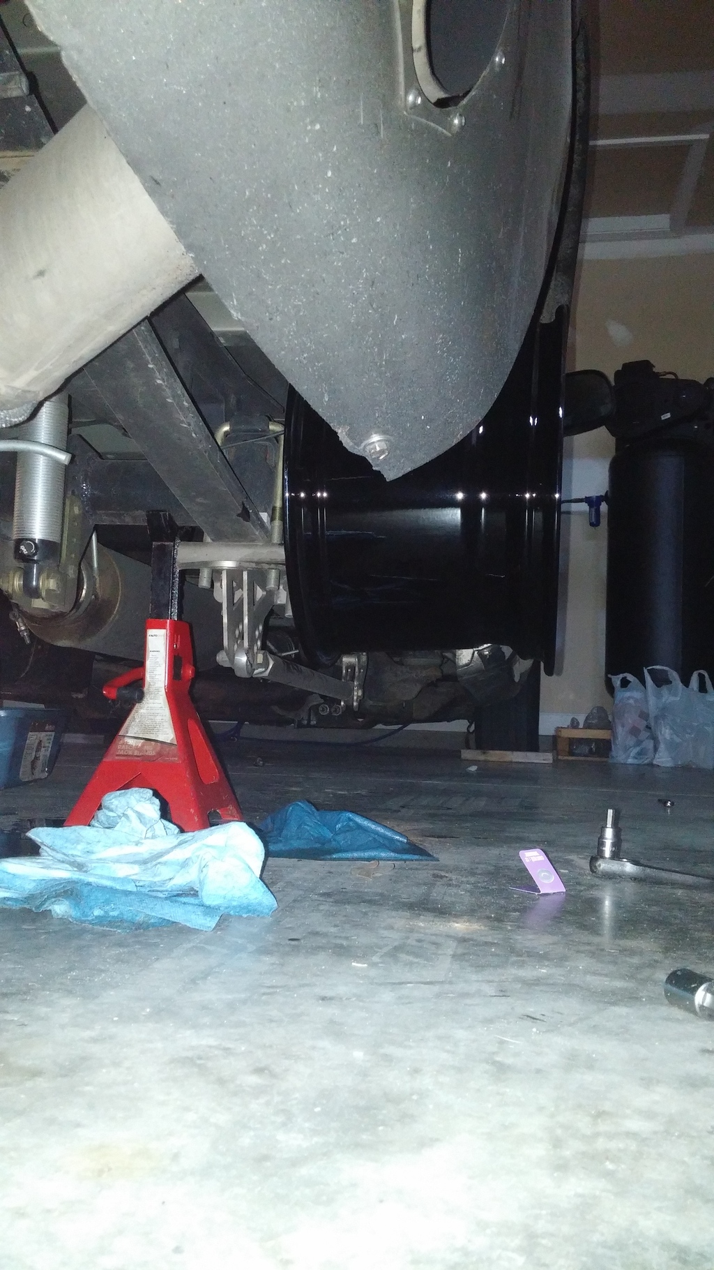

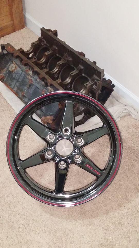

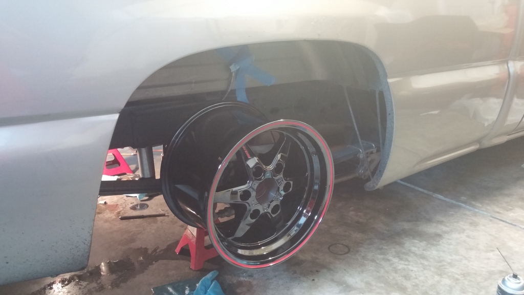

And some pictures of the rims and their fitment. My 315/60r15 ET Streets should be arriving Monday. I really cant wait to see what it looks like. I'll need to do some fender flaring too in order to run those tires I'm pretty sure.

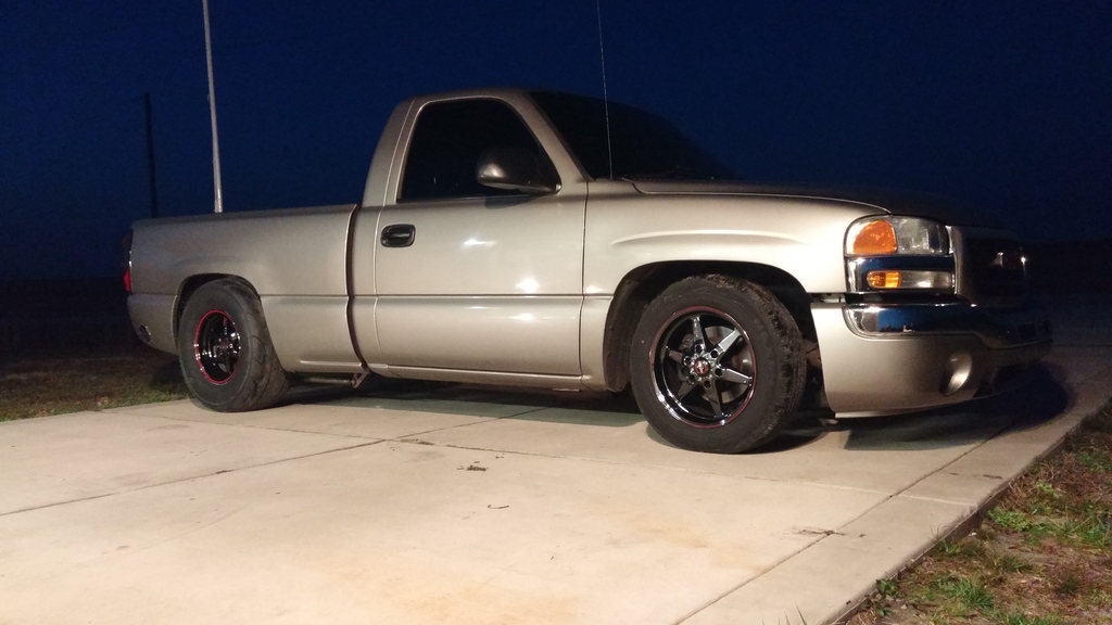

Not the best pics, but still looks pretty good!! The tint looks great, as do the wheels and tires. I think its safe to say that I'll be detailing the entire truck this weekend in an attempt to measure up to the bad *** wheels and tire combo!
