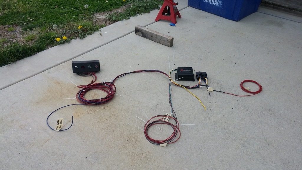

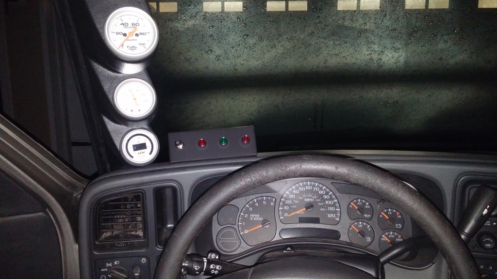

I made a whole wiring harness for the meth pump and a dash top control panel. I did not want to spray meth while I'm staged on the line, so when the 2 step toggle switch is activated and my foot is on the brake no power is going to the meth control module. The left most red light shows when the control module is deactivated, the green light shows when the meth is spraying, and the right most red light indicates when the meth level in the tank is low.
Lesson Learned: Cutting power to the meth control module when the 2 step is activated and engaged is not the option - the amount of time it takes when launching off the 2 step between when I lift my foot off the brake and the time the meth actually starts spraying is too long for comfort. I will rewire the harness so that the meth control module remains powered when the 2 step is activated but power to the meth PUMP is interrupted via a relay when on the 2 step. If I had thought it through, I should've done that in the first place. So, ill let yall know how that works - I anticipate much better results.
