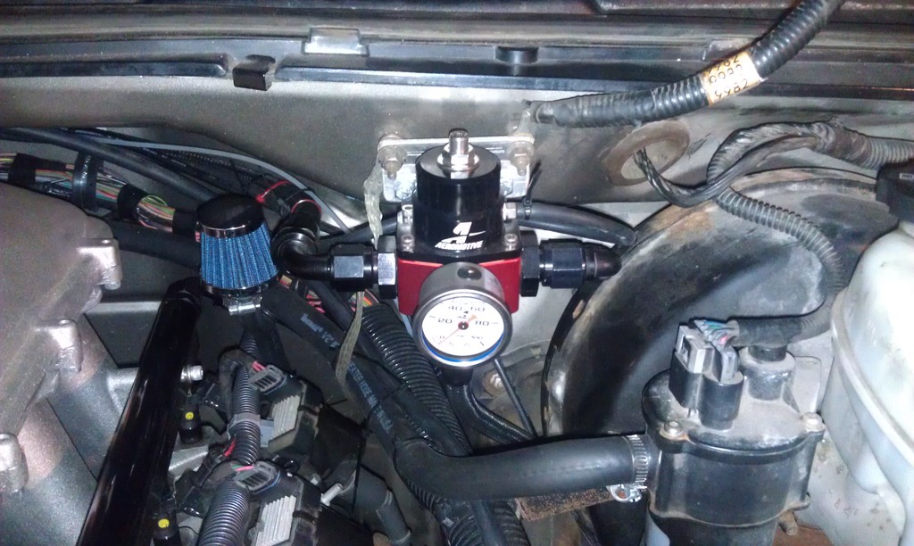

I really like that mounting bracket that you made for the Aeromotive regulator. I'd like to get something similar for my install.

Thanks GMC. Not too much to it, just 4 holes drilled in an aluminum plate, and bent horizontally lengthwise so that the regulator is straight up and down. The top holes bolt on to the 2 ground posts on the firewall, not sure if that's a good idea or bad now that I think about it.

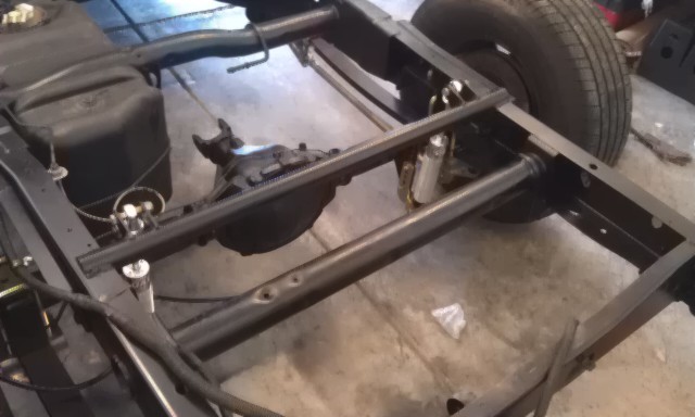

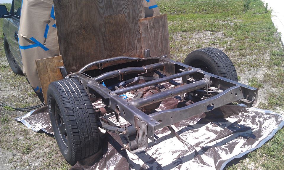

So progress on the truck has been slow due to work. It was so hot here in NC that I got cold feet about tuning the truck, so I tore it apart again. Figured I'd work on it all summer in preparation for a 16psi or so pass this fall. I started with stripping the rear half of the frame and prepping it for paint

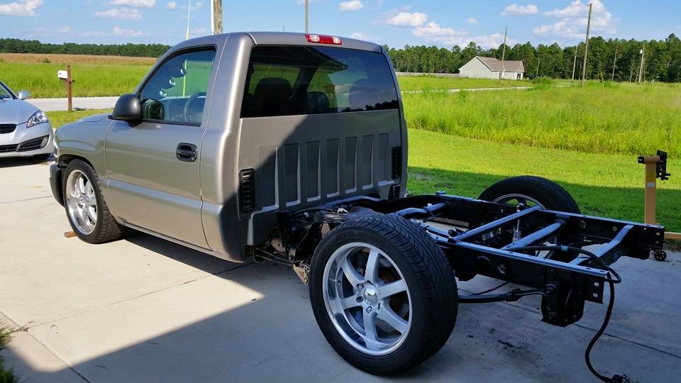

I used a 3 part East Woods Chassis restorer. Started with 2 coats of rust converter, then 2 coats of rust sealant, and finished it off with gloss black. I think it turned out pretty good.

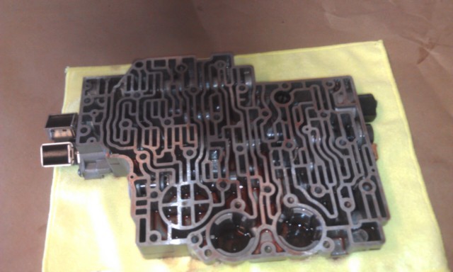

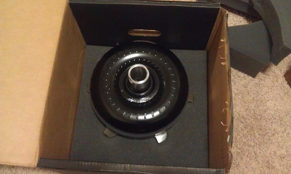

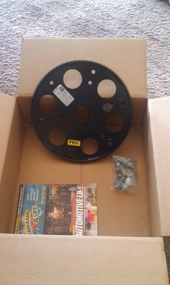

I also dropped the transmission to prep for the 4l80e. I ordered a Circle D 3600 Triple Disc which should get here Monday, a frost 4l80e wiring harness, and got a new TCI Flexplate from summit.

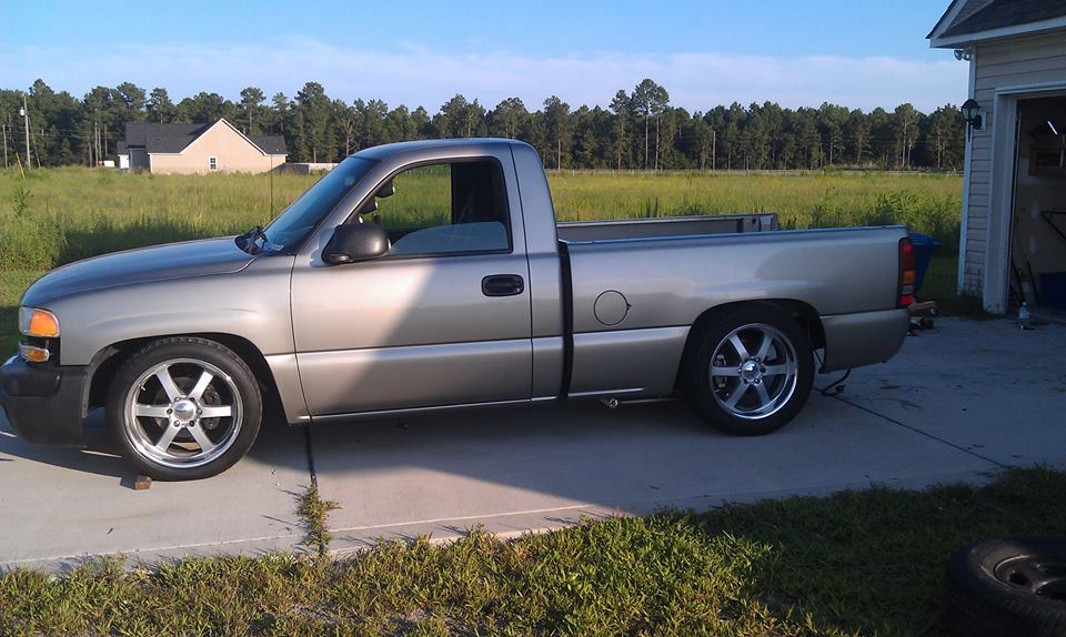

I also removed what was left of my overload leaf spring. I've got to bolt the rear end back together, verify pinion angle since I think that was causing my traction issues off the line, and order some shims. I also got some tires put on my Boss 330 rims for the street, but we put them on fastjwebs truck since I wont need them for a while. 20x8.5 rims, front: 255/45R20 and rear: 295/45r20. Can't wait to see what they look like on my truck.

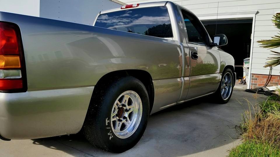

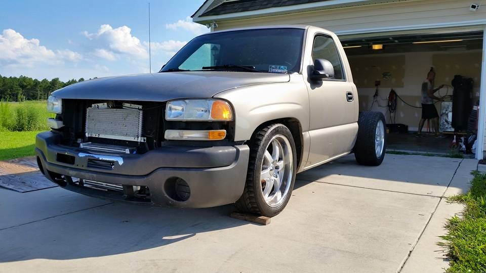

Sorry guys, its been a while. The 4L80e and circle D 3600 triple disc are in! Currently finishing up the Transgo Shift kit. I also got the rear end put back together. Now I'm waiting on my yoke to get here from Jakes performance and then ill be able to measure for a new driveshaft. Hoping to have this thing back on the road and on 8lbs by the end of the month. FastJWeb came down yesterday and helped out a lot. He also brought down my wheels and I think they look pretty good on the truck. Just a little better than rusty black stockers!

Truck is coming together nice! Is that a 258mm converter like we were talking about?
Old Aug 16, 2015 | 04:11 PM
  #137
lycominghunter's Avatar
Joined: Sep 2012
Posts: 500
From: Richlands, NC
Yes Sir, 258mm 3600 triple disc
