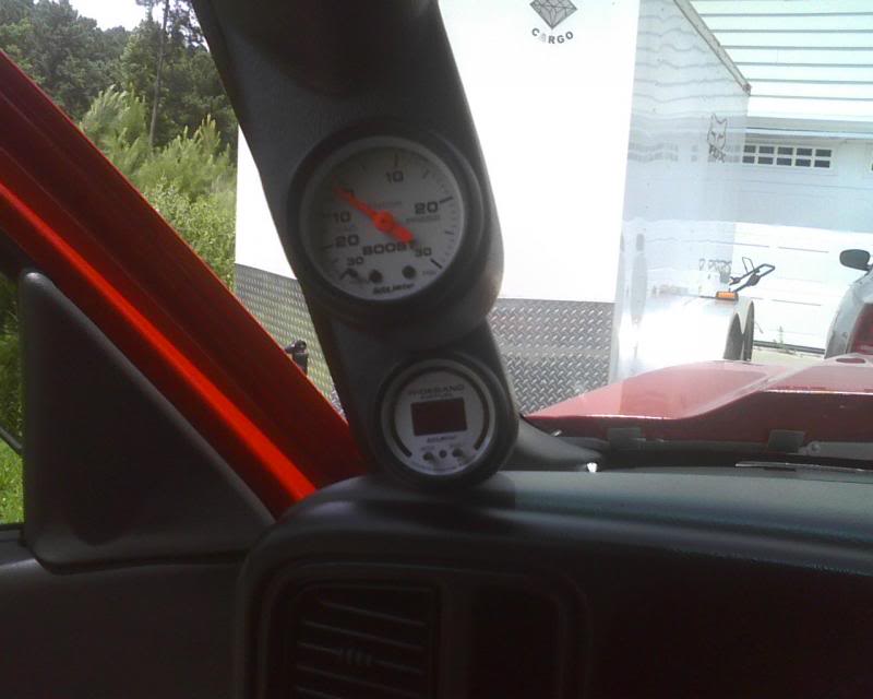

A little progress while waiting on the turbo kit. I got my autometer boost and afr gauge pre-plumbed and installed. I also installed white face gauges to match. I ordered trans cooler, braided lines and AN fittings to bypass the radiator. Ordered the right fittings for the 80E, longer one in the rear. I ordered a transgo shift kit, some heat wrap, some heat tape, misc hardware. I got my turbo 400 short yoke for the drive shaft, and got the trans crossmember finished up. I will be ordering cam, springs, push rods this week. i think im going to go with the Aermotive 340, and 60lbs for now. This should be alrite for my set up at 10-12 lbs for now.

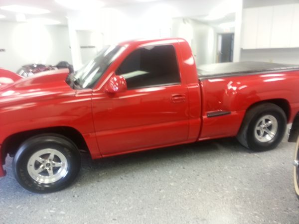

And heres a pic of the truck that gives me some inspiration, have not seen it on this forum, but came across it in a auction sale ad, didnt last long on there, but did get a quick pic.

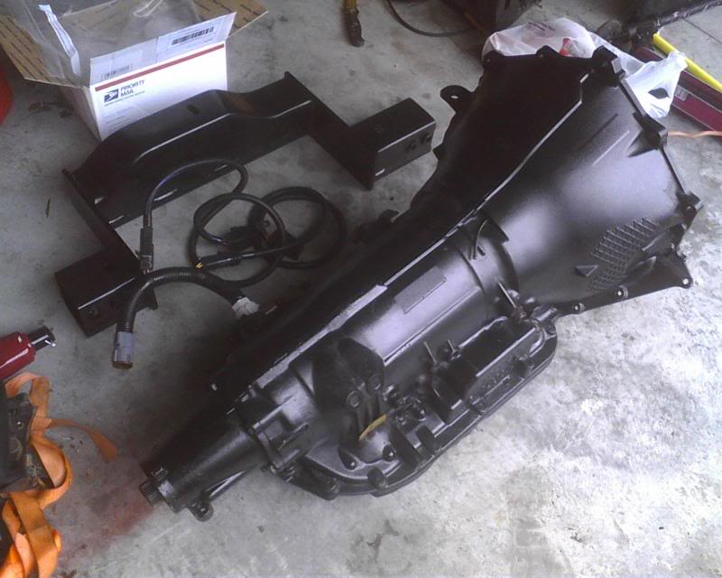

trans all cleaned up, now I wait.
