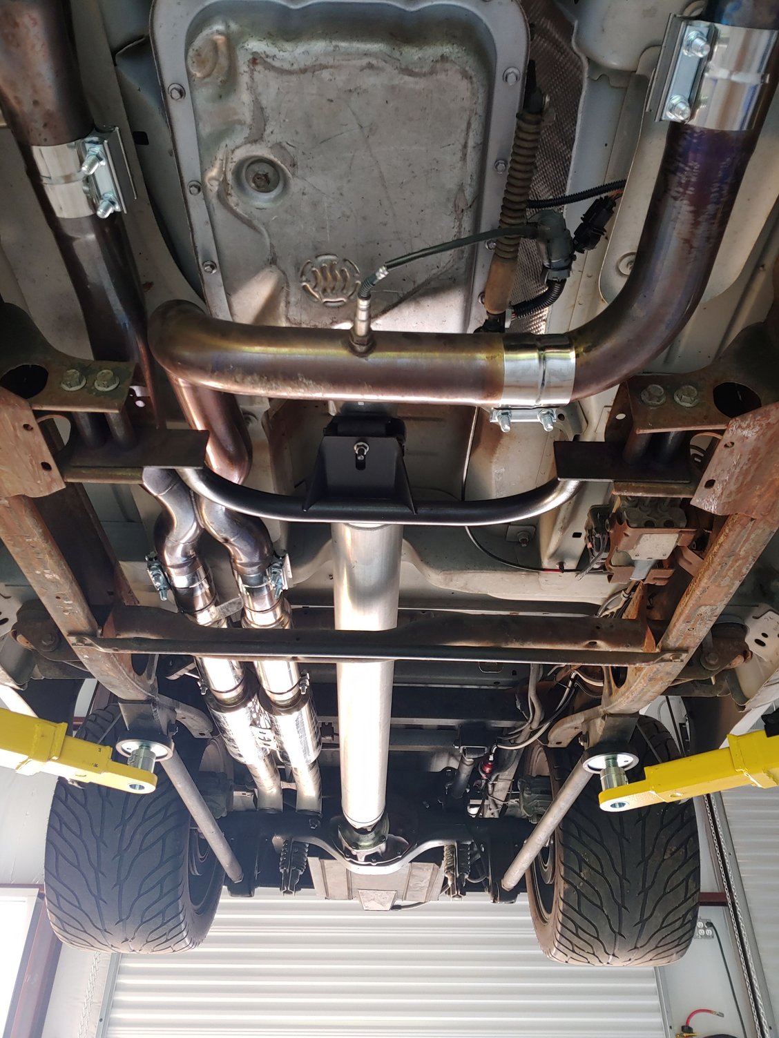

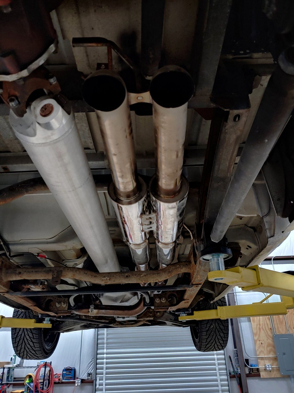

New clamps and resonators in
Clamp upgrade fixed my trims at idle and my WB readings under 1500rpm. So that alone was worth the work. People a right when they recommend upgrading Speed Engineering clamps.
Idle and low rpm tune likely need massgaed a bit, be pretty quick this weekend.
Exhaust quieted just enough at idle and love the new tone. Have to take on highway to see drone. TBD. Not bad for $100 investment

that looks sooo good underneath

what pipes you running from the headers to the mufflers? do the pipes hang down lower then the frame?
your exhaust is what im looking to do to my truck have kooks and there y pipe but want true dual exhaust
