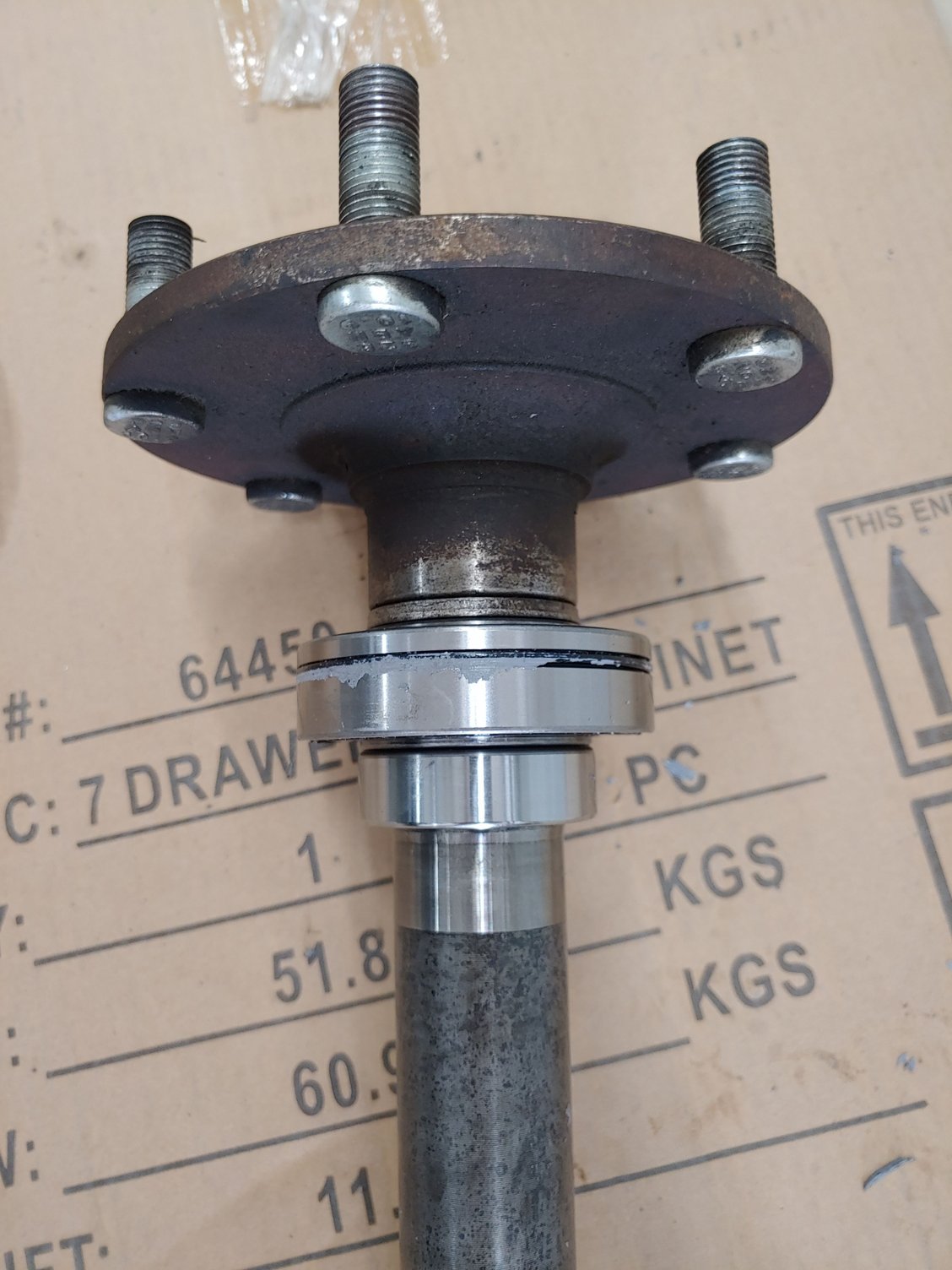

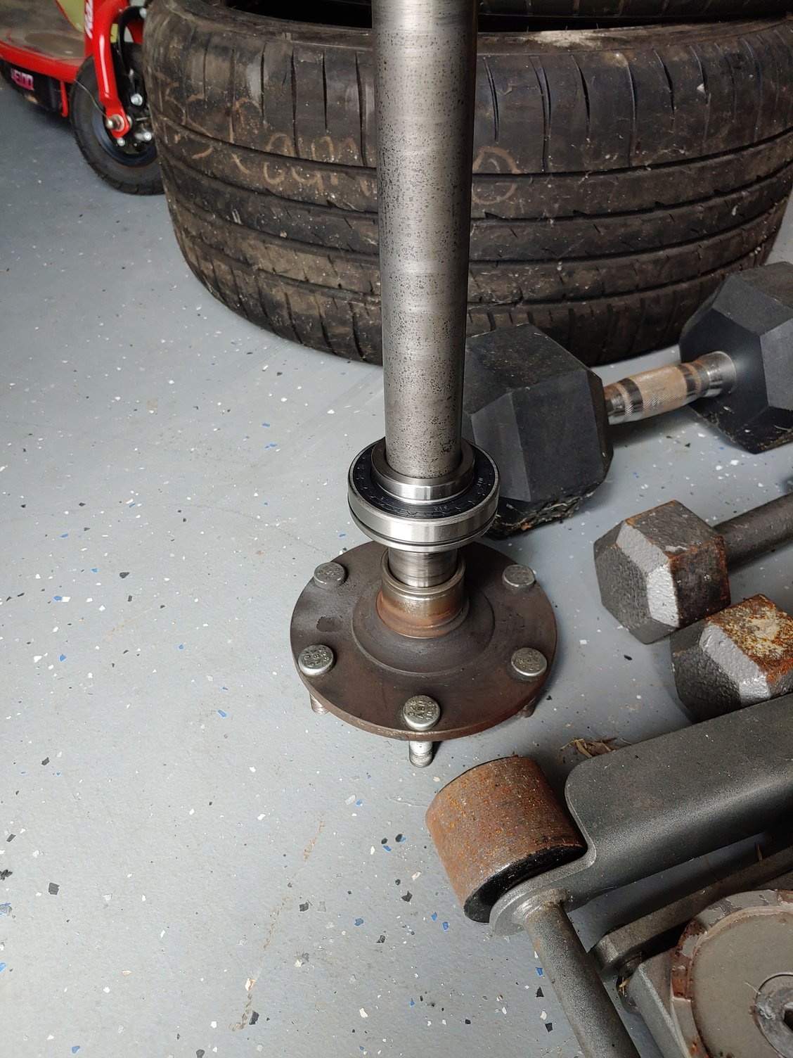

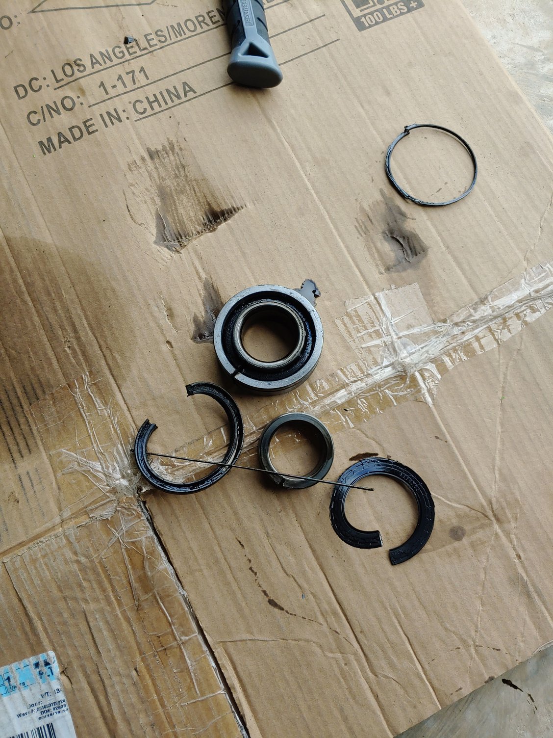

Decided to tackle the last remaining issue on truck. Drivers axle seal has been leaking for awhile. Just enough to **** me off. Decided to get new spacer and retention plates as well. About to go borrow a press in awhile to press the new seal on the axle. What a pita to grind off without hitting the axle....
Old. Tried sealing it once, but it was the bearings themselves leaking.
Ready for press

Wrapped it up and zero leak now. First time in 5 years I can say the truck is "done"... For now.
