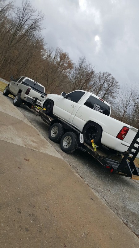

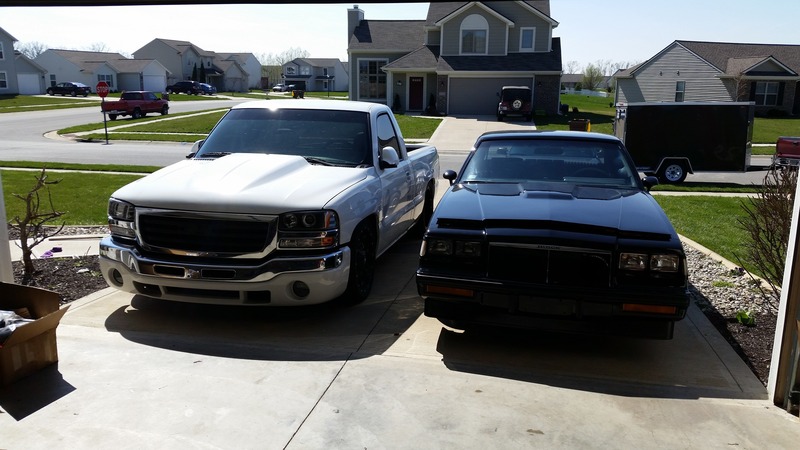

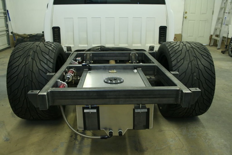

Couple pics for now:

I recall seeing this truck on here before and was interested in the backhalf/suspension. Here are the original build threads over on protourning... 2003 gmc sbrc - ratoutahell and CGM... http://customgm.com/index.php?thread...uta-hell.2006/

Thanks BigKID, I refer to those when I need to recall a few details that slip my mind.
I agree on the tires. I actually need to order a new set for the rear now, and debated going to the 17's as well. The hostage wheels arent too pricey, just trying to get the truck back on the road before I decide.
