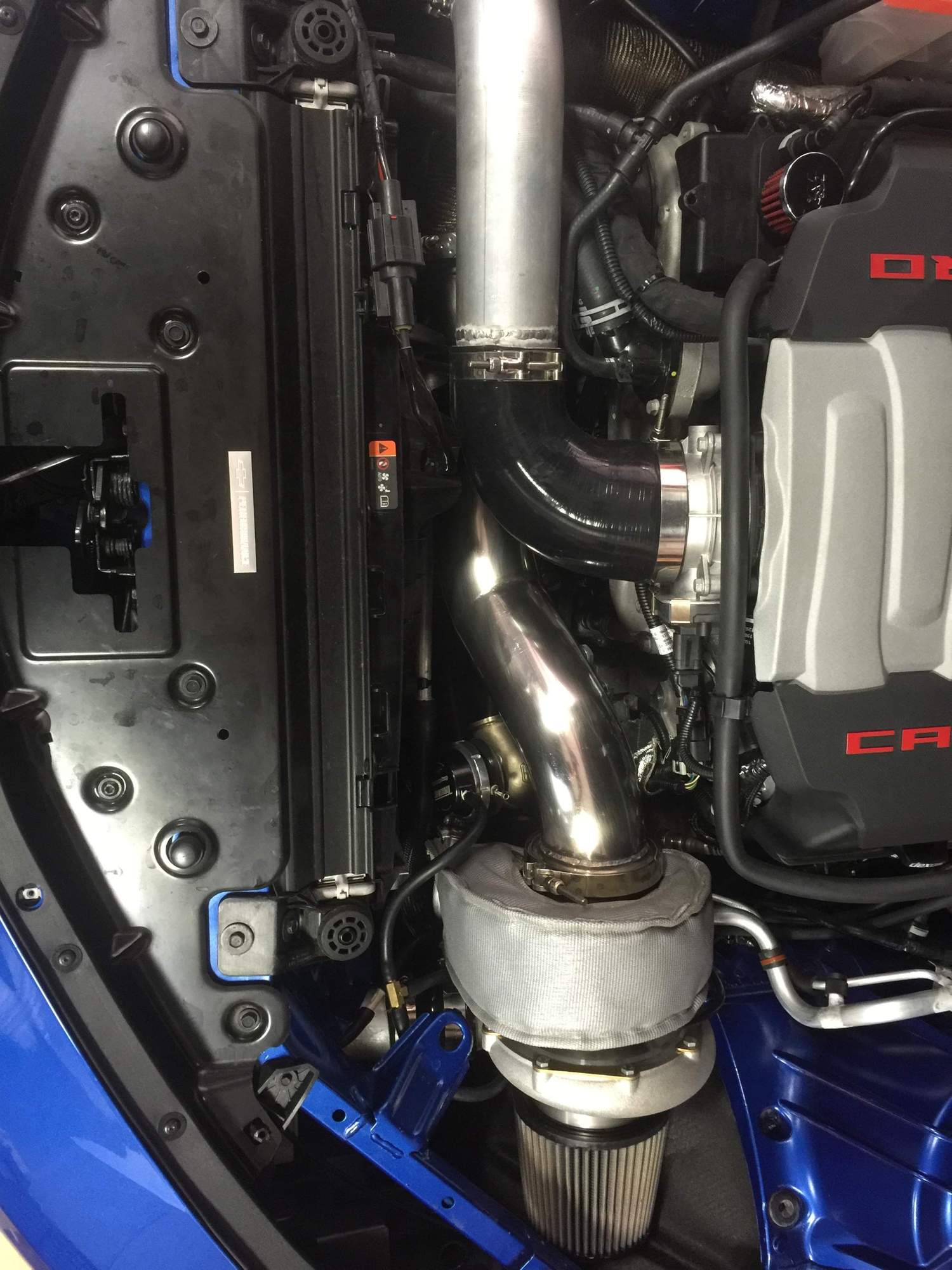

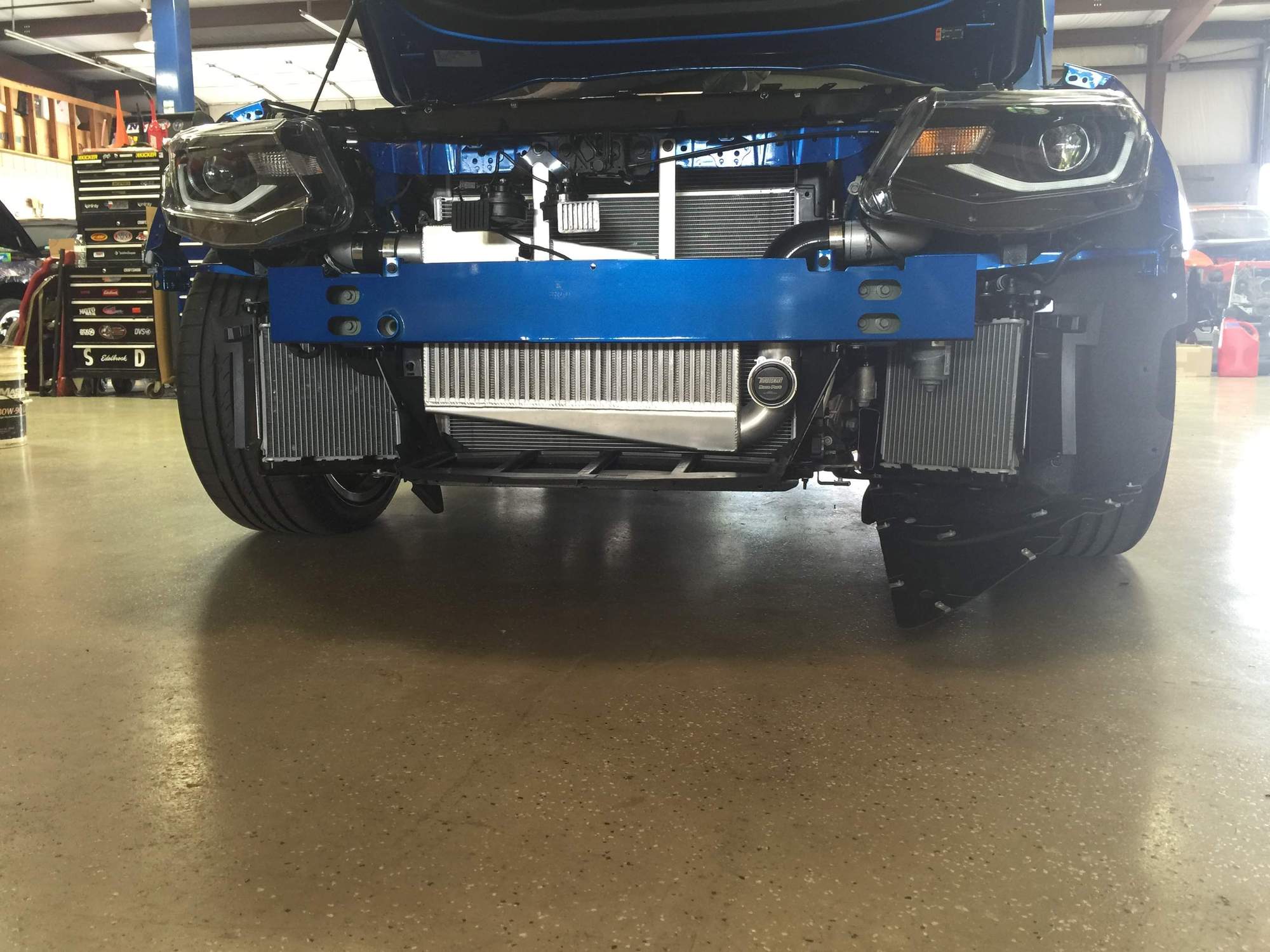

As I was trying to decide how to attached this PS pulley situation, I ran across a deal...
7675 CEA Precision snail
Turbosmart gate to atmosphere
Custom Bell IC
Have new PS pump in shop to swap out and hopefully finish the truck. Likely to update tune and leave it be for awhile while I work on the above.

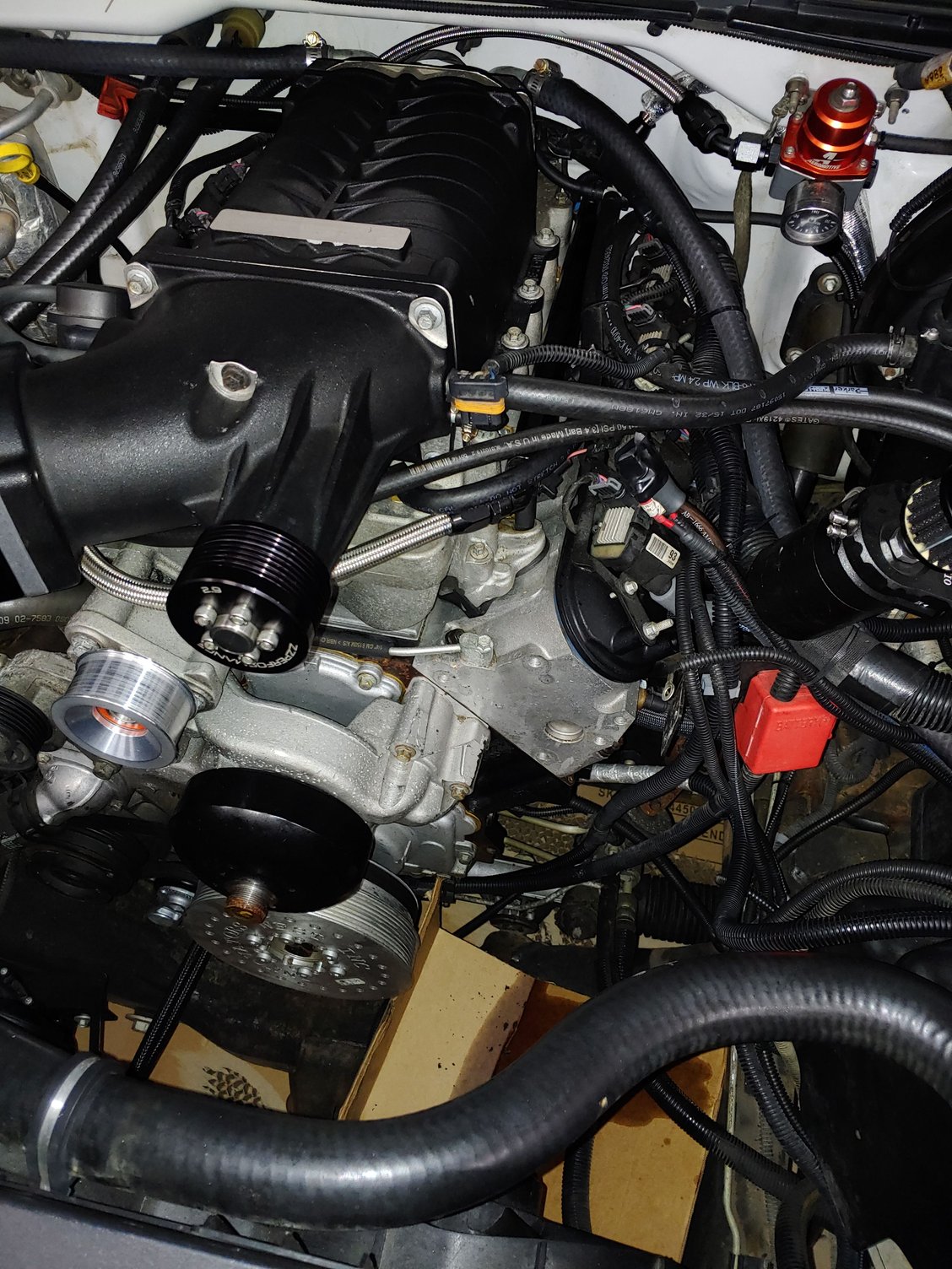

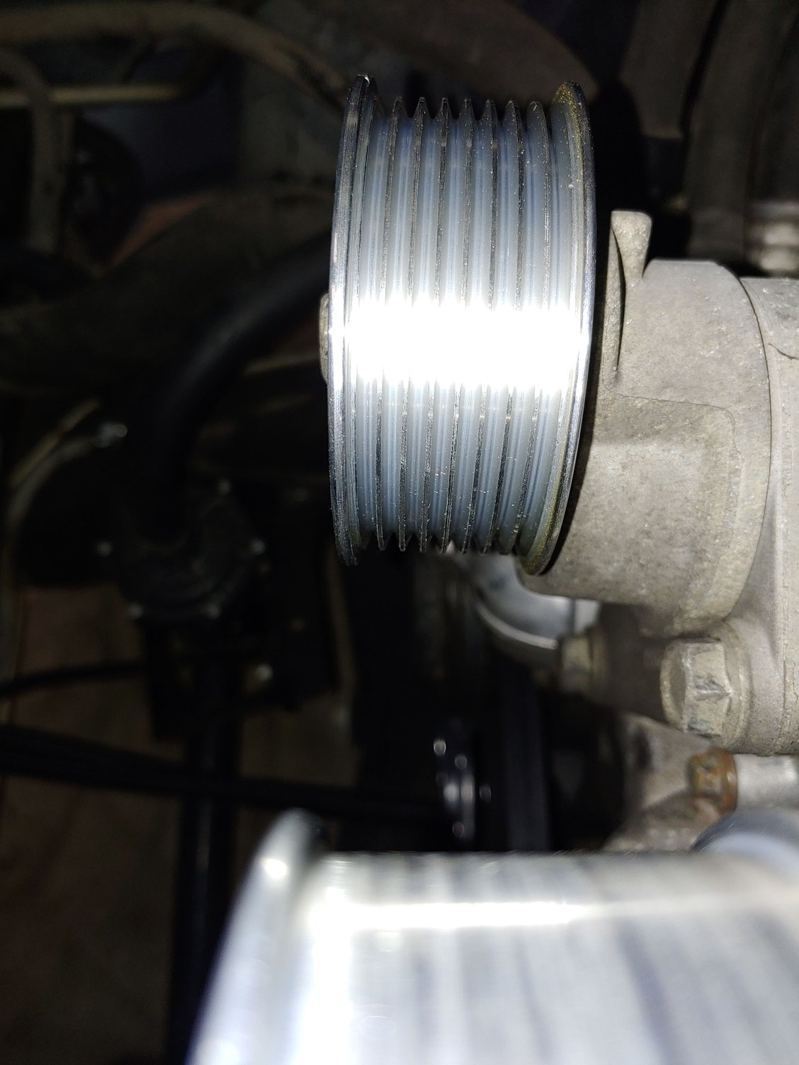

While I have pump off, decided to take accessory bracket off and clean up a bit. Might rattle can it, or possibly powder coat, haven't decided.
IW 973 tensioner pulley doesn't fit stock truck tensioner, it hits the back on tensioner. Anyone with IW 8 rib have this issue? I have the LC32 sitting on shelf, but wanted to try the IW first since I already paid for it...
Just need to get hub off old PS pump and onto new, then I'll button up.

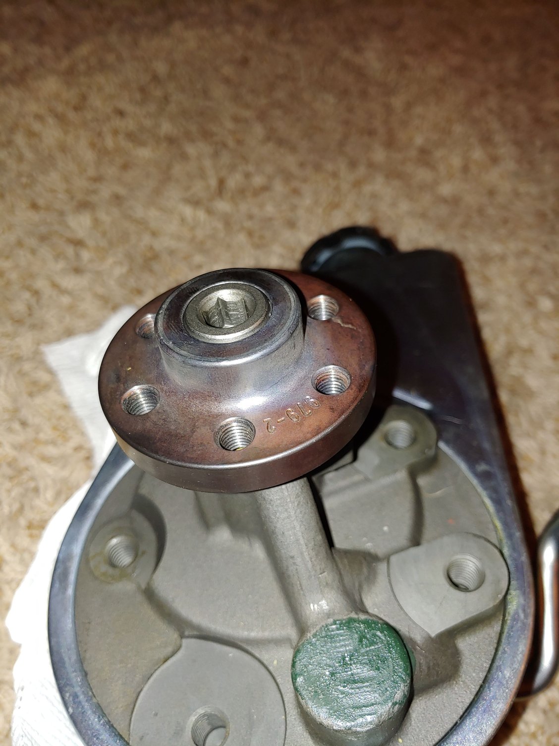

Put pump in the fridge for a few hours and hub in air fryer for 20 min on 300*. Hub went on without a hitch.
Moral of story, buy a got install tool instead of using rental...
Will get pump and bracket installed tomorrow and bleed system Thursday after I install LC32 HD tensioner. Still need to find correct 8 rib belt as well.
Hub seated on new pump
