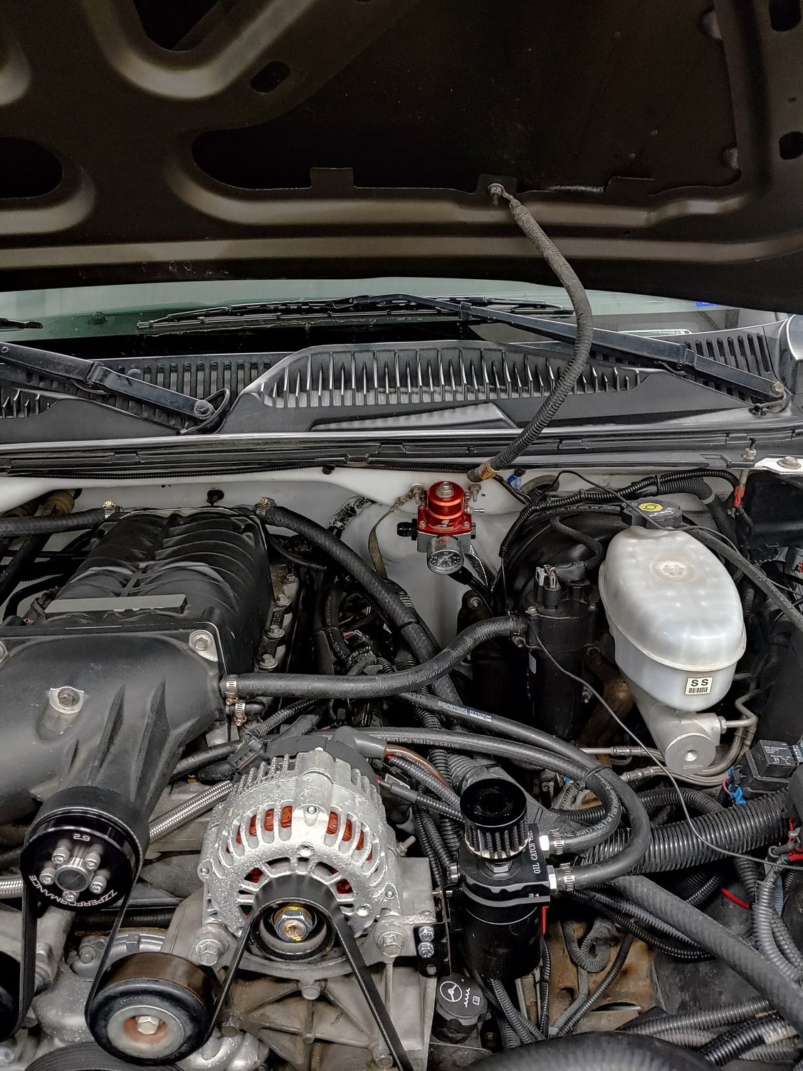

Got FPR relocated and new return setup ironed out. Took for drive, about to rip blower off now.

As I started putting my 8 rib IW pulleys on, I do have sight evidence there may be some minimal belt slip. Logs don't show any, but some black powder here and there. Going to finish the 8 rib and run it before I pull blower to see if there is a change.
Also, got PS pulley 90% on and the threads on shaft stripped... Haven't figured out my next move yet
1/8" from complete. Slightly pissed

Ordered a Leftcoast HD tensioner while I wait and try to figure this PS pulley out. Forgot about the extra idler pulley on Roush kit too, so going to swap the IW tensioner pulley for another idler from them to complete the 8rib.
Really don't want to replace the entire PS pump, but think I might have to.
